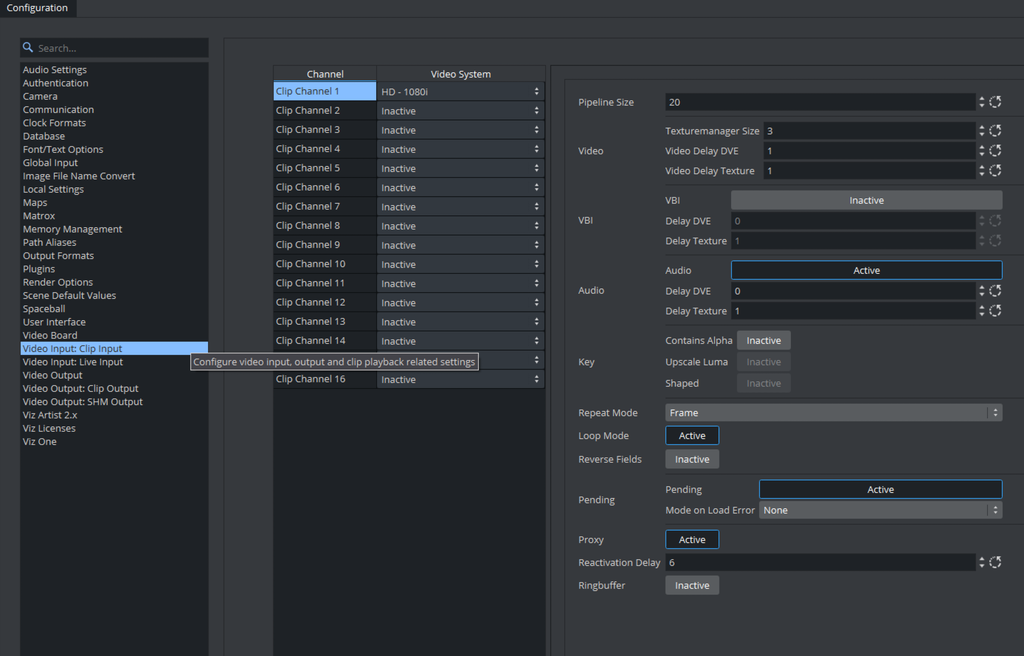

The selected video clip must have the same frame rate as the clip channel. You can mix different Output Formats and Video Input Formats with different resolutions, but you must make sure to use either progressive or interlaced for Input and Output. You can play, for example, a 720p clip with an Output format of 1080p, but you cannot mix and 720p with a 1080i format:
Video Input: Clip Channel 1: HD 1080i
Output Format: 1080i
Each available Clip Channel can be configured for independent resolutions, providing the designer quick access to a range of options. These settings are configured in the Video Input section in Viz Config. Please refer to the Video Input page in the Configuring Viz section of the Viz Engine Administrator Guide.

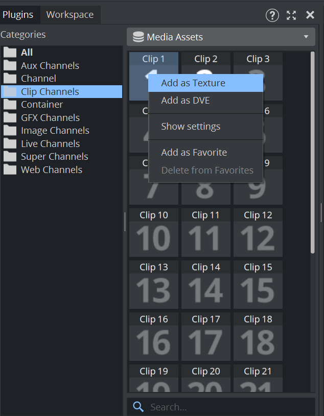

To Play a Video Clip as Clipchannel (Texture)

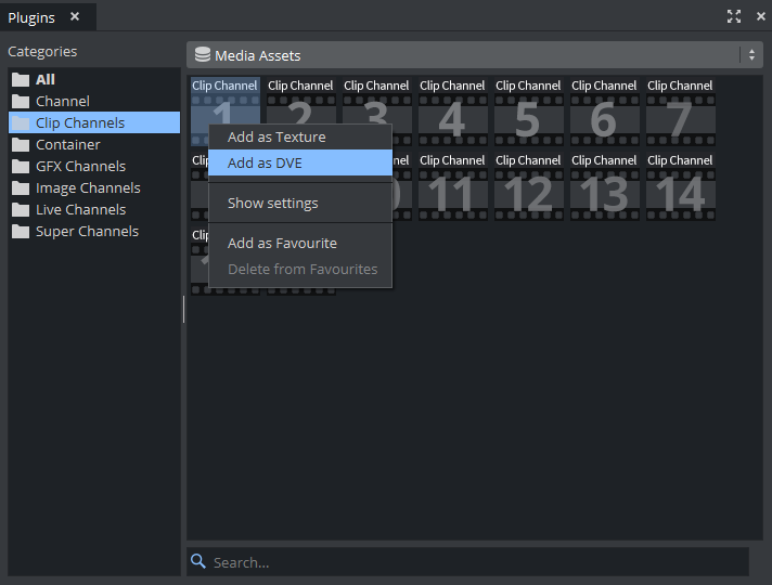

Click on Plugins / Media Assets / Clip Channels.
Drag one of the available Clip channels to the scene tree or Right-click on a Clip Channel, and select Add Clip<1> as Texture.
The Texture button in the Media Asset Manage) is automatically selected.
The selected Clip Channel is added to the Scene Tree and a new Container is created (click Tree to view).
Tip: The Clip<1> Channel can be made active or inactive. Toggle the active/inactive button.

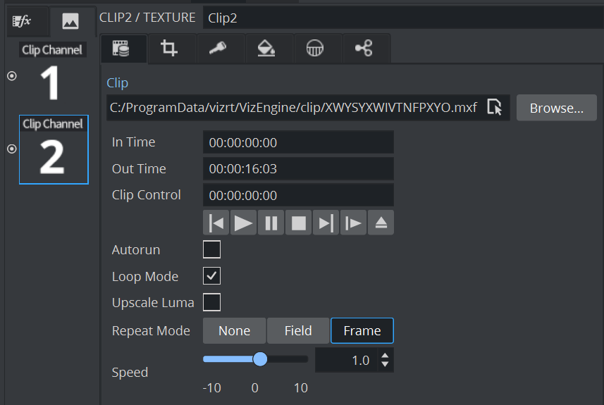

Click on Clip<1> Channel, in the Scene Tree panel (Media Asset Manager) Texture view, to open its properties panel.
Select the required Keying Mode (see Keying Mode).

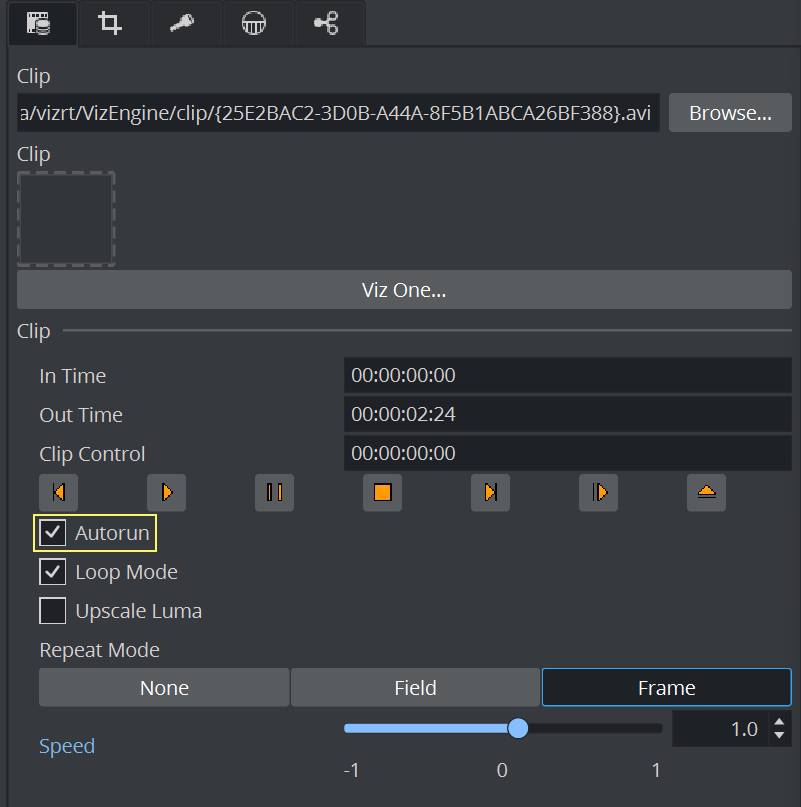

Add a video clip:
Drag a clip from Windows Explorer or from Viz One browser
Click Browse..., and select a video clip to import
Configure the video clip playback as required.
Click Play to test the video clip.

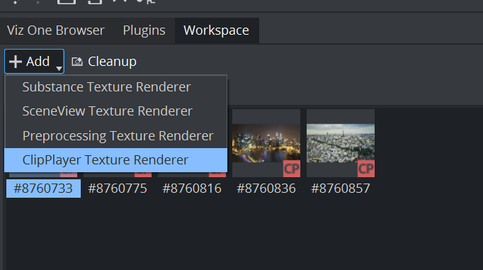

To Play a Video Clip as Texture ClipPlayer
Container-based Clip Playback is mainly used for decoration clips, promos or if the clip dimensions are non broadcast formats. The texture clip player is based on the VML player and supports various formats as well as transparency.
Note: This feature is only available in the Viz Engine Render Pipeline.

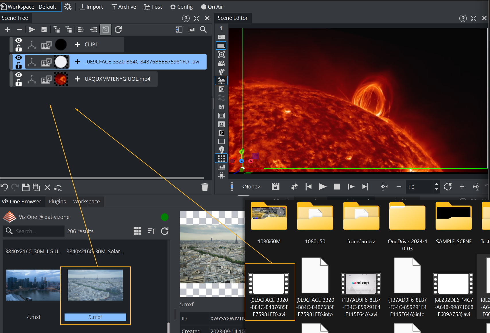

When using the new Viz One browser or if you drag any clip from the filesystem inside the scene editor or scene tree, the ClipPlayer Texture Renderer is used automatically.
Drag a clip from Viz One browser or filesystem
or create it manually:
Open the Workspace Dock.
Click on Texture Renderer.
Add > ClipPlayer Texture Renderer.
Double Click on the new generated Texture ClipPlayer.
Browse or assign a clip file.
Drag the texture to a container.

Click on Built Ins.
Click on Media Assets (MA).
Right-click on the required Clip Channel.

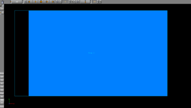

Select Add Clip<1> as DVE.
The DVE button in the Scene Tree panel (Media Asset Manager) is automatically selected.
The Scene Editor shows a blue rectangle, which shows that the live input channel is correctly configured for live video.

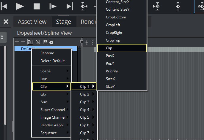

Click Stage.
Click the New Director button.
Right-click on the Director.
Select Clip > Clip1 > Clip

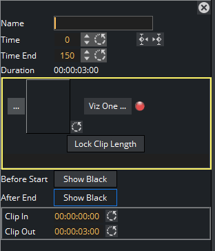

In the Clip1 channel, click in the dark blue area. The Clip Key Frame Editor opens on the far right.
Add a video clip:
To load a clip,
Click to browse for a local clip, or drag a Video Clip item from the Asset View.
Click Viz One..., and select a video clip to import.
Click Lock Clip Length to specify a certain time/length for your clip. This is useful when loading clips from an external control application via Viz One. In this case, the lock clip length acts as a placeholder, but does not change the clip length automatically after loading.
Configure the Clip Key Frame Editor as required.
