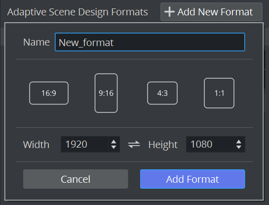

To add a new format, select Scene and click on the Formats () icon.
The default format is already listed and can not be deleted. To add a new format, click on the button:
Give your format a unique name. Viz Artist versions 5.0 and newer come with presets for the most common aspect ratios. This feature will be extended in future versions to serve more presets and let the user create own profiles. The Width and Height values are taken automatically from the output system, but can be changed to any other values or switched by clicking on the desired button. The most important factor is the aspect ratio, that is calculated automatically internally and used afterwards by all required plug-ins like the Flexbox plug-in.

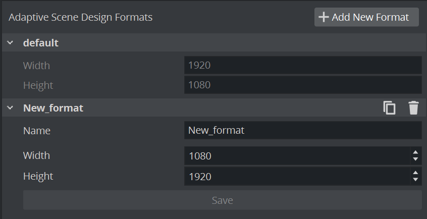

Once set, click on the Add Format button. Your new format is now listed as available. The values are inherited from the default format.
Any format name, width or height can be changed afterwards. Change the property and press the Save button. Each format can also be cloned or deleted afterwards. Once your scene has an additional format defined, it can be used to create and preview your adaptive graphics.
: Clones an existing format.
: Deletes an existing format.
The default format cannot be changed.

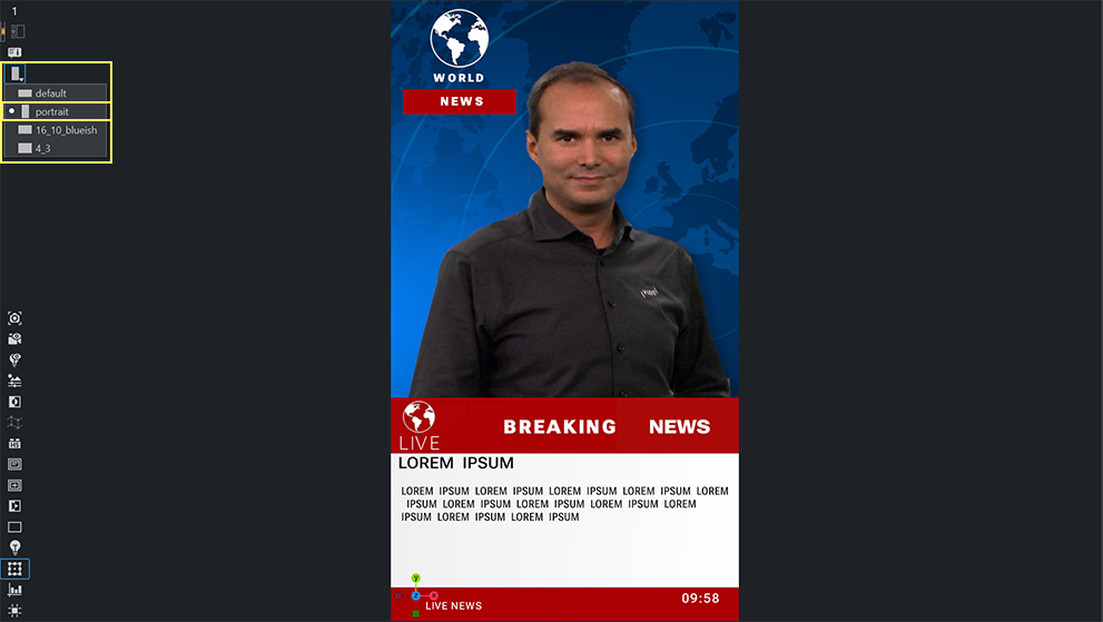

To Preview Formats
All formats within a scene can be switched in the scene editor. Click on the small format editor next to the scene editor to switch the active format:
Format | Sample |
Default | |
Portrait |
Once a different format has been chosen, the scene editor changes its size and display the scene with this new format applied. The stage also shows all animated properties for this format. The chosen format in the scene editor is the active working format, any parameter changed is tied to this format. This also affects animations.

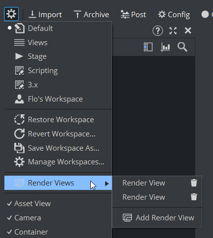

Working with Multiple Previews

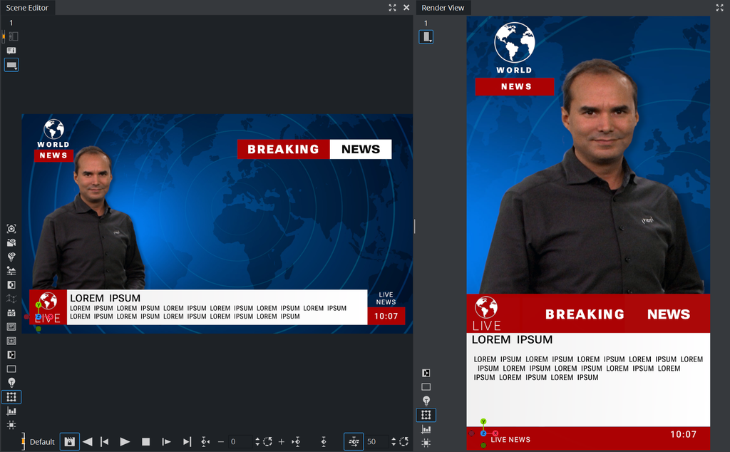

To see the effect of your changes while working on the format within the scene editor, additional preview windows can be opened. To do this, choose Render Views > Add Render View.
This adds a new render view. To launch it, click on it and you'll get a new floating window hosting a preview editor. This window can be also docked:
If the preview windows are not used anymore, delete them by using the small trash bin icon.

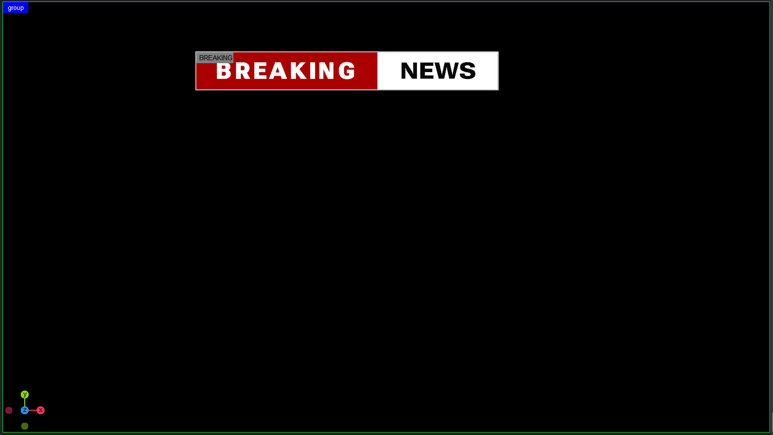

A basic scene, with a rectangle and material and some text on it:
Looks like this in the default format:

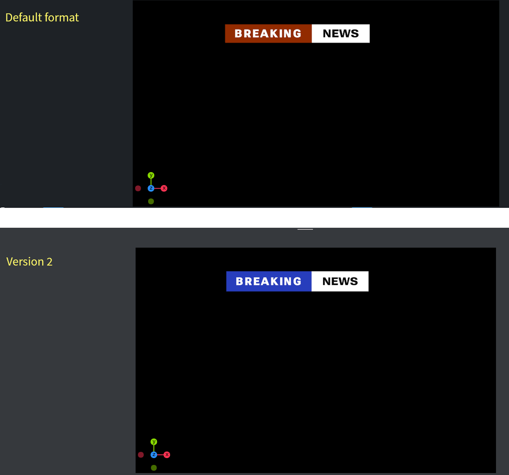

Now create a new format and call it Version 2 by either cloning the default format or create a new one. The dimensions can be different, but this is not required.
Switch to the Version 2 format. It still looks the same as the default one. Click on the red material we defined for the "Breaking" background and change it to any other color, open a preview window and have the default and version 2 side by side:

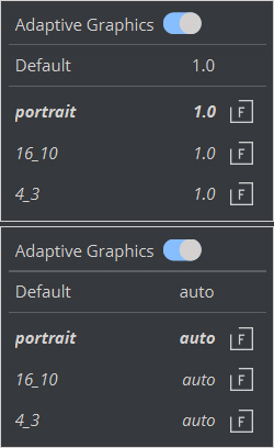

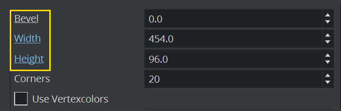

The same scene structure can look completely different in different formats. To get an overview of what is different in the various formats, an information panel is available. This is shown in the User Interface as underlined property:
This indicates that:
Bevel has different values in other formats.
Width and Height have different values in other formats, and do not have their default values.
In default format, a property label is shown as underlined if it differs from default in any other format. In other formats, a property label is shown as underlined only if it differs from default in the current format.

Right clicking on the label opens the information popup:
The following information is shown:
Format dependency can be turned on or off.
The default value is always shown and all other values are listed.
If the value is the same as the default, it is shown in italic.
To make a value independent from the default format, click the button. Clicking on the Reset button reverts the value back to the default value.
As the flexbox plug-in offers the possibility to change a value and also the mode for it, the popup menu has been extended to also support this:
The value in default format is 20%, whereas in Portrait mode it has a value of 857 pixels.

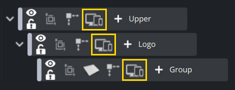

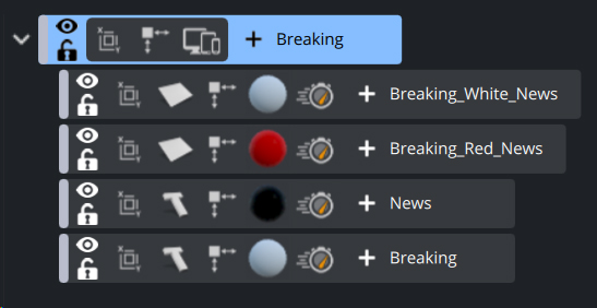

Containers with different properties for different formats are marked with an icon:

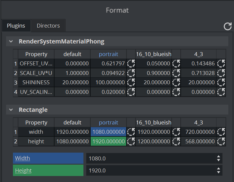

When clicking on the format icon , an overview of all format-dependent properties is shown:
The overview panel has two categories: Plugin Properties and Directors
Plugin Properties:
The Plugins panel lists all format dependent properties:
The following sample has 4 different formats and shows differences on the Phong Material and the Rectangle Geometry.
The current selected format is shown as blue (portrait) and the Rectangle geometry differs from the default format in width and height. They are marked in blue, green, red, … labels for better readability. To change e.g. the width on the rectangle geometry, simply change the value.
Editing inside the table is not supported
The reset buttons will reset the value to the default one.

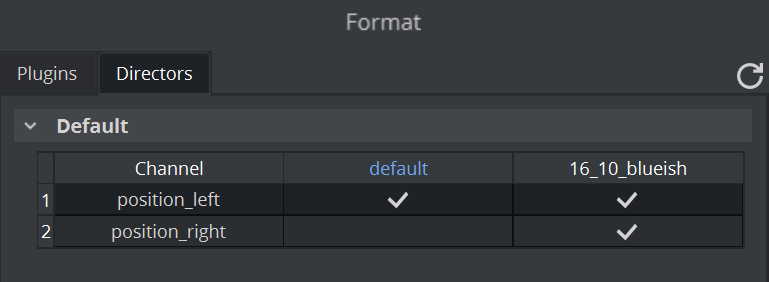

Director Properties:

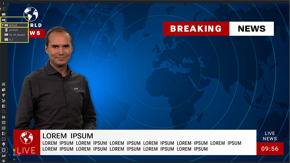

The director panel shows an overview of what properties are animated in different channels.
Format dependent animations are also marked inside the stage:
The position_left is animated in the “default” and in “16_10_blueish” format. the right position is only animated in the “16_10_blueish” format.
Due technical limitations this view is only available in the default format
