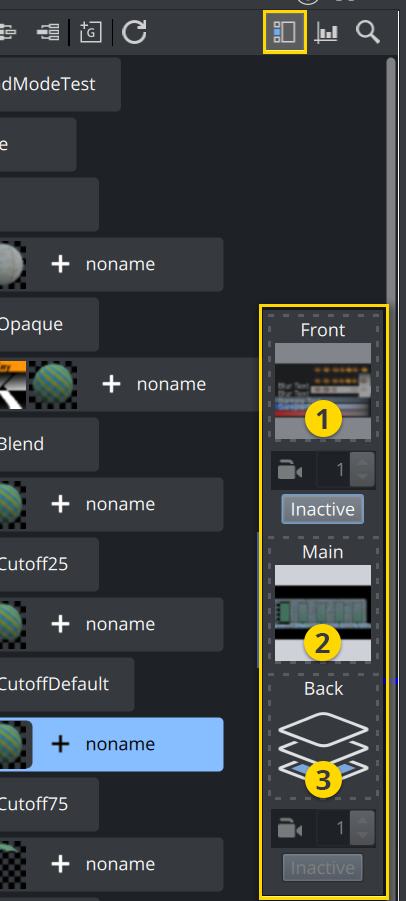

All scenes are designed to run in the Main layer (2) by default, but can be played out in the Front (1) and Back (3) layer as well. The Layer Manager can be used to test combinations of Scenes in the three layers.
A Scene set in the Main Layer can be edited in the Scene Tree and the Scene Editor panel. Scenes set in the Front or Back Layer can be edited by a double-click on the relevant Scene.

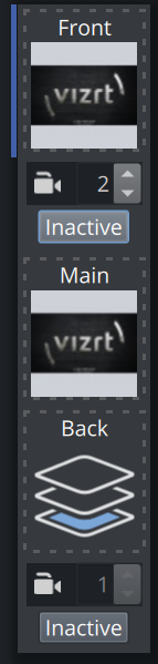

The Main Layer is accessible within the Scene Tree editor and indicates which layer is currently active: image-20240916-144721.png image-20240916-144726.png image-20240916-144729.png.
The current active layer is also indicated with a blue line next to the drop fields for the different layers.

To Add Scenes to the Front or Back Layer
Drag and drop scenes from the asset view onto the layer placeholder. To remove them, drop them to the trash bin. The visibility can be set by clicking ion the Active/Inactive button.

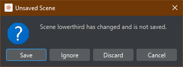

  2. If another Scene in one of the three layers was modified, select an option from the message which opens:
    • Save: Saves any changes made in the last selected Scene.
    • Ignore: Switches to the layer without saving the last selected Scene.
    • Discard: Discards any changes made in the previously selected Scene and reloads the Scene when switching layers.
    • Cancel: Cancels the operation.

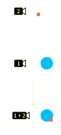

The same Scene can be set to the Front and Back layer, which creates what is known as self layer(s). This allows the Scenes to be linked, and the adjustment of the camera settings for the Front layer. When saving a Scene, any self layer settings are preserved. For example, some part of a scene should be rendered on top of the other parts. You can place your camera 2 in y.-position of 10.000 and put the part that should be rendered on top in view of this camera.
Camera 2 is placed in a height of y = 10.000 and rendering only the orange square
The Main Camera1 is located at height y = 0 and rendering the blue circle.
Loading the same scene again as self layered scene and having the front layer rendering camera 2, will results into a composition of Camera 1 and Camera 2 drawn on top of it.
