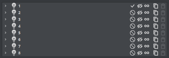

The Light Editor panel shows a list of all eight editable lights, and their current status.
Number: The number of each available light, from
1to8.State: Sets the light
OnorOff.Vis: Sets the visualization of a light
OnorOff(see Light Visualization):On: The visualization of a light can be seen in the Scene Editor (and the Scene Editor Views).
Off: The visualization of a light cannot be seen in the output window.
Type: The type of light used, which is selected in the Light Editor Right Panel.

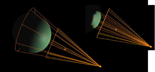

Local: Gives off light equally in all directions (color and position).
Spot: Gives off light in a bright inner cone and a larger outer cone (color, position, direction/rotation, and spot).
Infinite: Gives off parallel light (color, position and direction/rotation). Infinite is selected by default.

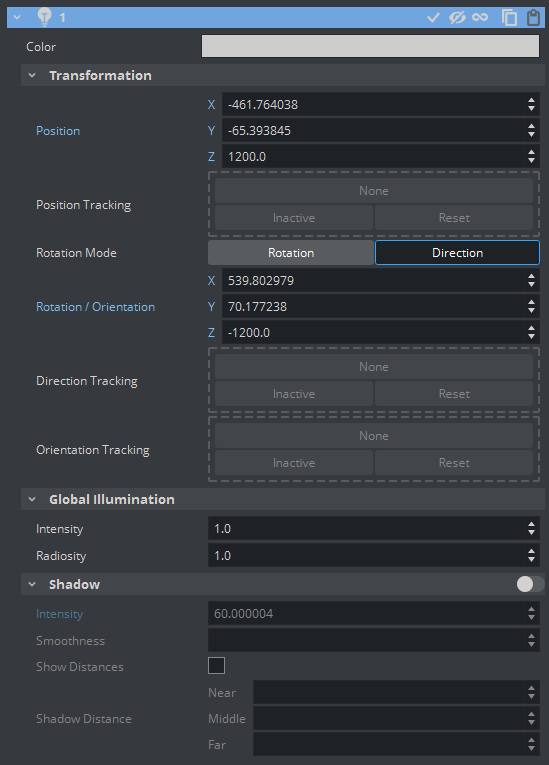

Selecting a camera from the Light Editor Panel expands to show the editable parameters for the currently selected light.
The Light Editor right panel shows the editable parameters for the currently selected light:
Color: Sets the color of the light.
Position: Sets the position of the light along the X, Y, and Z axis.
Direction: Defines the direction vector for Spot or Infinite light.
Rotation: Sets the values to rotate the Spot or Infinite light sources.

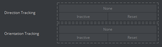

Tracking: A light can be configured to track the Position, and Direction or Orientation of a Container (see To Set a Light to Track Containers):
Position Tracking: The position of the light is the same as the target Containers position.
Direction Tracking: The direction of the light is updated to always point towards the current position of the target container.
Orientation Tracking: The rotation (orientation in space) of the light is the same as the target Containers rotation (orientation in space).
The following parameters can also be adjusted for tracking with light:
Active/Inactive: Drag a Container to the drop zone, to automatically activate light tracking. To stop tracking, click the Active/Inactive button.
Reset: Disables light tracking.
Note: Direction and Orientation tracking cannot be used at the same time. The results would contradict each other (both of them result in a potentially different rotation value for the container).

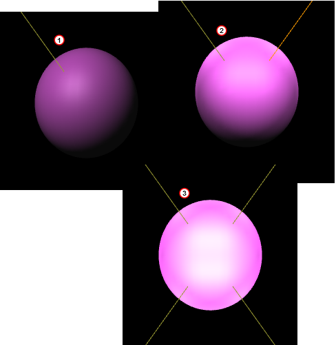

Note: Light number 1 is On by default.
In the left panel, click any or all of the lights in the State column to show different light perspectives:
One light (1)
First four lights (2)
All lights (3)

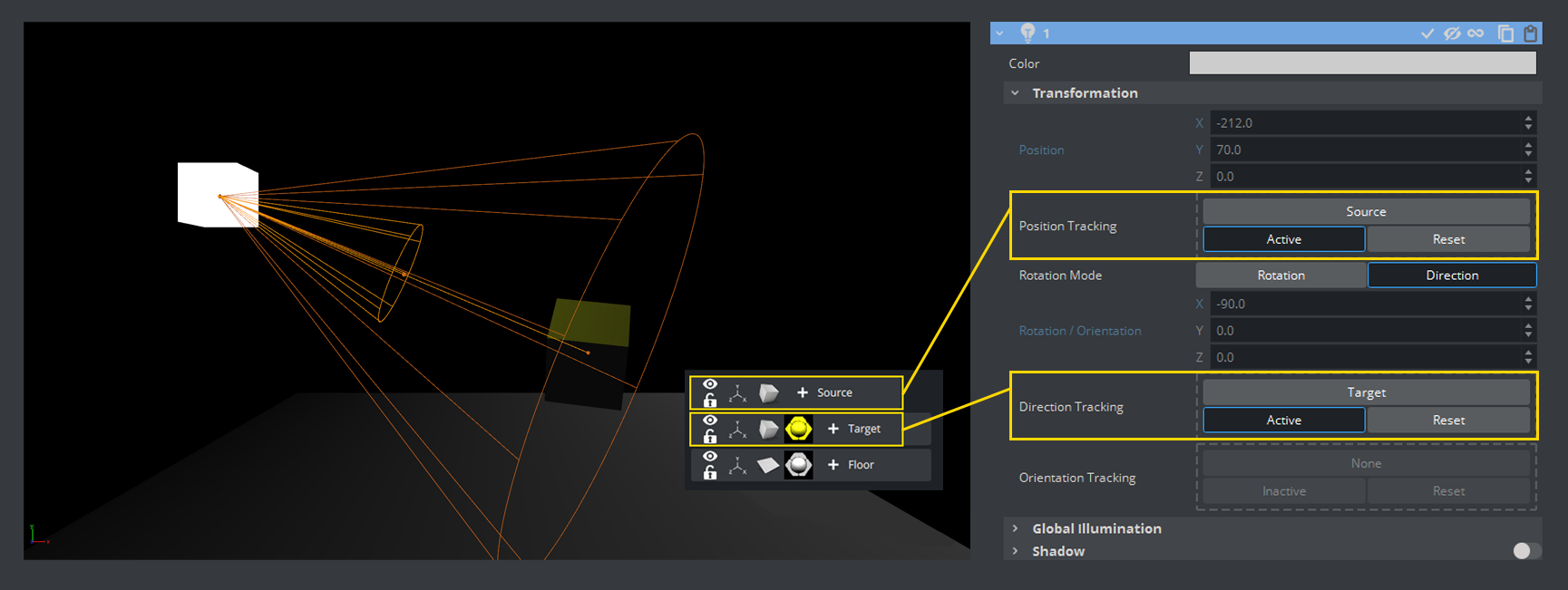

A light can be configured to track containers in both position and direction (see Tracking in the Light Editor Right Panel)
In the Scene Tree create two Objects (1), one to track position (source) and one to track rotation (target).
In the right panel select the Light tab.
Drag source to the Position Tracking drop zone (2).
Drag target to the Direction Tracking drop zone (3).
In the Properties panel click the Container tab.
Adjust the Position settings to track the objects.
