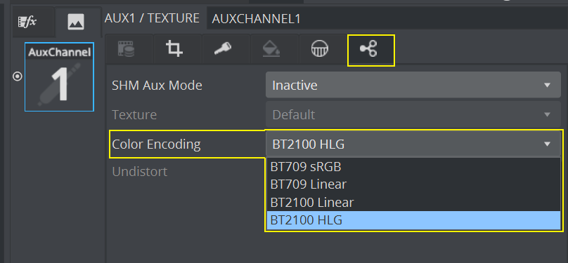

AUX Channels
AUX channels (used to exchange data with third party renderers, such as Unreal Engine) need to have the correct color space set in the in the Aux tab.

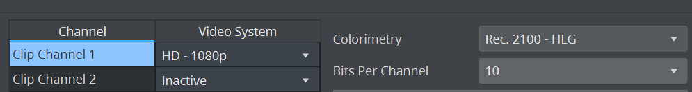

Matrox Clip Player

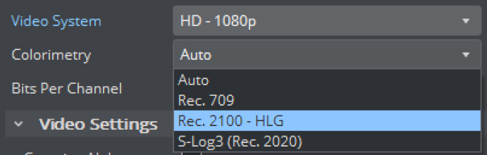

To use the Matrox clip player for HDR clip playback, the colorimetry needs to be set explicitly in the Viz Configuration:
Note: If you are using DVE inputs, the colorimetry needs to match the output colorimetry.

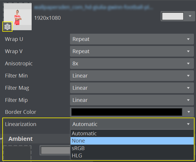

As images require embedding metadata to interpret content correctly, images from other sources (a local file storage) might require a manual setting of the linearization method.
The linearization method can be set to sRGB or HLG within the texture options of several plug-ins (PBR, Phong, Texture Slot, etc.).

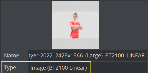

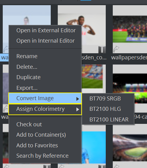

You can also reassign the colorimetry on existing images, or convert images from one color space to another. In Asset view, right click on an image to either re-assign, or convert to a different color space.
Images with correct metadata for HDR are labelled in Asset view, and more details are shown in the properties panel:
