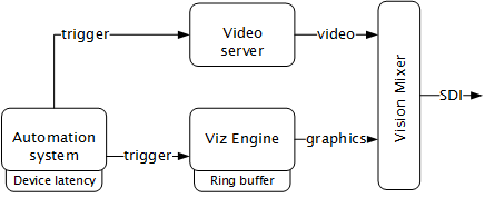

Upstream
An upstream workflow basically means that graphics are rendered separately and independently of the video signal before it is keyed on top of the video signal, traditionally by a vision mixer.
Note that mixing graphics and video in an upstream workflow introduces latency because graphics must be rendered before it can be mixed with the video signal for a final SDI output.
Therefore most automation systems, including Media Sequencer, are able to adjust and cater for latency introduced by devices such as Viz Engine due to the buffer it needs to render graphics in real-time.
In the case of Viz Engine and graphics output the latency has to match Viz Engine’s ring buffer. Ring buffer is simply put the time (in frames) Viz has before its graphics should be ready for on air, and sent to your vision mixer.
Setting the ring buffer size is often simply a matter of setting a parameter called Ring buffer size using Viz Engine’s configuration tool; however, the ring buffer size is only a maximum value which means that graphics rendered faster than the set size will be on air before it was intended. The latter is often the case when an automation system simultaneously takes video and graphics on air.

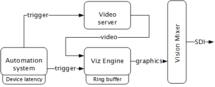

Downstream
Opposite to Upstream mixing you have downstream mixing. Downstream mixing basically means that graphics and video are composited and mixed by Viz Engine. This can be live video or clips treated as DVE for graphics insertion and/or squeeze backs.
In the case of the automation system, the downstream workflow allows such systems to simultaneously take video and graphics on air without worrying about latency as Viz Engine manages compositing and mixing of graphics and video.
In case graphics rendering should fail the video will simply pass through before the graphics engine is on air again and graphics compositing can commence.
