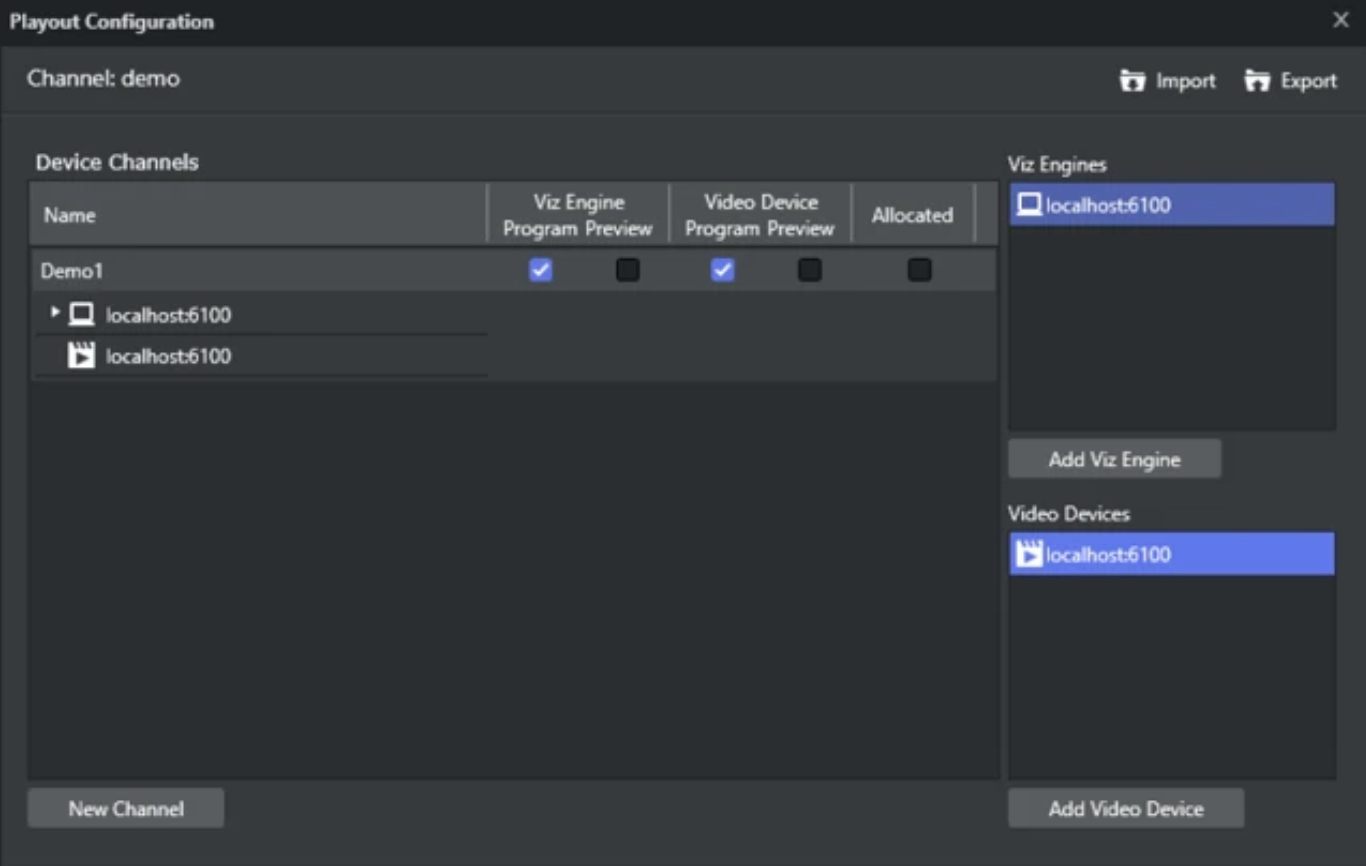

Viz Channel Branding is able to simultaneously handle multiple TV channels, with separate configuration settings for each channel. These configurations must include graphics and/or video playout devices.
Device Channel Characteristics
Device channels are essentially placeholders for playout devices. You use device channels to group the graphics and video devices into logical areas of responsibility (program and preview channels for graphics or video devices).
  • Viz Engines must be assigned for graphics output.
  • For video output, you can assign either Viz Engines or other video playout servers capable of handling your video output.
Info: For more information, see Upstream and Downstream workflows for graphics.

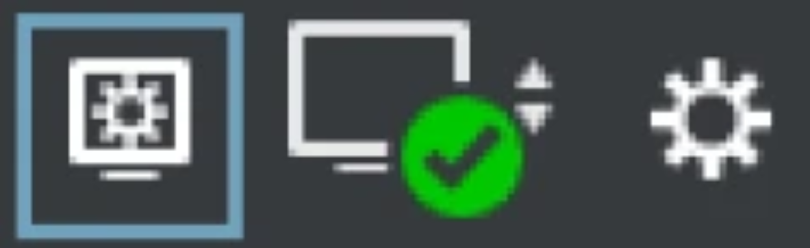

To display the Profile Configuration panel
  • Click the Playout configuration icon on the main menu-bar.
To Import and Export Profile configurations
  • Use the Import and Export buttons to import (or save) a configuration to an XML-file for safekeeping.
Tip: Importing an XML configuration enables quick edits of parameters.

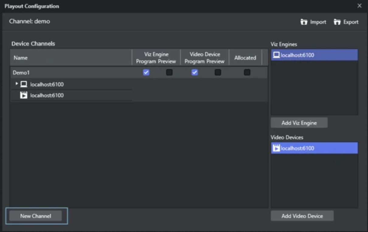

To add a playout device to the Device Channels list
  • Click the New Channel button, or drag and drop a playout device to the Channels list.

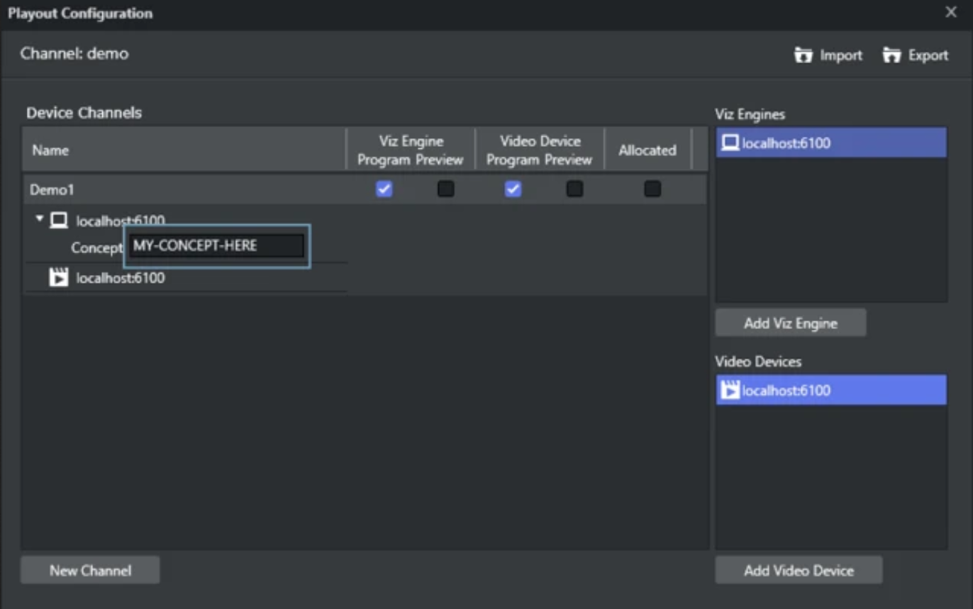

To add a Concept Override for a channel’s playout device
  1. Expand the device channel’s playout device definition and append the concept name.
    This will override any concepts set elsewhere.
  2. Click OK.
Note: Concept names are case sensitive.

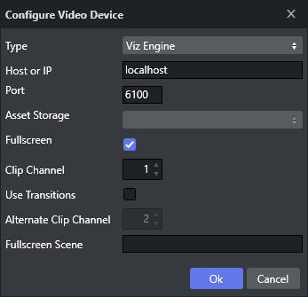

To configure a video device
  1. Click the Add Video button to open the Configure Video Device dialog.
  2. Select the video server Type.
  3. Enter the Host or IP address and the port.
    - Default port for MVCP is 5250.
    - Default port for Viz Engine is 6100.
  4. Select an Asset Storage location.
    - Asset Storage lists available Viz Engine storage for clip transfer and playout.
  5. Enable/Disable Fullscreen mode.
    - When Fullscreen is enabled, which is the default behavior, stand-alone video clip elements are played out full screen in the back layer. Graphics in the middle or front layer will still play.
    - When Fullscreen is disabled. stand-alone video clip elements will only replace the current video clip without triggering animations or transition effects.
  6. Select Clip Channel (only relevant for Viz Engine).
  7. Click OK.
    A status indicator will show if the device is on-air/online.

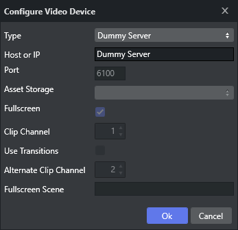

To configure a dummy video device
  2. Select the video server Dummy Server.
  3. Enter a name for your dummy server (e.g. Dummy Server).
  4. Click OK.
Info: This will enable use of the Timeline Editor when Viz One is simply a gateway and video is served from an alternative asset management system.

To add a video device to the Channels list
  • Simply drag and drop a Viz Engine or video device onto the channel in the Channels list, or select it and from the context menu and choose:
    - Add to profile (creating a new channel) or
    - Add to selected channel.
