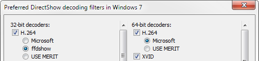

To set preferred decoder
  1. Run the Windows 7 DirectShow Filter Tweaker.
  2. In the dialog box click Preferred decoders.
  3. Set your MPEG-4/H.264 32-bit decoder to FFDShow.
  4. Click Apply & Close.
  5. Click Exit.
