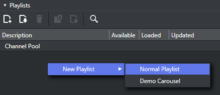

To manually create a playlist
  1. Select your channel.
  2. Click the Playlists pool. All existing playlists for the selected channel are displayed.
  3. EITHER Click the New Playlist button (top left). or the context-sensitive menu option (see screenshot).
  4. A new row representing the new playlist is added.

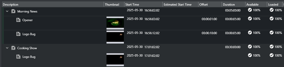

Adding Primary Events to a Playlist
To manually add primary events to a playlist
  3. Open your Playlist.
  4. Right-click in the open playlist and from the context menu, select Add Primary Event.

  1. The secondary event appears below the primary event. Any several secondary events will be sorted according to their offsets.
  2. The most important fields to edit are generally the Offset and Duration fields.

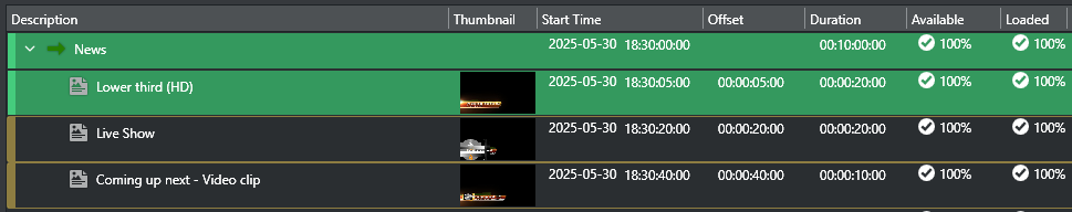

  • Normal state: The state of an un-played element. Elements are shown in White text.
  • Played state: The state of an element that has been played out at least once. Elements in are shown With a green status and dark background.

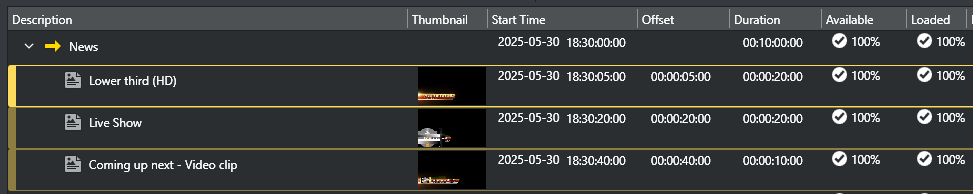

  • Cue state: The state of an element in a group has been called by MSE, to prepare for playing. These elements are shown in dimmed Yellow status.
  • Pre-queue state: The state of a next element that will start playing within 5 seconds. Elements are shown with Yellow status.
  • Playing state: The state of an element that is currently playing. These elements are shown in Green. The cue state of a playlist that is activated by an external trigger has a yellow arrow in front of its element, otherwise the playing state has a green arrow in front. External triggering can be a VDCP-signal from the automation system, for example.

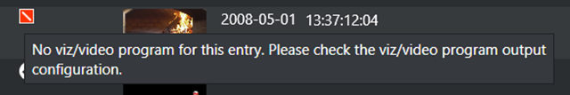

  • Error state: The state of an element where it has been set incorrectly and cannot be played. Elements in error are shown in Red and will also have a tool-tip indicating what caused the error, if the error condition provides this information, which most errors do.

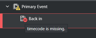

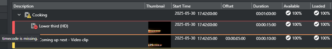

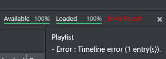

  • Timeline error:
    This error occurs because a timeline in the playlist isn't defined for element(s). To fix this, the user needs to define a timecode for each element correctly such as a begin time, offset, duration, etc. The errors that usually occur for this type are that timecode has already passed, timecode is missing.

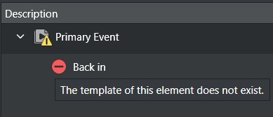

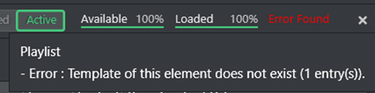

  • Template does not exist:
    This error occurs because the master template of elements inside the playlist is missing.

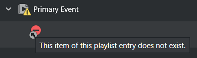

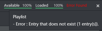

  • Entry does not exist:
    This error occurs because there are some entries missing in any elements inside the playlist. For example, an element created by a page as a reference element then refers to the page. If the page has been removed then this error occurs as it has no entry which it refers to.

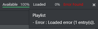

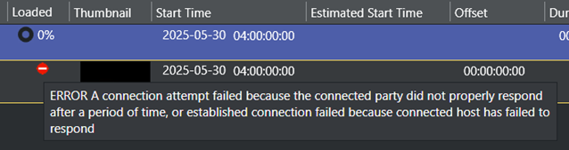

  • Loading error:
    This error occurs when the Playout Device was set with an incorrect host. After that, the client tries to load the scene into Viz Engine by using an initialize command.

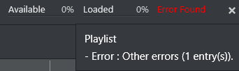

  • Other error types:
    Other errors aren't specific errors. They can occur by any reason which is not related to above cases.

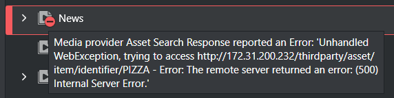

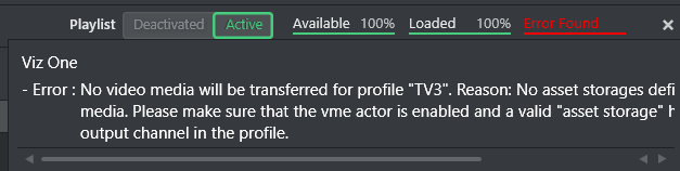

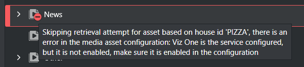

  • Viz One specific errors:
    A Viz One Error is an error related to an asset storage. There are specific details on the solution in the tooltip.
    This error occurs because of an asset storage isn't defined. To fix this, go to Playout Configuration and click edit at the defined Viz Engines and Video Devices. A configuration form with a drop down box for selecting an Asset Storage will appears.
