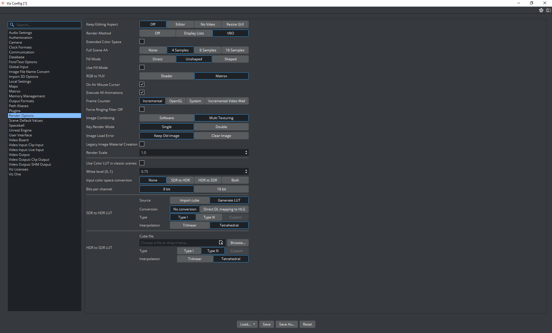

Viz Configuration is the configuration interface for Viz Engine and other applications that integrate with Viz Engine.
The Viz Configuration user interface is divided in two parts:
  • Sections: Shows a list of all the sections available for configuration.
  • Configuration Parameters: Shows all available configuration parameters for each section.
Various parameters regarding the program functionality can be set in the configuration. Viz Artist/Engine is mainly configured with the Viz Configuration. All configuration settings are stored in a Viz Config file (located in the <viz data folder>).

To configure Viz Artist and Engine, click the Config button in Viz Artist or start the Viz Configuration application from the Start menu. Viz Artist/Engine also has a selection of Installed Configuration Profiles. When the configuration profiles are saved, only the settings that differ from the default configuration of a setup (VGA mode, Video mode, etc.) is saved.
Viz Configuration adjusts its size to the current screen resolution when it opens. When running Viz Configuration without Viz Artist, it checks the resolution and limits the size to 1430 x 750 pixels. This is useful for high-resolution configurations, especially during Video Wall Configuration.
