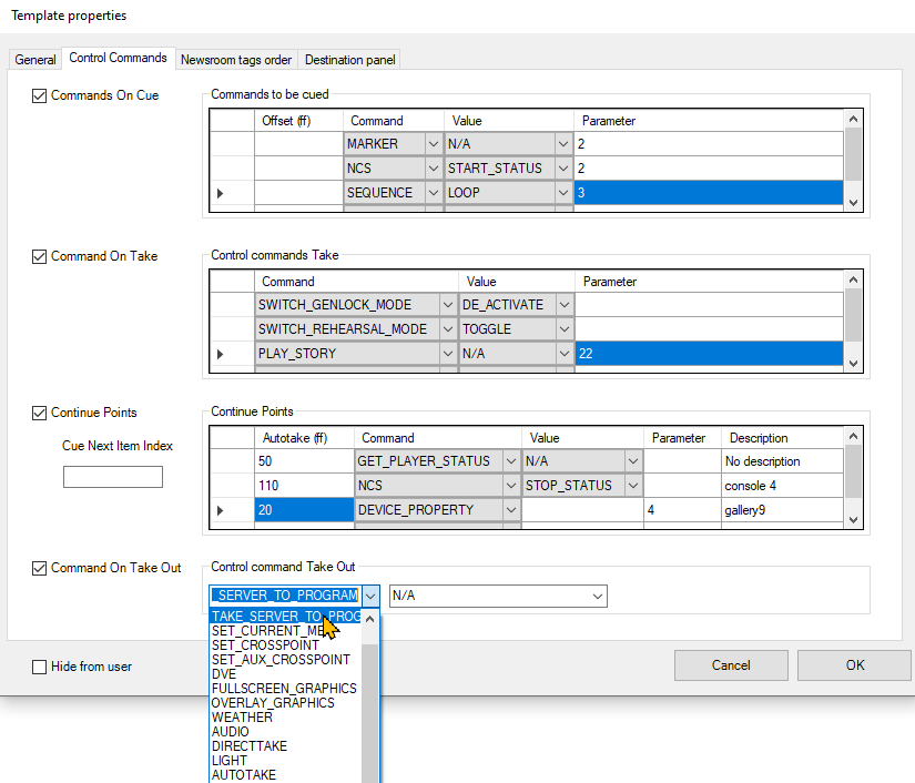

The four categories of control command are Commands On Cue, Command On Take, Continue Points and Command On Take Out.Refer to the table Command Values and Parameters for command details.

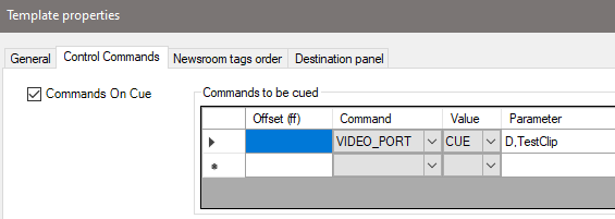

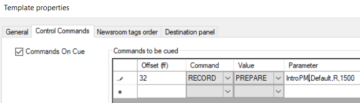

Commands On Cue
You can recall control commands in Preview, when the template is cued. This enables triggering of events when a story item is taken to Preview.
As illustrated above, you can give the command a Value and a Parameter. Refer to the Command Values and Parameters below for which values and parameters are applicable for a given command.

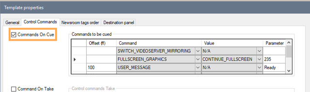

Also, in a similar way as Autotake offsets for Continue Points, you can set an offset for when the command is to be executed.

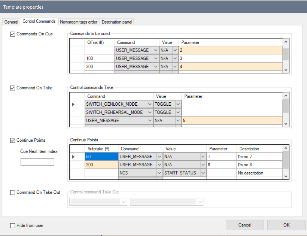

Note: For Cue commands, all offsets are relative to the start of cueing. This differs from Continue Points, where each offset is relative to the previous continue point.
In the illustration above, the User Message (Ready) will be sent 100 frames after cueing. Commands without offset will be executed immediately on Cue.

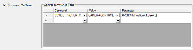

Command On Take
When selected, the commands inserted in Command On Take are executed when the template is taken to Program or On Air.
You can give the command a Value and a Parameter. Refer to Command Values and Parameters below for applicable values and parameters for a given command.
By defining a Newsroom tag as a parameter for an On Take command, the user can set the parameter from the NRCS. For Command On Take, this applies to the Parameter column.
In the Parameter column, right-click (once or twice) and select either Add, Remove or Change Newsroom tag.
Tip: This selection then appears in the Mosart Web App NRCS Plugin (or the legacy ActiveX Plugin) for adding the template to a rundown.
Note also that the Parameter field will get a pink background color to show that a Newsroom tag is present. Hovering over the field will show what the Newsroom tag is.

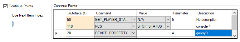

The Continue Points are defined in this table:
As illustrated above, you can give the command a Value, a Parameter and a Description. Refer to the Command Values and Parameters section for which values and parameters are applicable for a given command. The Description is helpful for explaining the purpose of this command.
Cue Next Item Index: Enter the line number (for example, 0, 1, 2, 3) of the continue point that executes a cue for the next/following Primary object. If empty, Viz Mosart cues when entering the last continue point in the list. In other words:
if Cue Next Item Index is empty, then Mosart will cue the next item in the rundown after all the continue points have been taken to air.
if Cue Next Item Index is 0, then Mosart will cue the next item immediately after this item has been taken.
if Cue Next Item Index > 0, then Mosart will cue the next item after the continue point with the number specified by the value of Cue Next Item Index field has been taken to air.
Autotake (optional): The autotake time, in frames. The command is then automatically taken after that time (unless taken manually earlier by the user pressing TAKE NEXT). If empty, the command must be executed manually by the user pressing TAKE NEXT.
Note: For Continue Points, all autotake offsets are relative to the last Continue Point (or, for the first Continue Point, to the time the template was taken). This differs from Commands on Cue, where each offset is relative to the start of cueing.
The order that the instructions appear in the table is important. Looking at the example above:
The first (Player Status) will be run 50 frames after Take
The next one (status from the NRCS) 110 frames later (160 frames after Take) and
The third 20 frames later (180 frames after Take).

Command On Take Out
The commands inserted here are executed when the template is taken from the program, taken Off Air, or at the end of the template. Only a single command can be used in Command On Take Out, and it does not accept any parameters.
You can give the command a Value. Refer to Control Commands in Templates below for applicable values to a given command.

VIDEO_PORT Examples:
Value | Parameter / Properties | Description |
PLAY_PAUSE | D | Alternatively plays / pauses the clip cued in Mosart port D |
PLAY_PAUSE | D,PLAY | Always do a play for the clip cued in port D |
PLAY_PAUSE | D,PAUSE | Always do a pause for the clip cued in port D |
STOP | D | Stops any running clip in port D |
STOP | D,CUE | Stops any running clip in port D followed by a recue |
CUE | D,TestClip | Cues the clip TestClip in port D. |
CUE | @25,D,TestClip | Cues the clip TestClip in port D after a delay of 25 frames. |
RECUE | D | Recues the clip in port D |

Examples
Value | Parameter | Description |
PREPARE | TestClip,Default,R | Prepare a clip with name TestClip on the Default recorder. The Default recorder will be using video port R. |
PREPARE | TestClip,Default,R,1500 | Prepare a clip with name TestClip on the Default recorder. The Default recorder will be using video port R. |
PREPARE | TestClip;Category=Totem ,Default,R,1500 | Same as above but the clip will be assigned to the “Totem” category in a Quantel video server system. Note: There is a semicolon between TestClip and Category. |
START | ,Default | Starts the recording on the Default recorder. Note: There is a leading ‘,’ in the Parameter |
STOP | ,Default | Stops the recording on the Default recorder Note: There is a leading ‘,’ in the Parameter |
