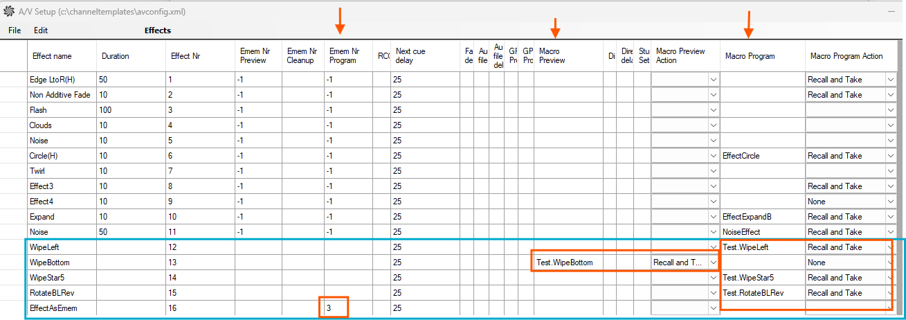

Crosspoints
Open AV Automation > Devices > AV Setup > Edit > Video config and set up the crosspoints mapped to Kairos input sources following the example below (using the user-friendly names provided in Kairos).
Note: The full path must be given with separator. The default separator is dot, which can be changed in KairosVideoSwitcherConfig.xml
Effects
These are supported in Mosart as Macros, using global macros or scene macros created in Kairos. The full path to the macro must be given in A/V Setup.
Note: EMEMs (snapshots) can also be recalled from an effect but not to play a transition.
The Effect Memory setting from the AV Automation Devices > Device Properties (Vision Mixer tab) is used to build the full path for the snapshots recalled in this way:
In the screenshot below, the effects WipeLeft, WipeStar5 and RotateBLEmem are configured as global macros to be executed on Program.
The effect WipeBottom is configured as global macro to be executed on Preview.
The effect EffectAsEmem was configured to recall a snapshot in Program, but to actually execute a transition you still need to provide a macro on Program.
The EMEM number 3 is mapped in the Kairos config file to a snapshot created in Kairos.
Note: The snapshots are created per scene. For different regions, different snapshots need to be created.
