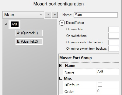

Mosart Port Configurations
The right-hand part of the Video Servers tab (titled 'Mosart port configuration', shown in the screenshot below) has three parts:
the salvo part (in the screenshot the first ‘line', starting and ending with 'Main’, and also the DirectTakes panel with four text boxes and labels)
a tree structure showing virtual ports and virtual port groups (the bulk of the left-hand side of the screenshot)
a panel showing the details of the virtual port or the virtual port group selected ('Mosart Port Group' in the screenshot).
A salvo is a particular setup of servers and ports. There will always exist at least one salvo. If several salvos are defined, these will usually involve different sets of servers and/or ports, and the user will be able to switch from the active salvo to some other salvo. This will involve, among other things, disconnecting from servers that will not be used in the salvo switched to, and connecting to servers that are to be used now. This will be discussed later.

To inspect or change the details of a virtual port group
Select a virtual port group in the tree structure:
(Here, A/B is selected.) These details are available:
Name: The name of the virtual port group. This name is displayed in the will be among the options in the SERVERCHANNEL drop-down in the Videoserver Device properties in the Template editor.
IsDefault: Enable to set the default and preferred video port group for assets residing on multiple systems.
Order: Used by the Media Router only. (See the documentation of the Media Router.) If a Media Router is not used, this value can be left at the default 0.

Name: The name of the virtual port. This name will be among the options in the SERVERCHANNEL drop-down in the Videoserver Device properties in the Template editor.
Main: Auto-generated display name of the linked server port (as explained in To link a server port to a virtual port above), if any.
Mirror: Auto-generated display name of the mirror server port. (This refers to mirroring, to be explained shortly.)
Mirroring
Mirroring refers to having two (instead of one) physical ports linked to each virtual port. (Only two ports may be mirrored.) The two ports will have the same state. E.g., they will both have the same clip cued, or they will both play the same clip (and at the same position). The intended use of this feature is to be a redundancy setup. At start-up, the ‘Main' ports is active, i.e., its outputs (video and audio) are routed through the mixers, whereas the outputs of the 'Mirror' ports are not. The Mosart operator may, especially if there is a problem with a video server linked to a Main port, switch to the 'Mirror’ ports. (There are functions for this both in the Viz Mosart GUI and in AV Automation.) Then the role of the ‘Main' and the 'Mirror' ports are swapped: Now the outputs of the Mirror ports are routed through the mixers, whereas the outputs of the Main ports are not. (The problem with the video server should then be fixed, so that the operator may switch back to Main at some point.)
For this to work as intended, no physical server should participate in both Main and Mirror. I.e., if a physical server has at least one port being the Main port for some virtual port, it should not have a port being the Mirror port for some virtual port.
This method differs from a the use of Main and Backup salvos, to be described later.
To link a second server port to a virtual port for mirroring
It is assumed that you have at least one physical video server and at least two physical ports.
Link one server port to a virtual port as described in To link a server port to a virtual port. Then the situation may be as in the screenshot below. (Here server port Omneon:MIP7600A has been linked to virtual port A.)
Link another server port to the same virtual port. (Referring to the general description of the Mirroring feature above, the two server ports linked to a virtual port should reside on different servers.) In the screenshot below, server port Airspeed:1 is about to be linked to virtual port A.
The text in the virtual port node in the tree will change to reflect that now two physical ports have been linked to it..
Click on the virtual port to verify that the server port from step 2 is now listed as a mirror. In the screenshot below, server port Airspeed:1 is indeed the Mirror linked to virtual port A.
Repeat for other virtual ports as needed.
Click Apply, then Save & Close.
Verify that you can now switch between mirror ports
Either with the Mirror button in Av Automation
or
In the Mosart GUI.
To clear server links in a virtual port
Right-click the virtual port and select Clear links.
To clear the server links from a virtual port group
Right-click the virtual port group and select Clear all links.
Working with Salvos
A salvo is a particular setup of servers and ports. All salvos have the exact same virtual ports and port groups. Salvos differ only in the assignments of physical ports to virtual ports. There will always exist at least one salvo. If several salvos are defined, these will usually involve different sets of servers and/or ports. At any time, one salvo will be active. The user will be able to switch from the active salvo to some other salvo (which will then become active). This will involve, among other things, disconnecting from servers that will not be used in the salvo switched to, and connecting to servers that are to be used now.
Note: Salvos are distinct from Mirroring. When using Mirroring, both the Main and the Mirror ports are connected all the time.
There are several use cases for salvos:
Redundancy: To lessen the effect of video server malfunctions, Main and Backup salvos may be defined, presumably using different servers.
Different needs for different shows, or even within the same show (for instance, sports and news).
Note: It is recommended that the default Main and Backup salvos are not renamed.
The configuration of salvos are done in the upper line of ‘Mosart port configuration', and also in the 'DirectTakes’ panel:
The available UI elements are
Drop-down with the configured salvos, used for selecting a salvo for configuration or deletion. (If another salvo is selected, this salvo will become active. However, this is not the standard way of switching salvos during normal operation. The standard method is using the salvo controls in the main window in AV Automation.)
button for deleting the selected salvo
button for adding a salvo
Name: The name of the selected salvo.
Direct Takes
On switch to: The Recall Nr (see Template Properties) of the direct take template that should be taken when switching to this video server salvo.
On switch from: The Recall Nr of the direct take template that should be taken when switching from this video server salvo.
On mirror switch to backup: The Recall Nr of the direct take template that should be taken when switching to a backup server using this video server salvo.
On mirror switch from backup: The Recall Nr of the direct take template that should be taken when switching from a backup server using this video server salvo.
To add a salvo
Click the button.
A new salvo is created and automatically selected in the drop-down (and also becomes the active salvo). Please note that there are no linking of physical ports to virtual ports. You may want to make such links, and also to change the name of the new salvo.
To remove a salvo
Select the salvo to remove in the drop-down.
Click the button.
The selected salvo is removed. Another salvo is automatically selected in the drop-down (and also becomes the active salvo).
To modify a salvo
Click the drop down box above the Mosart Port Configuration tree and select the salvo you want to edit.
Rename the selected salvo in the Name textbox and/or
Add/change port links as described above.
