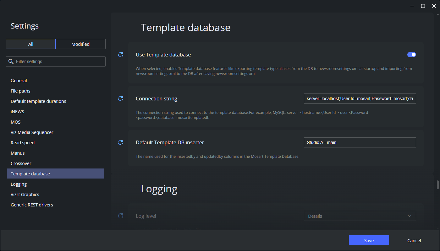

  1. With AV Automation running, navigate from the menu bar to the Settings dialog, Devices > Settings (or keyboard shortcut combination CTRL + SHIFT + P).
  2. Ensure these settings are made:
    1. Use Template database: Set to True to enable connection to the Viz Mosart Template Database (Default: False).
    2. Connection string: The connection string used to connect to the template database.
      For example, for a MySQL database:
      server=<hostname>;User Id=<user>;Password=<password>;database=mosarttemplatedb
    3. Default Template Db Inserter: The name to be used for the …_insertedby and …_updatedby columns, the entities enabling a database update.
      These names are only visible in the database itself where the _insertedby and _updatedby columns are populated with this property.
      We recommend to specify as ThisGallery + main/backup, to identify main and backup servers respectively.
  3. Click Save.

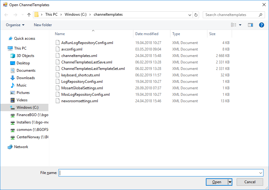

To import channeltemplates.xml to the Template Database
  1. With AV Automation running, navigate from the menu bar to Devices > Template editor.
  2. From Template Editor, open any channeltemplates.xml from file with File >Open.
  3. Select required XML file from the list.
  4. Click Open.
Note: After opening a template file in this way, File > Save will not save to the database, but to the opened file.
Only after completing next step File > Save To Database below, does this operation save to the template database.
  1. Select the File > Save  To Database.
    The content of the selected channeltemplates.xml file is now uploaded to the Template Database.
Note: When importing a channeltemplates.xml to the database any existing templates are overwritten. No templates are deleted from the database.
