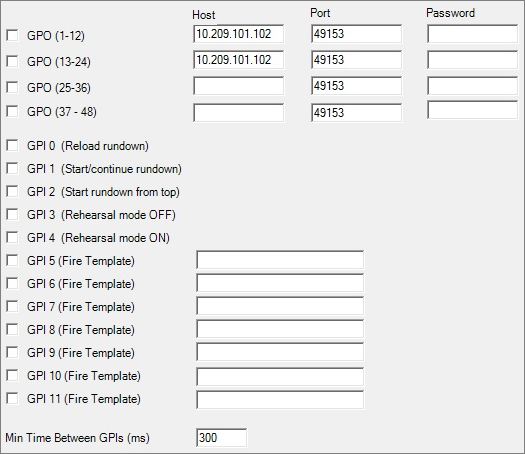

GPO
  • GPO (1-12) (check box): Enables a Web-IO box for the first group of 12 GPOs. Note that this has to be configured for GPI 0-11 to be enabled.
  • GPO (13-24) (check box): Enables a Web-IO box for the second group of 12 GPOs.
  • GPO (25-36) (check box): Enables a Web-IO box for the third group of 12 GPOs.
  • GPO (37-48) (check box): Enables a Web-IO box for the fourth group of 12 GPOs.
  • Host: Hostname or IP address to the Web-IO GPI/O box.
  • Port: Port on the Web-IO GPI/O box.
    If configured as 80, Mosart will use the HTTP Web-IO protocol, while for other Port values Mosart will use the Binary Web-IO protocol.
  • Password: Defines the password, if needed.
Note:  In Template Editor for the GPIO device, you enter n for GPO n+1. For example, with 0 for GPO 1 … 47 for GPO 48.
GPI
Twelve GPI signals can be assigned in Viz Mosart. These GPI signals are received on the GPI/O device configured in the GPO (1-12), see above.
The first 5 GPI signals, GPI 0-4, are connected to fixed Viz Mosart commands. The GPI signals 5-11 can be configured to an arbitrary selection of operations.
  • GPI 0 (check box): Reload rundown. The timeline is stopped and the current rundown is reloaded.
  • GPI 1 (check box): Start/continue rundown. Will trigger the TAKE-NEXT event and with that start the timeline or advance to the next timeline element.
  • GPI 2 (check box): Start rundown from top. Will start the rundown from the first story..
  • GPI 3 (check box): Disable rehearsal mode.
  • GPI 4 (check box): Enable rehearsal mode.
  • GPI 5-11 (check boxes/text boxes): Enables firing of the template or command given in the text box - see below.
  • Min Time Between GPIs (ms): Threshold time before a new trigger command will be processed.

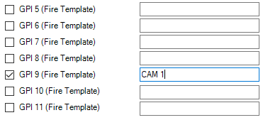

Triggering a Template
Taking a template using one of GPIs 5 to 11 (Fire Template) adds the corresponding template to the timeline.
To Trigger a Mosart Template
This can be used to trigger a Mosart template from the active template set:
Syntax: [TemplateType]|[Variant]
  • Example: Camera|1

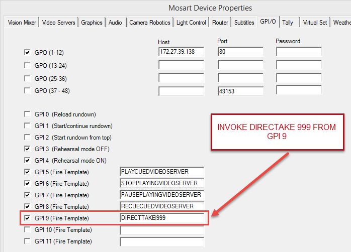

Direct Takes
A direct Take is an example of an available control command.
Syntax
DIRECTTAKE|<the Recall number of the direct take>
Example: DIRECTTAKE|999
will trigger direct take 999 (see screenshot below).

  1. Assign a direct take to a GPI between 5 and 11.
  2. Restart AV Automation.
  3. Trigger this GPI from the external device connected to this GPI (see also To test GPI signals without using GPI below).
  4. Verify on the Mosart server that the corresponding GPI is executed.
    Direct takes are shown in the AV Automation Log window (lower left) at Take.
