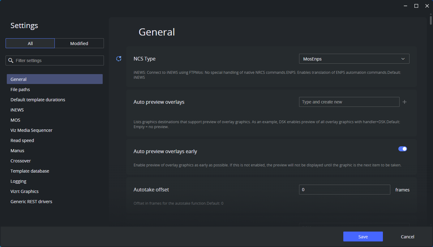

  1. Open the Settings utility by typing settings followed by ENTER.

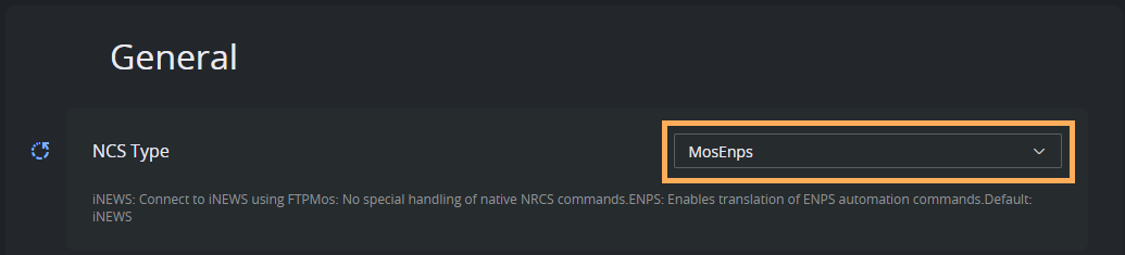

  2. From the General settings section, under NCS Type, select the flavor of MOS that the NRCS uses.

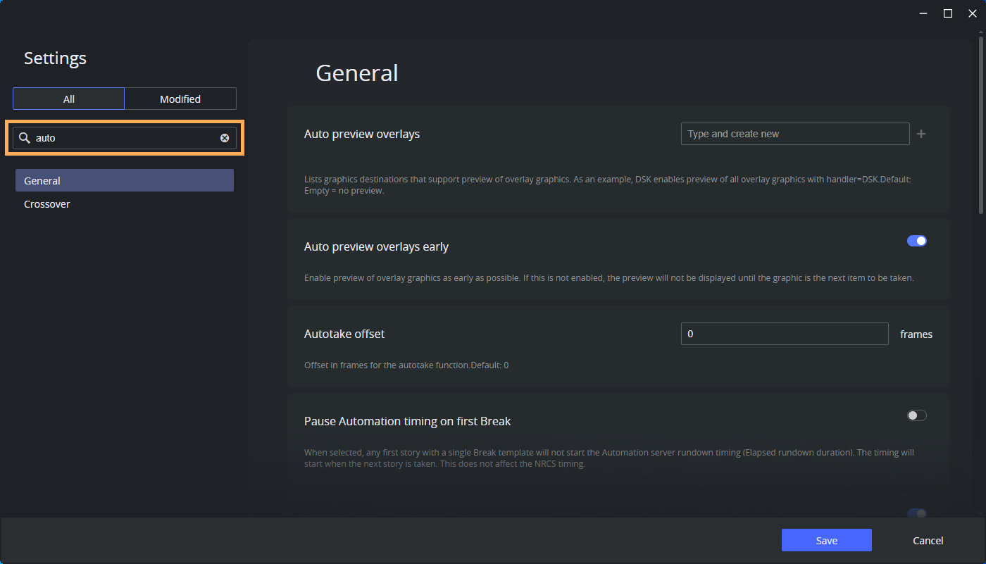

Tip:You can search for a specific value from the Search box.

General
  • NRCS Type: Generic: No special handling of native NRCS commands. Can be:  Generic, DaletPlus, ENPS, NcPower, Octopus, Open Media and MOSInews.
    Default: Generic.
  • Auto preview overlays: Lists graphics destinations that support preview of overlay graphics (i.e. DSK enables preview of all overlay graphics with handler=DSK).
    Default: Empty = no preview.
  • Auto preview overlays early: Enable preview of overlay graphics as early as possible. When set to False, the preview will be displayed only when the graphics is the next item to be taken.
  • Autotake offset: Sets offset for the autotake function.
    Default: 0 (milliseconds).

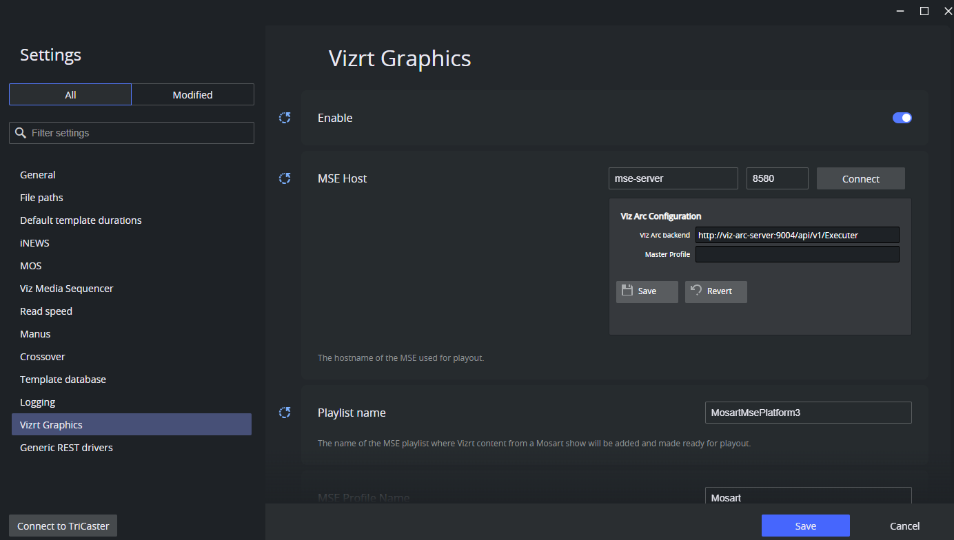

MSE Connection
In the Manus Administrator settings, the new driver is configuring from the Vizrt Graphics settings page.
To enable the connection to MSE
  1. Open the Settings editor.
  2. Navigate to Vizrt Graphics.
  3. Select using the following:
    1. Enable: Allows the use of Viz Arc elements in the show workflow.
    2. MSE Host: The hostname and port number of the MSE used for playout (Default: 8580).
      1. Click Connect to verify the connection and retrieve the Viz Arc settings from MSE.
      2. When the connection is successful, a form will appear where you can enter the Viz Arc configuration.
      3. Click Save to push the changes to MSE.
    3. Viz Arc backend: The URL to the Viz Arc REST API service. Default: http://mse-server:9004/api/v1/Executer.
      1. Replace mse-server with the machine name where Viz Arc service is installed.
    4. Master Profile: The profile configured in Viz Arc.
    5. Playlist name: The name of the MSE playlist where Vizrt content from a Mosart show will be added and prepared for playout (Default: MosartMsePlatform).
    6. MSE Profile name: The profile in MSE used for playout of elements. This setting is not relevant for Viz Arc elements (Default: Mosart).
