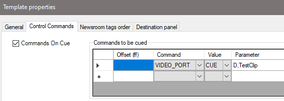

Working with Control Commands
This is done through AV Automation > Devices > Template Editor > Template > Properties > Control Commands tab.
The figure above shows a template with several control commands. Control commands to be executed when the template is cued, when it is taken, and as continue points while the template is on air.
It is also possible to assign control commands to be executed when the template is taken out. Note though that this has a limitation in that the Parameter setting is not available. In this context it may be useful to trigger a direct take at this place.
Adding a Control Command
To add a control command
  1. In the Template properties window, click the Control Commands tab.
    There are four categories of control command:
    1. Commands On Cue
    2. Command On Take
    3. Continue Points
    4. Command On Take Out.
  2. Refer to the table Command Values and Parameters for command details.

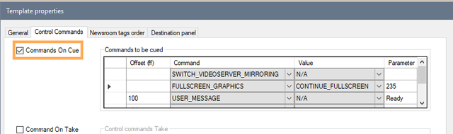

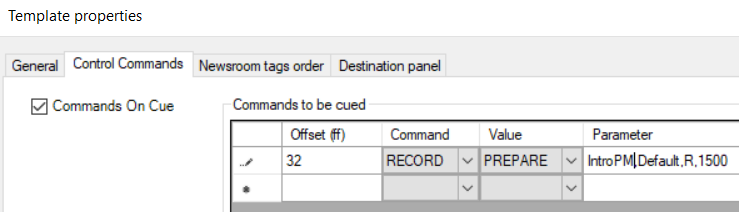

Commands On Cue
You can recall control commands in Preview, when the template is cued. This enables triggering of events when a story item is taken to Preview.
As illustrated above, you can give the command a Value and a Parameter. Refer to the Command Values and Parameters below for which values and parameters are applicable for a given command.
Also, in a similar way as Autotake offsets for Continue Points, you can set an offset for when the command is to be executed.
Info: For Cue commands, all offsets are relative to the start of cueing. This differs from Continue Points, where each offset is relative to the previous continue point.
In the illustration above, the User Message (Ready) will be sent 100 frames after cueing. Commands without offset will be executed immediately on Cue.
By defining a Newsroom tag as a parameter for an On Cue command, you can set the parameter from the NRCS.
For Commands On Cue, this applies to the Parameter column.
Parameters
  • In the Parameter column right-click (once or twice) and select either Add, Remove or Change the newsroom tag.
Tip: This selection then appears in the Mosart Web App NRCS Plugin (or the legacy ActiveX Plugin) for adding the template to a rundown.
  • The Parameter field gets a pink background color, indicating that a Newsroom tag is present.
  • Hovering-over the field displays the value of the Newsroom tag.

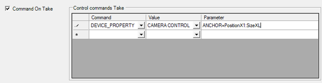

Command On Take
When selected, the commands inserted in Command On Take are executed when the template is taken to Program or on-air.
You can give the command a value and a parameter.
Refer to Command Values and Parameters below for applicable values and parameters for a given command.
By defining a Newsroom tag as a parameter for an On Take command, the user can set the parameter from the NRCS.
For Command On Take, this applies to the Parameter column.
  • In the Parameter column, right-click (once or twice) and select either Add, Remove or Change the newsroom tag.

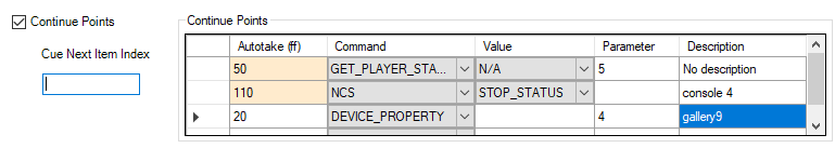

Continue Points
A Continue point may be executed in one of two ways:
  • The user presses TAKE NEXT (default: F12).
  • If a number is entered in the Autotake column (see below), the Continue point will be executed that many frames after the previous Continue point was executed (or, if this is the first Continue point, from when the template was taken on air).
To enable Continue points
  • To enable this functionality, tick the Continue Points checkbox.
The Continue points are defined in this table:
As illustrated above, you can give the command a Value, Parameter and Description. Refer to section Command Values and Parameters about which values and parameters are applicable for a given command. The Description is helpful for explaining the purpose of this command.
  • Cue Next Item Index: Enter the line number (for example, 0, 1, 2, 3) of the Continue point that executes a cue for the next/following Primary object. If empty, Viz Mosart cues when entering the last continue point in the list. In other words:
    1. if Cue Next Item Index is empty, then Mosart will cue the next item in the rundown after all the continue points have been taken to air.
    1. if Cue Next Item Index is 0, then Mosart will cue the next item immediately after this item has been taken.
    1. if Cue Next Item Index > 0, then Mosart will cue the next item after the continue point with the number specified by the value of Cue Next Item Index field has been taken to air.
  • Autotake (optional): The autotake time, in frames. The command is then automatically taken after that time (unless taken manually earlier by the user pressing TAKE NEXT). If empty, the command must be executed manually by the user pressing TAKE NEXT.
Info: For Continue points, all autotake offsets are relative to the last Continue point (or, for the first Continue point, to the time the template was taken). This differs from Commands on Cue, where each offset is relative to the start of cueing.
The order that the instructions appear in the table is important. Looking at the example above:
  1. The first (Player Status) will be run 50 frames after Take
  2. The next one (status from the NRCS) 110 frames later (160 frames after Take) and
  3. The third 20 frames later (180 frames after Take).
By defining a newsroom tag as a parameter for Autotake, you can set the parameter from the NRCS.
  • In the Autotake column, right-click and select either Add, Remove or Change newsroom tag.
Note also that the Autotake field will get a pink background color to show that a Newsroom tag is present. Hovering over the field will show what the Newsroom tag is.

VIDEO_PORT Control Commands in AV Automation Template Properties
The VIDEO_PORT control commands can also be used in templates. The syntax order of the parameter is important.
Examples
Examples using port A:
PLAY_PAUSE,A,PLAY PLAY_PAUSE,A,PAUSE PLAY_PAUSE,A
STOP,A STOP,A,CUE
RECUE,A,PLAY RECUA,A
SET_LOOP,A SET_LOOP,A,OFF SET_LOOP,A,12-444

VIDEO_PORT Examples:
Value
Parameter / Properties
Description
PLAY_PAUSE
D
Alternatively plays / pauses the clip cued in Mosart port D
PLAY_PAUSE
D,PLAY
Always do a play for the clip cued in port D
PLAY_PAUSE
D,PAUSE
Always do a pause for the clip cued in port D
STOP
D
Stops any running clip in port D
STOP
D,CUE
Stops any running clip in port D followed by a recue
CUE
D,TestClip
Cues the clip TestClip in port D.
CUE
@25,D,TestClip
Cues the clip TestClip in port D after a delay of 25 frames
RECUE
D
Recues the clip in port D
RECUE
D,PLAY
Recues the clip in port D and plays it
RECORD Control Commands in AV Automation Template Properties
The RECORD control commands can also be used in templates.
Examples
Value
Parameter
Description
PREPARE
TestClip,Default,R
Prepare a clip with name TestClip on the Default recorder. The Default recorder will be using video port R.
For Quantel this clip will be initiated using the default duration.
PREPARE
TestClip,Default,R,1500
For Quantel this clip will have an initial duration of 1500 frames = 1 minute (25 frames/sec)
PREPARE
TestClip;Category=Totem ,Default,R,1500
Same as above but the clip will be assigned to the “Totem” category in a Quantel video server system.
Info: There is a semicolon between TestClip and Category.
START
,Default
Starts the recording on the Default recorder.
Info: There is a leading ‘,’ in the Parameter
STOP
,Default
Stops the recording on the Default recorder
The options in the Value dropdown are
  • PREPARE
  • START
  • STOP
  • STOP_AND_DETACH
  • DELETE.
The Parameter should be a comma-separate list of up to four items:
  • ClipName
  • Recorder
  • PortName
  • Duration.
If all four items are present, the Parameter will be
<ClipName>,<Recorder>,<PortName>,<Duration>
RECORD: Syntax
If not all items are present, any commas to the left of present items will still have to be present.
For example, if only Recorder is present, the syntax is:
,<Recorder>
In some cases, the ClipName item may have sub-items. In that case, the sub-items are separated by semicolons. (An example is given below.)
Here the options in the Value dropdown are explained in more detail:
  • PREPARE: Viz Mosart will prepare a clip for recording.
    • Parameter: <ClipName>,<Recorder>,<PortName>,<Duration>
    • ClipName: The name of the clip to be created
    • PortName: The name of the video port where the recording shall take place. Note that this port has to be part of the 'Rec' virtual video port group.
      Info: For the setup of recording ports, please refer to The Viz Mosart Administrator Guide. See also Recording in the Viz Mosart User Guide.
    • Recorder: A user-defined name to be used for the recording, tied to ClipName and PortName. Used by START and STOP.
    • Duration: Estimated duration of the recording in frames.
  • START: Viz Mosart will start a recording previously PREPAREd
    • Parameter: ,<Recorder>
      Info: Note the leading comma as explained above.
    • Recorder: Name of recording session as created by PREPARE
  • STOP: Viz Mosart will stop a recording previously STARTed.
