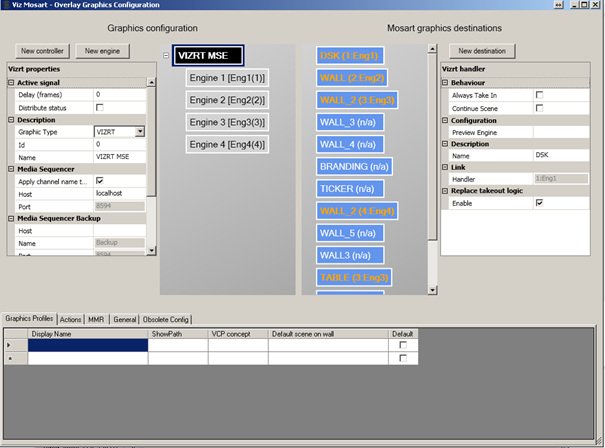

The list of channels contains the active destinations is configured in the Overlay Graphics Interface. Active destinations are destinations linked to a graphic engine.
In the configurations above, the following engine-destination mapping is performed:
Destination
Engine number
DSK
1
WALL
2
WALL_2
3
WALL_2
4
TABLE
3
