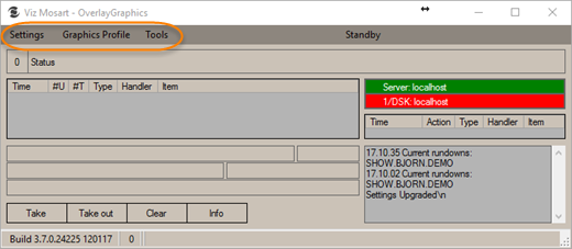

The Overlay Graphics Interface provides control and monitoring of overlay graphics for all Viz Mosart-approved graphic engines.
Start Mosart Graphics Interface by double-clicking the application icon:
VM_ico_og (1).png  or by navigating to the installation directory (by default C:\Program Files (x86)\Mosart Medialab\Mosart Server) executable MMOverLayGraphicsInterface.exe.
Note:
  • The Overlay Graphics interface is only used for overlay graphics. Full-frame graphics are controlled through the AV Automation application.
menu bar at the top offers Settings, Graphics profileTools and Standby.

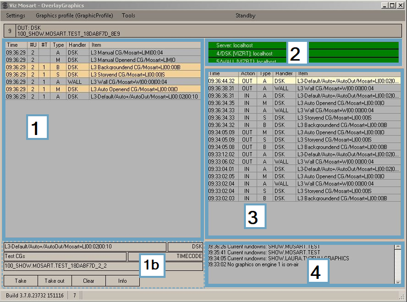

The Overlay Graphics Interface GUI consists of four main areas ([1] to [4] in the illustration).
A status bar at the foot of the UI provides information on product version number and the total number of graphics in Viz Mosart (rundown overlays + named overlays + button overlays. 7 in the example above).

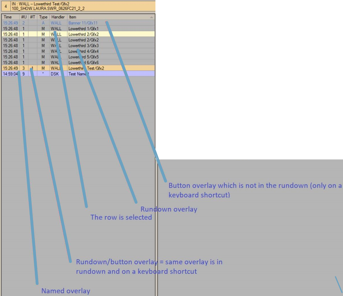

The main column labels are:
  • Time: The time when the graphic was added in Overlay Graphics (usually at rundown import).
  • #U: The number of times this graphic has been updated.
  • #T: The number of times this graphic has been taken.
  • Type: The graphic type. Can be:
Type
Description
A
Auto Out (a Manual graphic can also be Auto Out)
B
Background End
S
Story End
M
Manual (Open End)
L
Last Out
Stay Always
If template is STORYSTART
None of the above
Note: Locator is a special graphics item that is linked to a crosspoint. When taking the crosspoint from a Viz Mosart template, either as a switcher crosspoint or keyed crosspoint (in a DVE box), the graphics are also (re-)taken.

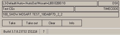

[1b] Details of a Selected Graphic from the List of Overlay Graphics
Selecting an overlay graphic from the list displays further details
Element
Description
Graphic title
Handler name (the destination or the channel for this graphic)
Graphic description
Graphic ID
Note: This is the Viz Mosart Graphic ID, not the graphic ID from graphic database (Graphic Hub/Oracle)
Action Buttons
Take: Takes graphic on air
Take out: Takes graphic off air
Clear: Takes out all taken graphics
Info: Opens an editor window where the graphic MOS item can be changed and updated

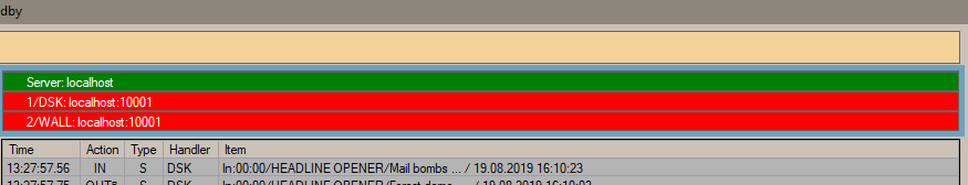

[2] Server Status
[3] General Log
The center-right contains a log of all actions performed on the overlay graphics either triggered by Viz Mosart or by clicking Overlay Graphics buttons.
To clear the General log area
  • Double-click inside it.
[4] Event Log
To clear the Event log area
