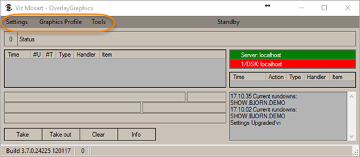

menu bar at the top offers Settings, Graphics profileTools and Standby.
Overlay Graphics Interface overview

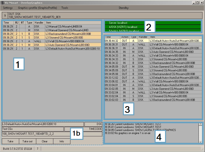

The Overlay Graphics Interface GUI consists of four main areas ([1] to [4] in the illustration).

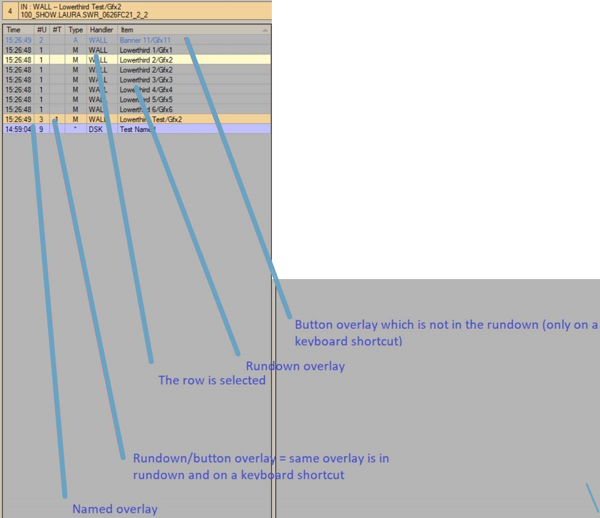

A status bar at the foot of the UI provides information on product version number and the total number of graphics in Viz Mosart (rundown overlays + named overlays + button overlays. 7 in the example above).
The main column labels are:
  • Time: The time when the graphic was added in Overlay Graphics (usually at rundown import).
  • #U: The number of times this graphic has been updated.
  • #T: The number of times this graphic has been taken.
  • Type: The graphic type. Can be:

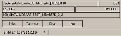

[1b] Details of a Selected Graphic from the List of Overlay Graphics
Selecting an overlay graphic from the list displays further details
Element
Description
Graphic title
Handler name (the destination or the channel for this graphic)
Graphic description
Graphic ID
Info: This is the Viz Mosart Graphic ID, not the graphic ID from graphic database (Graphic Hub/Oracle)
Action Buttons
Take: Takes graphic on air
Take out: Takes graphic off air
Clear: Takes out all taken graphics
Info: Opens an editor window where the graphic MOS item can be changed and updated
[2] Server Status
[3] General Log
The center-right contains a log of all actions performed on the overlay graphics either triggered by Viz Mosart or by clicking Overlay Graphics buttons.
To clear the General log area
  • Double-click inside it.
[4] Event Log
To clear the Event log area
System Information
Menu Bar
Settings
Properties: Opens Overlay Graphics Configuration. See Overlay Graphics Configuration and Use
Graphics Profile
See Graphics Profiles Tab.
Tools
Editor: Opens a Test graphics window.
Instrumentation Panel: Displays all device commands in real time, as sent to the various connected devices.
See Mosart Instrumentation Panel.
Standby
  • All the engines linked to the controller are set/unset to standby by clicking this toggle button.
Info: This action can also be performed from the Viz Mosart UI.
You can also take any engine individually into standby (only in the OGI application) while the other engines in the same controller are active.
