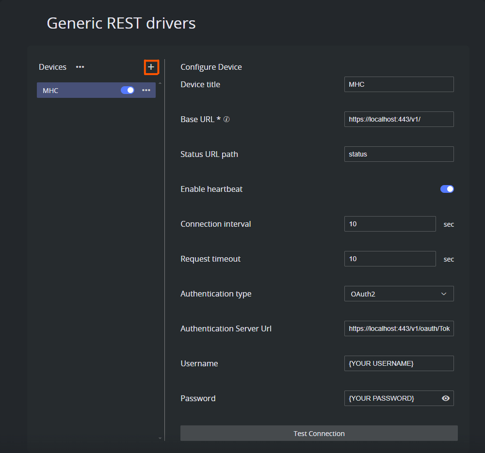

To configure REST API control of a robotic camera
  1. Open AV Automation and from the menu bar, navigate to Devices > Settings.
  2. Scroll down the Settings menu to Generic REST drivers.
  3. Add a new driver by clicking the Plus (+) sign.
  4. Fill in required details, following the example below:
Note: Base URL and Authentication Server URL are the machine running MHC, not localhost.

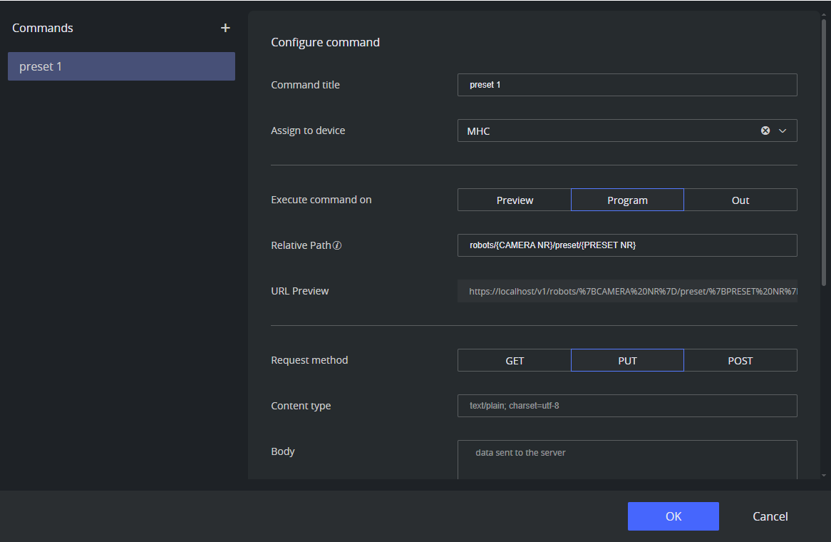

  1. Click Save and close the menu.
  2. Open Template Editor.
    (AV Automation > Devices > Template editor).
  3. Select File > New to create a new template.
  4. Right-click in the template’s dark gray area then Enable > Generic Rest Commands.
  5. Add a command by clicking the Plus (+) sign in the left-side Commands panel.
  6. Fill in required details, following the example below:
Note:
  • {CAMERA NR} is the index of the camera you want to use (starting at 0), and {PRESET NR} is the index of the preset you want to load (starting at 0).
    If you want to load preset 3 of camera 2, you would do robots/1/preset/2.
  • Set Execute command on to your requirement, it need not be Program as shown in the sample screenshot.
  1. Click OK.
  2. Save the template.
  3. Add this template to a Mosart rundown.
    Whenever it is taken, it triggers MHC to move the selected robotic camera to the selected preset position.
