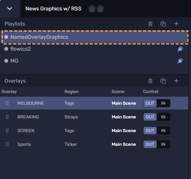

Viz Flowics-based Systems
Info: If working with NRCS graphics, see NRCS-based Systems above.
On the Flowics Rundown Control page, you will manually create a non MOS-controlled playlist in the graphics package.
Your manually created playlist will persist in the Flowics package playlists list, until deleted.
Obtaining a valid overlay graphic as a Named Overlay candidate
To obtain Flowics candidates for named overlays
  1. Log-in to your Flowics system.
  2. In the Playlist panel, for rundown control of your Flowics graphics package, create a playlist called NamedOverlayGraphics.
  3. In the Overlays panel, manually add overlays from the package.
    Four Overlay examples:
  4. Rename the slugs that will be referenced by Viz Mosart.
Info: Names in the list must be unique as these names will be referenced by Viz Mosart and must match what is in the NamedOverlayGraphics.xml file.
