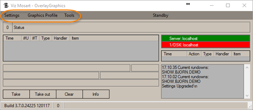

menu bar at the top offers Settings, Graphics profileTools and Standby.

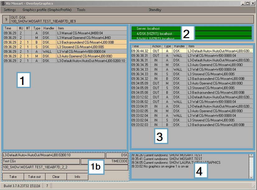

The Overlay Graphics Interface GUI consists of four main areas ([1] to [4] in the illustration).
A status bar at the foot of the UI provides information on product version number and the total number of graphics in Viz Mosart (rundown overlays + named overlays + button overlays. 7 in the example above).

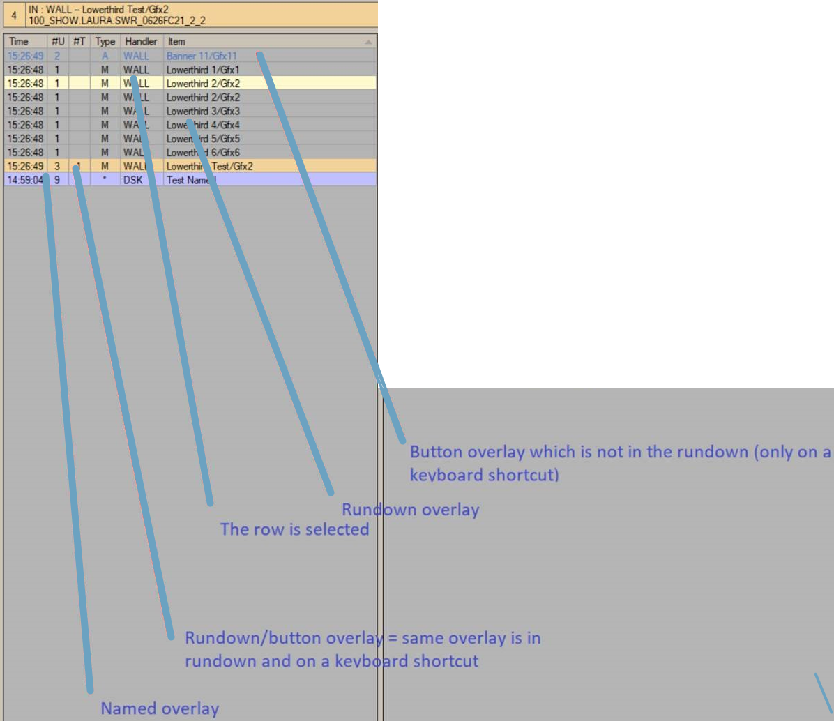

The main column labels are:
  • Time: The time when the graphic was added in Overlay Graphics (usually at rundown import).
  • #U: The number of times this graphic has been updated.
  • #T: The number of times this graphic has been taken.
  • Type: The graphic type. Can be:

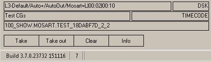

[1b] Details of a Selected Graphic from the List of Overlay Graphics
Selecting an overlay graphic from the list displays further details.
Note that the newest row is selected automatically whenever a graphic is taken, so a manual selection may be replaced by a later take.
Element
Description
Graphic title
Handler name (the destination or the channel for this graphic)
Graphic description
Graphic ID
Info: This is the Viz Mosart Graphic ID, not the graphic ID from graphic database (Graphic Hub/Oracle)
Action Buttons
Take: Takes graphic on air
Take out: Takes graphic off air
Clear: Takes out all taken graphics
Info: Opens a window where the graphic MOS item can be inspected, and potentially edited and updated.
The editing and updating of graphics in this window is a legacy feature that is not recommended to use. Be aware that not all property changes in this view are effectuated, and if not, they are silently discarded.
For a Named Overlay that uses placeholders (for example {story:slug}), Viz Mosart re-resolves the content on every take. All takes of the same Named Overlay share one Viz Mosart Graphic ID, so only the most recent version is kept: Info shows that overlay's latest content, not the content as it was when an earlier row was logged. Selecting a different Named Overlay shows that overlay's own content correctly, and a Named Overlay without placeholders is static and always shown correctly.
[2] Server Status
[3] General Log
The center-right contains a log of all actions performed on the overlay graphics either triggered by Viz Mosart or by clicking Overlay Graphics buttons.
To clear the General log area
  • Double-click inside it.
[4] Event Log
To clear the Event log area
System Information
Menu Bar
Settings
Properties: Opens Overlay Graphics Configuration. See Overlay Graphics Configuration and Use
Graphics Profile
See Graphics Profiles Tab.
Tools
Editor: Opens a Test graphics window.
Instrumentation Panel: Displays all device commands in real time, as sent to the various connected devices.
See Mosart Instrumentation Panel.
Standby
  • From the menu bar, click Standby.
    This is a toggle button. All engines linked to the controller are set/unset to standby by clicking Standby.
