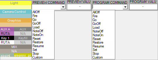

- GPO

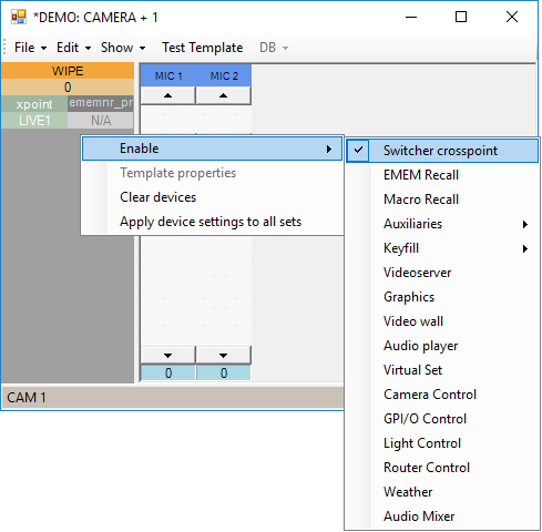

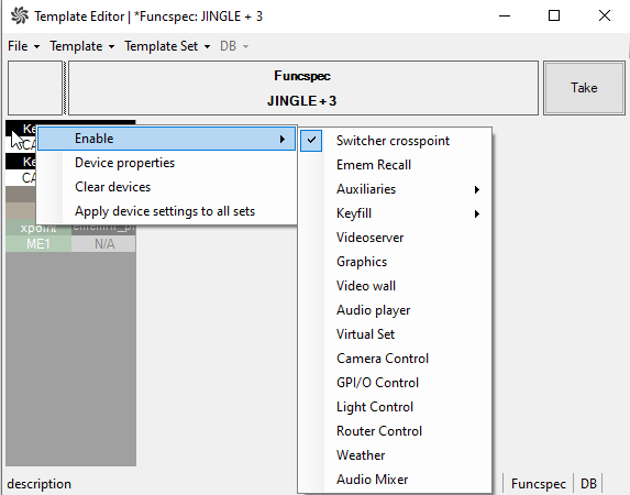

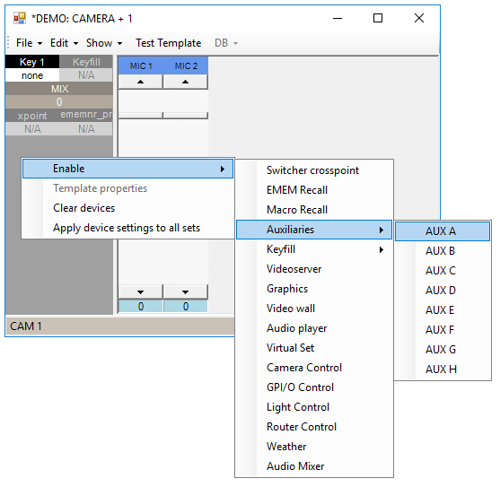

Working with Device Functions
Right-click inside the device function area to open a menu containing the following options:
Enable: These commands are described in more detail below.
Template properties: Opens the current template's properties page, see Template Properties in section Working with Templates.
Clear devices: Removes all devices from the device function menu, after confirming in a pop-up message window.
Apply device settings to all sets: Applies all the device settings to all templates of same type and variant throughout all template sets.
Mark as intentionally empty: This option is available for empty templates only and shows up when the Use ‘Mark template as empty’ feature is enabled in Settings Editor MOS-General. See Empty Templates for more details.

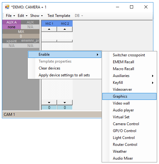

To enable device functions
Right-click in the device's Function area (black row).
Select the device to configure from the Enable menu.
This opens the Edit box for the selected device.
Info: Depending on the protocol chosen, the caption EMEM Recall may alternatively be:
Emem Recall
Dmem Recall
Snapshot Recall
Memory Recall
To modify device functions
Select Device properties. See the topics below for listings of properties for each device.
Info: Depending on the Protocol chosen, the caption Macro Recall may alternatively be:
Custom Control
To remove device functions
Right click in the Device function area
De-select it from the Enable menu.

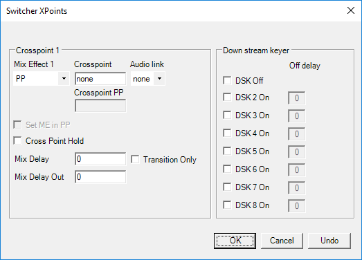

Video Switcher Crosspoint
The video switcher crosspoint enables switching on the video switcher. The A or B bus assignment of the mixer effect (PP/MEx) is automatically handled by the automation.
Guidelines for Video Switcher Crosspoint Configuration
Item | Description |
Mix Effect | Selects which Mix Effect (ME) bank on your vision mixer that you are currently handling. Info: For vMix, PP maps to the main vMix output. ME1 maps to the first Mix input, ME2 to the second, and so on. Info: For ATEM, both PP and ME1 map to the same physical ME1 on the switcher. The difference is only relevant for keyfills. See Guidelines for Keyfill Configuration below. |
Crosspoint | Crosspoint on the video switcher. Default value: none
Info: Newsroom tag available. |
Audio link | Default value: none |
Crosspoint PP | If another Mix Effect (ME) than PP is selected, then you can select a crosspoint for program by writing the crosspoint name in the field. |
Set ME in PP | If another Mix Effect (ME) than PP is selected, check this box to make that ME the crosspoint for PP. (Checking this box disables XPOINT PP). |
Cross Point Hold | Keeps the crosspoint on the selected Mix Effect. |
Mix Delay | Offset, in frames, of when to perform the transition. |
Mix Delay Out | Delay, in frames, of when to perform the next transition. |
Transition Only | Only delay the switcher transition (sub items will perform). |
DSK Off | Turns off the Downstream Keyer (DSK) on the video switcher when the template is active in program. |
DSK 2 On, ..., | Downstream Keyer (DSK) 2-8 on. Turns on the DSK 2-8 (PP key 2-8) on the video switcher when the template is active in program. |
Off delay | Delay in frames to set the DSK 2-8 off. |

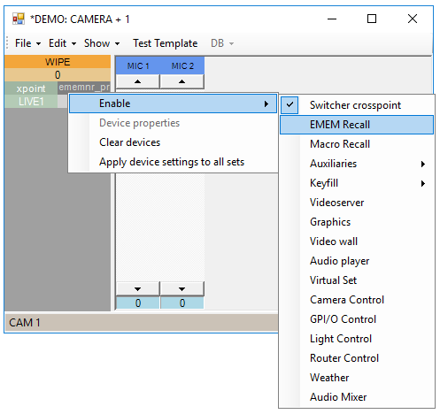

Video Switcher Register/Timeline Recall (EMEM Recall/Emem Recall/Dmem Recall/Snapshot Recall/Memory Recall) will recall a register and/or timeline in the video switcher.
To open the video switcher Register/Timeline recall
This procedure is based on the example in the screenshot.
Open Template Editor.
Right-click over ememnr_pr
Select Enable > EMEM Recall
Enter or select required values

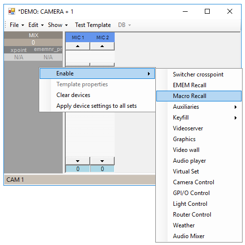

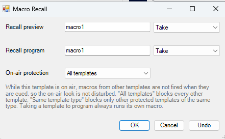

Macro Recall
Macro Recall is available with the following vision mixer protocols (selected in the configuration menu AV Automation Devices Vision Mixer):
Ross Acuity
Ross Carbonite
GV CPL
GV KAHUNA (Kahuna/Kula)
SONY SERIAL TALLY
TriCaster
ATEM
vMix
To open a Macro Recall
Navigate to Enable > Macro Recall
Enter or select required values.
Guidelines for Macro Recall Configuration
Item | General description | Drop-down | Text field |
Recall preview | Action to be taken when entering preview mode. | See below | See below |
Recall program | Action to be taken when entering program mode. | See below | See below |
On-air protection | Prevents macros in other templates from changing the on-air look while this template is on air. | See below | N/A |
Drop-down Menu Alternatives
Drop-down option | Description |
None | No action. |
Recall | Macro is prepared (or cued). |
Take | Macro is taken. |
Recall and Take | Macro is prepared and taken. |
Load project | Project is loaded. Supported only by Kahuna/Kula and vMix. Warning: Load Project could affect the performance of the switcher. Use with caution during a running show. |
Text field format depends on the mixer chosen
Mixer | Text field | Remark | ||||||||||
ATEM | Name or index (starting from 1) of the macro. | Load project not supported. | ||||||||||
Acuity | One bank character and two macro characters. | Recall (and Recall and take) only. Note that Device is named Custom Control instead of Macro Recall. | ||||||||||
Carbonite | One bank character and two macro characters. | Recall (and Recall and take) only. Note that Device is named Custom Control instead of Macro Recall. | ||||||||||
GV CPL | Macro number (integer) in the range 1-999. | Recall (and Recall and take) only. | ||||||||||
Kahuna/Kula | The meaning and format of the text fields depend on the selected drop-down option:
SONY SERIAL TALLY | Macro number (integer) in the range 1- 250. | Recall (and Recall and take) only. | ||||||||||
TriCaster | Plays a macro having the name provided or the unique ID (GUID). | Take only | ||||||||||
vMix | Name of vMix script to execute. Load project: Path to preset file to load. | Load project: Absolute or relative path from the vMix installation folder (the | ||||||||||
Off | No protection. Macros always run as configured. This is the default. |
All templates | While this template is on air, a macro in any other template is not fired when that template is cued. |
Same template type | While this template is on air, a macro is not fired when a template of the same type, for example another DVE, is cued and also has on-air protection enabled. Templates of other types are not affected. |

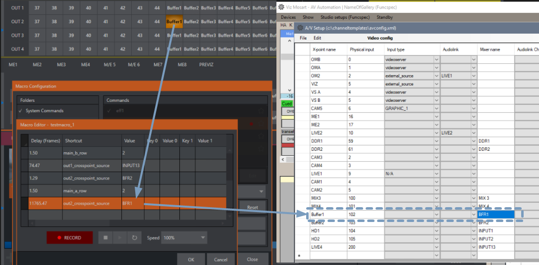

Configuring an NDI Router (Viz Vectar Plus or Tricaster VMC)
Info: For NDI output crosspoints, you must refer to actual crosspoint names recognized by VMC1 (and not any user-friendly names that would be mapped to the physical inputs).
These default naming on the NDI router side is typically:
- INPUTn
- DDRn
- BFRn
- MIX n.
The same naming must be used on the Viz Mosart side.
In AV Automation > Devices > A/V Setup > Video Config > Mixer name column, you must provide the hardcoded name associated with the user-friendly name of the crosspoint.
This name is found on the switcher side.
In the example below, the value of the literal crosspoint name is the router output found in the switcher's Macro Configuration > Macro Editor menu and added to AV Automation:
There is a new setting UseOutputCrosspointNames in the IP-protocol config VizrtIpSystemsVideoSwitcherConfig.xml set by default to expect the crosspoint name, instead of the Viz Mosart standard of using physical input naming.

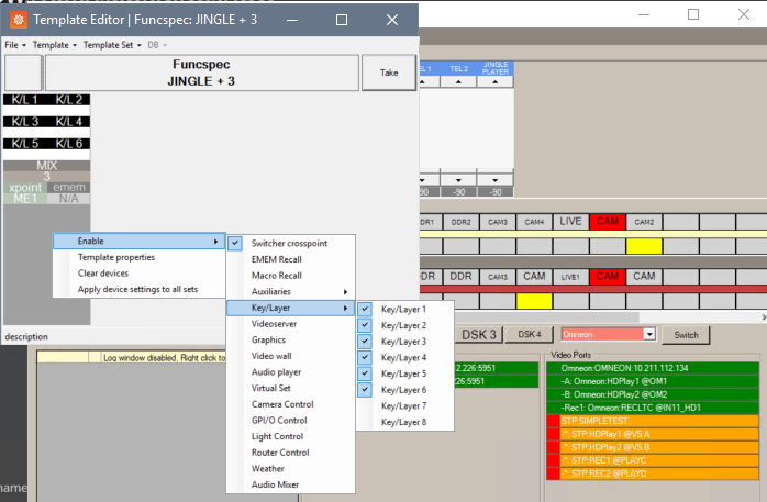

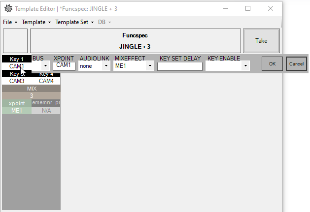

Keyfill: Video Switcher Key Bus Delegation
Video switcher key bus delegation enables routing of internal video switcher signals to the keyers on the different mixer effects of the switcher.
Info: For TriCaster video switcher supporting M/E effects with 4 layers, the device is named Key/Layer.

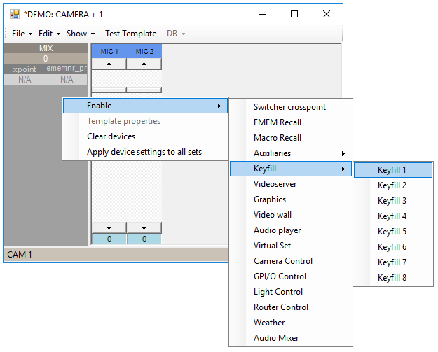

To enable Keyfill by bus delegation
Navigate to Enable > Keyfill > [Keyfill index]
To enable Keyfill by bus delegation for M/E effects with 4 layers
Devices like Vizrt’s TriCaster family TriCaster Plus or VMC1 let you configure M/Es with effects supporting up to four primary sources/input layers (along with Key layers), called A, B, C and D buses.
Viz Mosart can control these buses from a template or keyboard shortcut when TriCaster is used as a vision mixer.
Navigate to Enable > Key/Layer > [KeyLayer index]
The Key/Layer device on a template can be used for VMC1 vision mixer to either set the crosspoint for a Key bus or to set the crosspoint for A, B, C and D buses of a M/E effect with 4 layers.Right-click > Device properties.
Select from the BUS drop-down menu:If the device is used for setting the crosspoint for a key bus, set the BUS drop-down menu to a number between 1 and 8 on the Key/Layer device properties.
BUS | Selects the key bus on the selected ME. If the video switcher supports M/Es with four layers (for example Vizrt’s TriCaster family), four more buses are available corresponding to each layer, A, B, C and D: If the switcher is Ross Acuity, the number of buses is 16 where the first 8 are used for the selected mixer region keyers and the next 8 buses target the second channel of the keyers. Info: Newsroom tag available. |
XPOINT | Crosspoint on the video switcher. Default value: none Info: Newsroom tag available. |
AUDIOLINK | Assigns a link group to this delegation. Please refer to Audio and Video Setup (previously Linking video and audio sources) for the use of this feature. |
MIXEFFECT | Select the ME where the key crosspoint should be set. Info: Newsroom tag available. Info: For ATEM, both PP and ME1 map to the same physical ME1 on the switcher. |
KEY SET DELAY | Set the delay in frames of the key delegation when taking the template to a program. If the field is left blank the key is set in preview. |
KEY ENABLE | Key enable drop-down menu. Info: Newsroom tag available. |

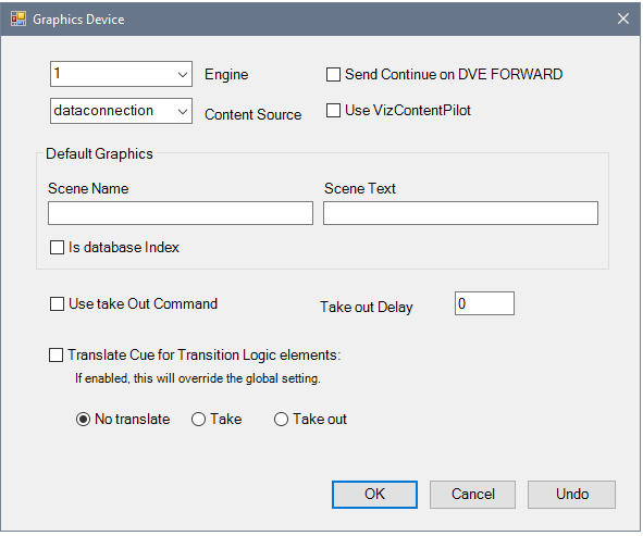

Graphics
The Graphics device enables recall of graphic elements.
Graphic elements are cued (loaded) in Preview and played (started) when taken to Program.
Guidelines for Graphics Configuration
Engine | Selects the engine to operate on when using this template, based on your configuration. |
Content Source |
Send Continue on DVE FORWARD | If selected, a continue command is sent together with a DVE Forward command. |
Use VizContentPilot | Enable to run this element through a Viz Pilot client. This allows for OnLiveUpdate events in Viz Pilot data elements. |
Scene Name | The default scene name is used, if not overridden by the NRCS. Info: Newsroom tag available. |
Scene Text | The default scene text will be used, if not overridden by the NRCS. Info: Newsroom tag available. |
Is database Index | |
Use take Out Command | If selected, a take-out command is sent when the template status changes from On Air to Off Air. |
Take Out Delay | Delay of sending takeout command after template status changes from On Air to Off Air. |
Translate Cue for Transition Logic elements | If active, this setting overrides the global setting with same name set in AV Automation > Devices > Properties > Graphics > General > [VIZRT] > Miscellaneous. This setting only applies to transition logic for Vizrt full screen graphics. The Media Sequencer ignores standard cue command for these items.

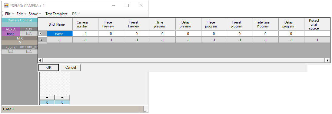

The camera control device allows for recalling camera shots (and pre-programmed moves) when the template is cued in preview or aired in program. The device editor supports salvo recalls of shots by adding multiple lines for each shot recall.
The Standard Robotic Camera Control Properties are described below, as well as exceptions for specific camera types.
Guidelines for Standard Robotic Camera Control Configuration
Shot Name | Not used. |
Camera number |
Preview | The exact meaning and format of the Preview fields depend on the type of camera robotics. (See the sections below.) These following three fields govern what happens when the template is taken in preview. |
Page Preview | This field (together with Preset Preview below) determines the shot/move. |
Preset Preview | This field (together with Page Preview above) determines the shot/move. |
Time preview | This field (together with Preset Preview and Page Preview above) determines the duration of a move. |
Delay preview | Not used. |
Program | The exact meaning and format of the Program fields depend on the type of camera robotics. (See the sections below). These following three fields govern what happens when the template is taken to air. |
Page program | This field (together with Preset program below) together determine the shot/move. |
Preset program | This field (together with Page program above) together determine the shot/move. |
Fade time Program | This field determines the duration of a move. |
Delay program | Delay of move in Program (frames). Info: Only available for Vinten robotics systems |
Protect onair source | Protected video switcher cross-point. If the video switcher cross-point is On Air, the shot/move recall will be ignored. |

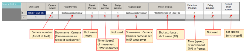

Electric Friends Robotic Camera
For Preview use:
Page Preview: Show and Robotic camera name separated with a colon (e.g.: ShowName:Cam 1).
Preset Preview [Optional]: Shot name. Shot attributes: prepare, prepareplay and loop. Separated with a colon (for example, prepare:ShotName and prepareplay:ShotName).
Time Preview [Optional]: Duration for move in frames. The time is rounded up to the nearest second.
For Program use:
Page Program: Show and Robotic camera name separated with a colon (e.g.: ShowName:Cam 1).
Preset Program [Optional]: Shot name. Shot attributes: prepare, prepareplay and loop. Separated with colon (for example, prepare:ShotName and prepareplay:ShotName).
Fade time Program [Optional]: Duration for move in frames. The time is rounded up to the nearest second.

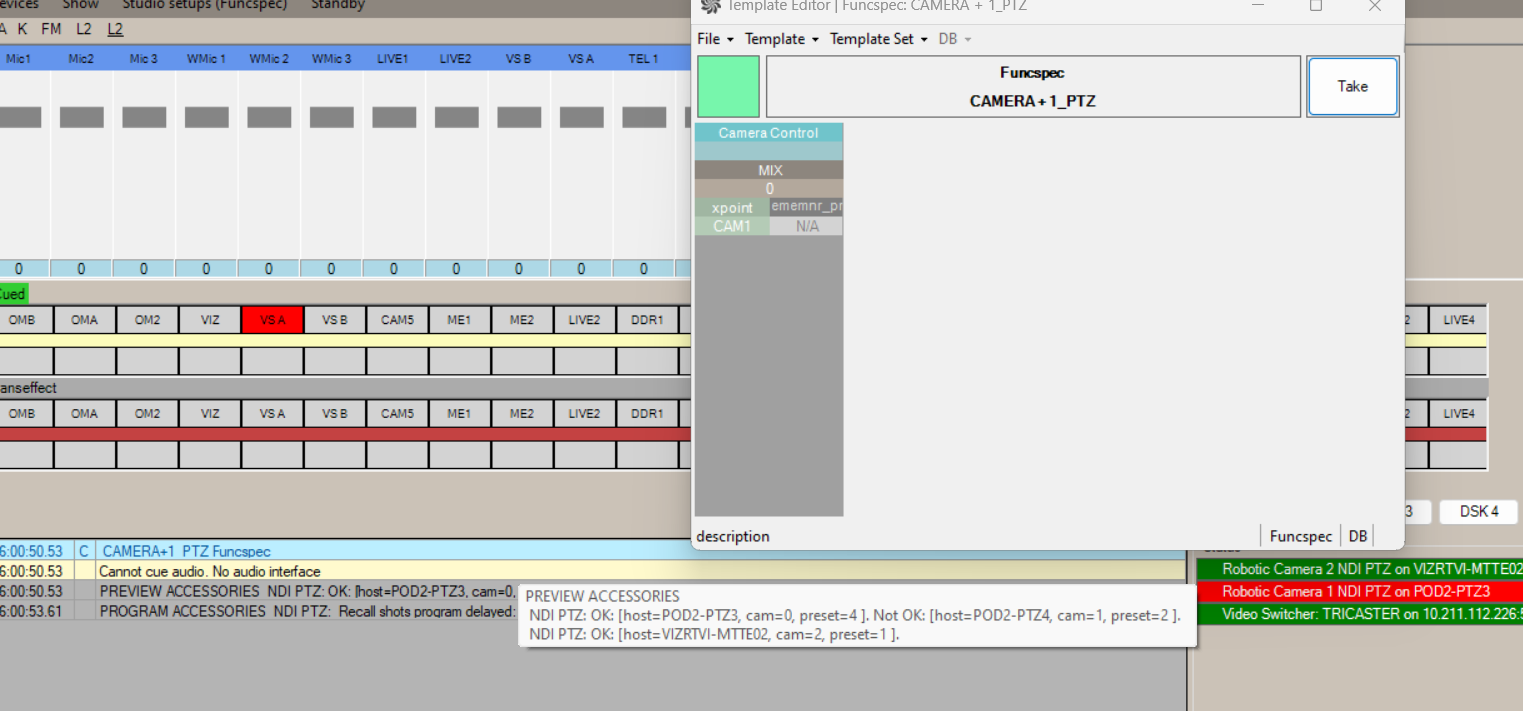

Example: Setting up a Template with Camera Control Device Enabled
This example demonstrates configuring a template for a Camera Control device using an NDI PTZ camera. Whilst the steps are specific to NDI PTZ cameras, a similar setup applies to other camera types.
Depending on the camera model and its supported features, slight adjustments in the configuration may be required.
We assume the following setup is configured as described in section Camera Robotics (under Device Properties):
POD2-PTZ3 and VIZRTV-MTTE02 are connected.
POD2-PTZ4 is currently disconnected.

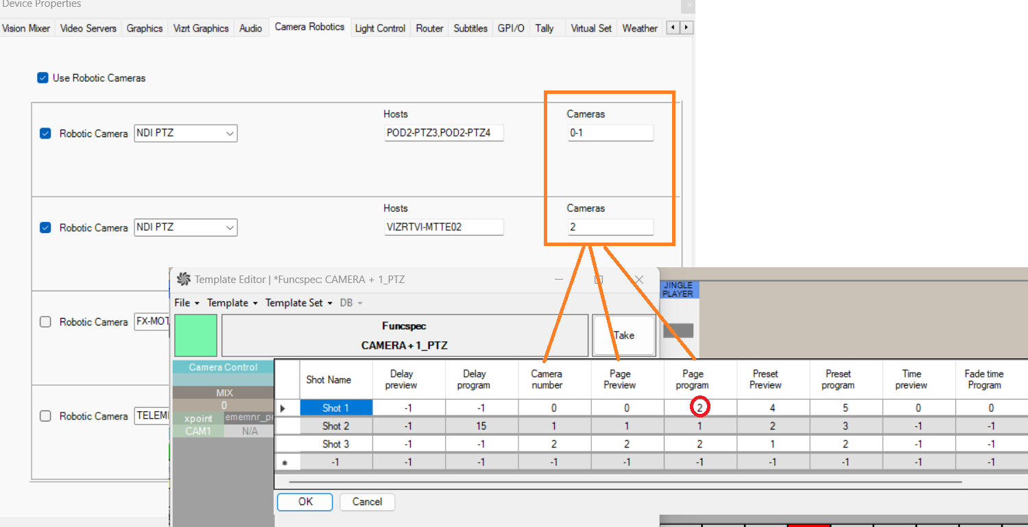

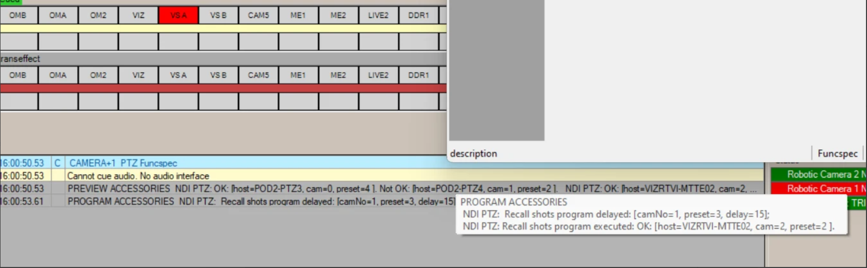

On a Mosart template, we have the following shots for a Camera Control device:
In the screenshot above, based on the numerical input Cameras, shots 1 and 2 will be executed by the first robotic camera controller, while shot 3 will be executed by the second robotic camera controller.
Shot 1:
Cameras number is set to 0, meaning the shot will be applied to the first controller configured, as 0 is within the range 0-1 set in the Cameras field.
Page Preview is set to 0, meaning Preset 4 (in field Preset Preview) will be applied to camera POD2-PTZ3 in Preview.
Page program is set to 2, which is outside the range 0-1, so the preset will not be applied in Program.
Shot 2:
Camera number is set to 1, meaning the shot will also be applied to the first controller, as 1 is within the range 0-1 set in the field Cameras.
Page Preview is set to 1, meaning Preset 2 will be applied to camera POD2-PTZ4 in Preview.
Page Program is set to 1, meaning Preset 3 will be applied to camera POD2-PTZ4 in Program, but with a delay of 15 frames.
Shot 3:
Camera number is set to 2, meaning the shot will be applied to the second controller configured, as the number matches the value set in the field Cameras.
Page Preview is set to 2, meaning Preset 1 will be applied to camera VIZRTV-MTTE02 in Preview.
Page Program is set to 2, meaning Preset 2 will be applied to camera VIZRTV-MTTE02 in Program.
In other words, the following moves were executed in Preview (note that camera POD2-PTZ4 is disconnected):
and the following moves were executed in Program (again, note that POD2-PTZ4 is still disconnected, the shot will not be executed. This event also appears in the technical logging):

Light Control
Info: The commands to use are driver-dependent and may vary.
Guidelines for Light Control Configuration
Option | Description |
PREVIEW COMMAND | Command to use for the light mixer cue to be recalled when template is cued in Preview. Info: Newsroom tag available. |
PREVIEW VALUE | Light mixer cue to use when template is cued in Preview. Info: Newsroom tag available. |
PROGRAM COMMAND | Command to use for the light mixer cue to be recalled when a template is taken in Program. Info: Newsroom tag available. |
PROGRAM VALUE | Light mixer cue to use when a template is taken in Program. Info: Newsroom tag available. |
Preview Command and Program Command options are available from the drop-down list.
For OSC drivers (grandMA3 or ETC Eos Family) messages will be parsed from Custom command text. See OSC parsing below.
Command | Parameter count | ||||||||||||||||||||||||||||||||||||||||||||||||||||
AllOff | <none>. For details, see Set below. | ||||||||||||||||||||||||||||||||||||||||||||||||||||
Fire | 1.For details, see Set below. | ||||||||||||||||||||||||||||||||||||||||||||||||||||
Go | cue number. For details, see Set below. | ||||||||||||||||||||||||||||||||||||||||||||||||||||
GoOff | cue number. For details, see Set below. | ||||||||||||||||||||||||||||||||||||||||||||||||||||
Load | cue number. For details, see Set below. | ||||||||||||||||||||||||||||||||||||||||||||||||||||
NoteOff | numeric note # (Std. MIDI command). For details, see Set below. | ||||||||||||||||||||||||||||||||||||||||||||||||||||
NoteOn | numeric note # (Std. MIDI command). For details, see Set below. | ||||||||||||||||||||||||||||||||||||||||||||||||||||
Reset | <none>. For details, see Set below. | ||||||||||||||||||||||||||||||||||||||||||||||||||||
Restore | <none>. For details, see Set below. | ||||||||||||||||||||||||||||||||||||||||||||||||||||
Resume | variable. For details, see Set below. | ||||||||||||||||||||||||||||||||||||||||||||||||||||
Set | The value of SET is presented below in the context of Midi Show Control Specifications
Info: You can include an optional time value (key/value[/time]), in the form: key=value@hh:mm:ss:ff If unexpected program conditions occur, use a (dummy) time parameter. | ||||||||||||||||||||||||||||||||||||||||||||||||||||
Stop | cue number. For details, see Set above. | ||||||||||||||||||||||||||||||||||||||||||||||||||||
Custom | SysEx bytes Send multiple custom SysEx bytes in the format | ||||||||||||||||||||||||||||||||||||||||||||||||||||
TimedGo | - (unsupported). For details, see Set above. |

Examples (for illustration only; always refer to MA documentation):
/cmd, s, Echo word
/cmd, s, "Echo \",1\""
/Page1/Fader201, i, 100
/someAddress, sis, Flash, 1 , Strobe 1 Cue 1
ETC Eos family
The text before the first equals sign will be taken as OSC address; for example: [/eos/group/1/param/pan/tilt]
The rest of the text value will be interpreted as a list of OSC arguments, separated by commas; for example: [5, 10]
Quoted texts will be parsed as one argument. Quotes can be escaped with “\“, and backslashes can also be escaped by “\“. Example: [5, text, “2 words“, “text with \\ backslash“]
Arguments will be parsed first as int32. If that fails, then float32, and if that also fails, as string.
Supported OSC Types
int32 (i)
float32 (f)
OSC-string (s)
Examples (for illustration only; always refer to ETC documentation):
/eos/preset/fire=1
/eos/group/1/param/pan/tilt=90,75
/eos/cmd=”Chan 1 At 75"

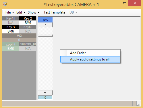

Add audio faders to the template by right-clicking in an empty part (large grey area to the left) of the audio fader area and selecting Add fader.
Set the audio mixer crosspoint from the drop-down menu by clicking the label at the top of the fader.
Note: Clicking Apply audio settings to all applies all the changes to all templates of the same type and variant throughout all template sets.

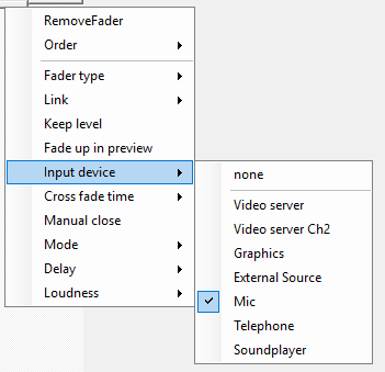

To configure a fader
Right-click over the fader to open the context menu and follow the Guidelines below.

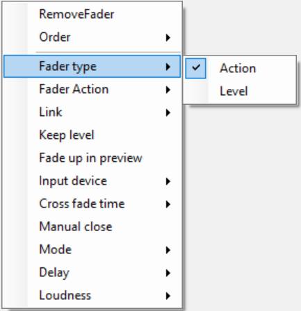

Guidelines for Audio Fader Configuration
Remove Fader | Removes the fader from the template. | ||||||||||||||||||||||||
Order | Rearranging the order:

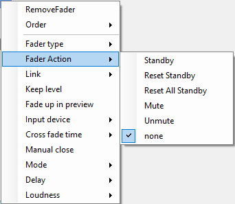

Fader type | Action: When a fader control is set as an Action fader, the controls define whether the fader is enabled or disabled. Level: For standard audio operation. | ||||||||||||||||||||||||
Fader Action |
Link | Assigns a video/audio link group to this fader.
Keep level | Keeps the fader level until manually changed. | ||||||||||||||||||||||||
Fade up in preview | Fades up the audio in preview, when camera is in program. Enabling this functionality only works with specific template combinations, as shown below:
Input device | Sets the type of the audio fader.
Crossfade time | Sets the in and out crossfade time (in video frames) for the fader.
Manual close | Select to ignore sending Close-level commands to audio mixer. | ||||||||||||||||||||||||
Mode | Only for Studer Vista and Lawo! Sends the chosen value to the mixer board for the audio fader.
Delay | Only for Studer Vista, Studer 3000 using Ember and Lawo RMNOPL! Gives a delay value (in milliseconds) for that audio fader that will be sent to the audio board.
Loudness | Sends chosen recall value to send to the Jünger audio processor.
