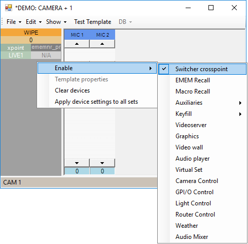

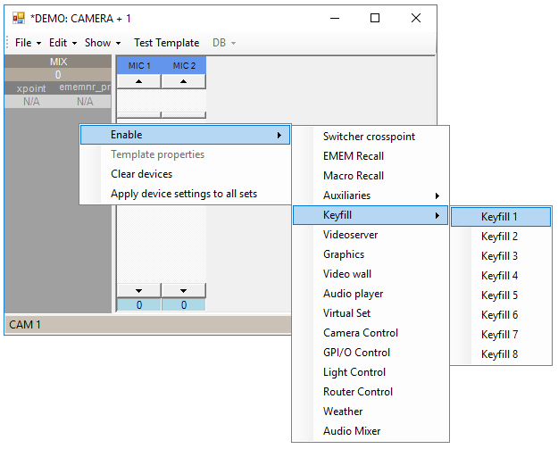

Working with Device Functions

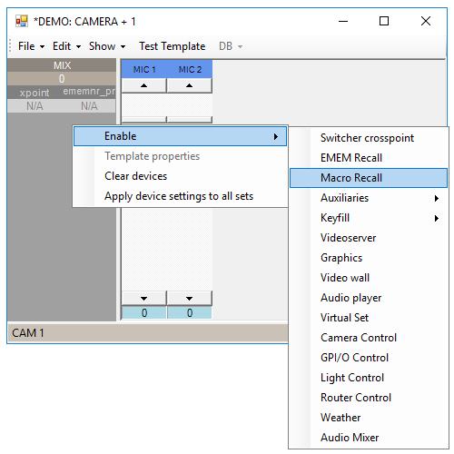

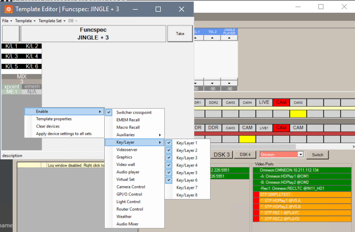

Right-click inside the device function area to open a menu containing the following options:
  • Enable: These commands are described in more detail below.
  • Template properties: Opens the current template's properties page, see Template Properties in section Working with Templates.
  • Clear devices: Removes all devices from the device function menu, after confirming in a pop-up message window.
  • Apply device settings to all sets: Applies all the device settings to all templates of same type and variant throughout all template sets.
  • Mark as intentionally empty: This option is available for empty templates only and shows up when the Use ‘Mark template as empty’ feature is enabled in Settings Editor MOS-General. See Empty Templates for more details.

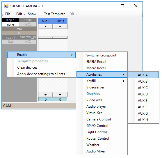

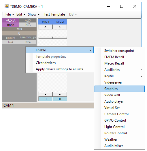

To enable device functions
  1. Right-click in the device's Function area (black row).
  2. Select the device to configure from the Enable menu.
    This opens the Edit box for the selected device.
Info: Depending on the protocol chosen, the caption EMEM Recall may alternatively be:
  • Emem Recall
  • Dmem Recall
  • Snapshot Recall
  • Memory Recall
To modify device functions
  2. Select Device properties. See the topics below for listings of properties for each device.
Info: Depending on the Protocol chosen, the caption Macro Recall may alternatively be:
  • Custom Control
To remove device functions
  1.  Right click in the Device function area
  2. De-select it from the Enable menu.

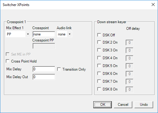

Video Switcher Crosspoint
The video switcher crosspoint enables switching on the video switcher. The A or B bus assignment of the mixer effect (PP/MEx) is automatically handled by the automation.
Guidelines for Video Switcher Crosspoint Configuration
Item
Description
Mix Effect
Selects which Mix Effect (ME) bank on your vision mixer that you are currently handling.
Note : Newsroom tag available.
Info: For vMix, PP maps to the main vMix output. ME1 maps to the first Mix input, ME2 to the second, and so on.
Info: For ATEM, both PP and ME1 map to the same physical ME1 on the switcher. The difference is only relevant for keyfills. See Guidelines for Keyfill Configuration below.
Crosspoint
Crosspoint on the video switcher. Default value: none
Info: Newsroom tag available.
Audio link
Default value: none
Crosspoint PP
If another Mix Effect (ME) than PP is selected, then you can select a crosspoint for program by writing the crosspoint name in the field.
Set ME in PP
If another Mix Effect (ME) than PP is selected, check this box to make that ME the crosspoint for PP. (Checking this box disables XPOINT PP).
Cross Point Hold
Keeps the crosspoint on the selected Mix Effect.
Mix Delay
Offset, in frames, of when to perform the transition.
Mix Delay Out
Delay, in frames, of when to perform the next transition.
Transition Only
Only delay the switcher transition (sub items will perform).
DSK Off
Turns off the Downstream Keyer (DSK) on the video switcher when the template is active in program.
The keyer selected as DSK in the switcher device property (Devices > Properties > Vision Mixer >  selected DSKNr), will be used.
DSK 2 On, ...,
DSK 8 On
Downstream Keyer (DSK) 2-8 on. Turns on the DSK 2-8 (PP key 2-8) on the video switcher when the template is active in program.
Off delay
Delay in frames to set the DSK 2-8 off.

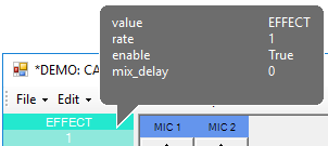

Video Switcher Transition
The transition device is only available when video Switcher crosspoint is enabled.
To define video switcher transitions
This procedure is based on the example in the screenshot.
  1. Click on MIX/WIPE/EFFECT to cycle through these three transition types.
  2. Click directly on the selected value (in the screenshot above, this is either 0 or 1).
  3. Enter
    1. The default duration (in frames) for the Mix/Wipe transition, or
    2. The effect number for the effect transition.
The transition is performed with the auto-transition functionality in the video switcher.
Usage and Tips
  • To add a cut: Use a MIX transition with 0 frames duration.
  • To add a mix delay:
    Right-click on the device (MIX/WIPE/EFFECT), select the number (below Disable), and enter another number (in frames).
    Adding a mix delay delays the start of the transition, compared to other device commands, when the template goes On Air.
  • To disable a transition:
    Right-click over the device and select Disable.

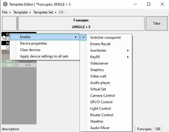

Video Switcher Register/Timeline Recall

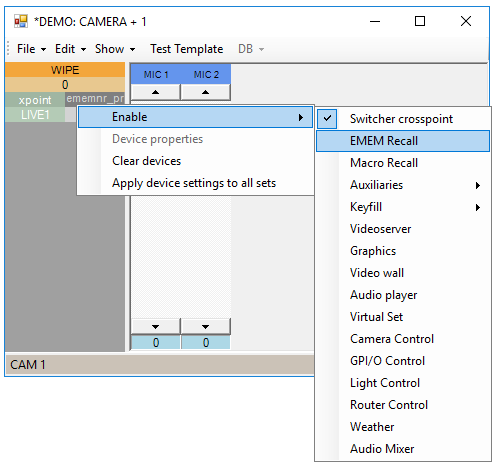

Video Switcher Register/Timeline Recall (EMEM Recall/Emem Recall/Dmem Recall/Snapshot Recall/Memory Recall) will recall a register and/or timeline in the video switcher.
To open the video switcher Register/Timeline recall
  1. Open Template Editor.
  2. Right-click over ememnr_pr
  3. Select Enable > EMEM Recall
  4. Enter or select required values
Info: If a Register recall is paired with the video switcher key bus delegation and/or auxiliary bus delegation, the key/aux bus delegation should be disabled in the Video Switcher Register to prevent a conflict between the stored delegation and the Viz Mosart-assigned delegation.

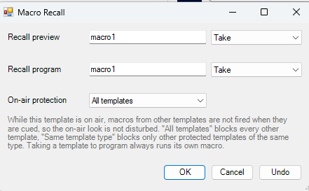

Macro Recall
Macro Recall is available with the following vision mixer protocols (selected in the configuration menu AV Automation Devices Vision Mixer):
  • Ross Acuity
  • Ross Carbonite
  • GV CPL
  • GV KAHUNA (Kahuna/Kula)
  • SONY SERIAL TALLY
  • TriCaster
  • ATEM
  • vMix
To open a Macro Recall
  2. Navigate to Enable > Macro Recall
  3. Enter or select required values.
Guidelines for Macro Recall Configuration
Item
General description
Drop-down
Text field
Recall preview
Action to be taken when entering preview mode.
See below
See below
Recall program
Action to be taken when entering program mode.
See below
See below
On-air protection
Prevents macros in other templates from changing the on-air look while this template is on air.
See below
N/A

Drop-down option
Description
Off
No protection. Macros always run as configured. This is the default.
All templates
While this template is on air, a macro in any other template is not fired when that template is cued.
Same template type
While this template is on air, a macro is not fired when a template of the same type, for example another DVE, is cued and also has on-air protection enabled. Templates of other types are not affected.

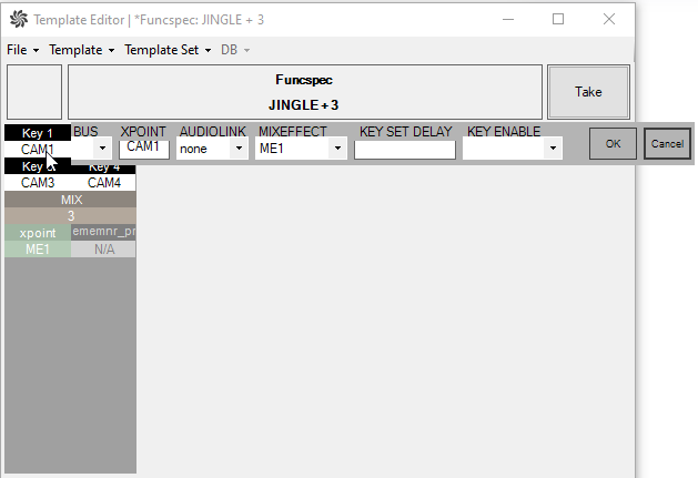

Video Switcher Auxiliary Bus Delegation
Auxiliary bus delegation enables routing of internal video switcher signals to the auxiliary outputs of your video switcher.
Info: TriCaster video switcher uses NDI outputs, not auxiliaries. On the template, the Auxiliaries device is instead displayed as NDI Router Output.
  • Type or select relevant values.
Guidelines for Auxiliary Bus Delegation Configuration
Item
Description
BUS
Selects the auxiliary to assign a new source.
Info: For vMix, bus 1 corresponds to vMix Output 2, bus 2 to Output 3, and so on.
vMix Output 1 is the main program output and cannot be reassigned by external applications like Mosart.

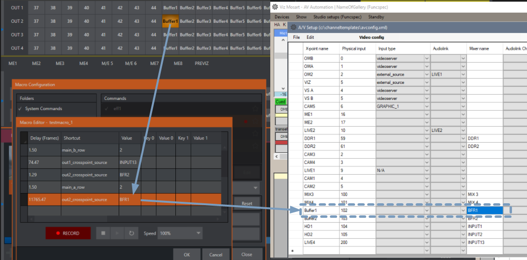

Router source memory
Viz Mosart uses an internal AUX memory logic, where Mosart always stores the last crosspoint set on a specific AUX. If this AUXx is used as a source (rather than a destination) Mosart uses the source stored in memory. In the Template Editor, checking the Source drop-down list for a switcher crosspoint reveals at the bottom a list (that is automatically added appended) of AUXx sources. These refer to the internally stored AUX sources.
A similar logic applies to router crosspoints. However, the AUXx sources displayed in the switcher crosspoint Source drop-down, are not automatically shown in the router sources drop-down. Add them manually to the Router Source table in AVconfig, for the AUX memory logic to operate.
Info:
  • The source named shall not contain special characters (for example dash - or underscore _).
  • Naming in the form AUX 9 or AUX9 (without space) is recommended.
  • Using names like AUX-9 or AUX_9 will cause Mosart to ignore the memory logic and instead use the newly provided source identity.
Configuring an NDI Router (Viz Vectar Plus or Tricaster VMC)
Info: For NDI output crosspoints, you must refer to actual crosspoint names recognized by VMC1 (and not any user-friendly names that would be mapped to the physical inputs).
These default naming on the NDI router side is typically:
- INPUTn
- DDRn
- BFRn
- MIX n.
The same naming must be used on the Viz Mosart side.
In AV Automation > Devices > A/V Setup > Video Config > Mixer name column, you must provide the hardcoded name associated with the user-friendly name of the crosspoint.
This name is found on the switcher side.
In the example below, the value of the literal crosspoint name is the router output found in the switcher's Macro Configuration > Macro Editor menu and added to AV Automation:
There is a new setting UseOutputCrosspointNames in the IP-protocol config VizrtIpSystemsVideoSwitcherConfig.xml set by default to expect the crosspoint name, instead of the Viz Mosart standard of using physical input naming.
Keyfill: Video Switcher Key Bus Delegation
Video switcher key bus delegation enables routing of internal video switcher signals to the keyers on the different mixer effects of the switcher.
Info: For TriCaster video switcher supporting M/E effects with 4 layers, the device is named Key/Layer.
To enable Keyfill by bus delegation
  2. Navigate to Enable > Keyfill > [Keyfill index]
To enable Keyfill by bus delegation for M/E effects with 4 layers
Devices like Vizrt’s TriCaster family TriCaster Plus or VMC1 let you configure M/Es with effects supporting up to four primary sources/input layers (along with Key layers), called A, B, C and D buses.
Viz Mosart can control these buses from a template or keyboard shortcut when TriCaster is used as a vision mixer.
  2. Navigate to Enable > Key/Layer > [KeyLayer index]
    The Key/Layer device on a template can be used for VMC1 vision mixer to either set the crosspoint for a Key bus or to set the crosspoint for  A, B, C and D buses of a M/E effect with 4 layers.
  3. Right-click > Device properties.
    Select from the BUS drop-down menu:
    1. If the device is used for setting the crosspoint for a key bus, set the BUS drop-down menu to a number between 1 and 8 on the Key/Layer device properties.
    2. If the device is used for setting the crosspoint for a layer of a M/E effect with 4 layers, then choose one of the letters  A, B, C and D from the BUS drop-down menu.
Item
Description
BUS
Selects the key bus on the selected ME.
If the video switcher supports M/Es with four layers (for example Vizrt’s TriCaster family), four more buses are available corresponding to each layer, A, B, C and D:
If the switcher is Ross Acuity, the number of buses is 16 where the first 8 are used for the selected mixer region keyers and the next 8 buses target the second channel of the keyers.
For example, Bus 9 on ME1 can be used to set the source on the second channel of Key 1 of ME1.
XPOINT
AUDIOLINK
Assigns a link group to this delegation. Please refer to Audio and Video Setup (previously Linking video and audio sources) for the use of this feature.
MIXEFFECT
Select the ME where the key crosspoint should be set.
PP targets downstream keyers (DSKs), while ME1 targets upstream keyers.
KEY SET DELAY
Set the delay in frames of the key delegation when taking the template to a program. If the field is left blank the key is set in preview.
KEY ENABLE
Key enable drop-down menu.

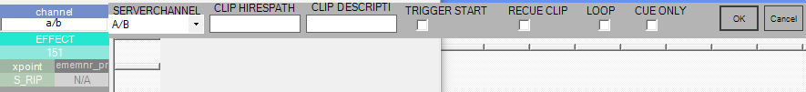

Video Server
Guidelines for Video Server Configuration
Setting
Description
SERVERCHANNEL
The Mosart video port / port group where the clip is to be played out /recorded.
For recording the corresponding video port has to be part of the “Rec” port group.
Port groups are created as part of the video server configuration in menu AV Automation > Devices > Preferences.
Configurations are described in Video Servers, section Working with Mosart Port Configurations.
Notably, the defined virtual ports are among the available options.
In addition, the non-empty groups (groups with at least one port) are available.
If a group has the same name as one of its ports (as may be the case for the Rec and P groups, if defined), the group as such is not available, but the port is.
CLIP HIRESPATH
The (default) clip ID or name.
Info: Newsroom tag available, meaning that a value from the NRCS will override the value specified here.
CLIP DESCRIPT
You can enter a Clip description, however a clip description from the NRCS or video server overrides this value.
TRIGGER START
Enables the Trigger start function from control command TRIGGER_START, a shortcut or continue point could be set to PLAY the Clip.
RECUE CLIP
In an A/B roll situation, when several Adlibs are played back-to-back, this setting determines how a clip will be restarted after it has been paused.
For example, if Clip A is paused when Clip B is taken On Air, then next time Clip A is taken on the same channel, it can either be played from where it was paused, or be re-cued (played from the beginning).
This is only used for AdlibPix templates.
LOOP
Sets the server port to loop the clip. Beware! Not all video servers can loop.
CUE ONLY
(Intended for Accessory and Package templates)
Cues only the clip when the template is in Preview. The template will not start playing the clip when the template is taken.

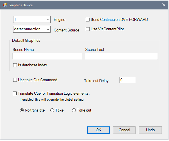

Graphics
The Graphics device enables recall of graphic elements.
  •  Graphic elements are cued (loaded) in Preview and played (started) when taken to Program.
Guidelines for Graphics Configuration
Engine
Selects the engine to operate on when using this template, based on your configuration.
See section Graphics.
Content Source
  • dataconnection: Use content from the attached graphics database (only available when Vizrt graphics are used)
  • newsroom: Use content from the attached NRCS.
  • none: Use content written into the template.
Send Continue on DVE FORWARD
If selected, a continue command is sent together with a DVE Forward command.
Use VizContentPilot
Enable to run this element through a Viz Pilot client. This allows for OnLiveUpdate events in Viz Pilot data elements.
Scene Name
The default scene name is used, if not overridden by the NRCS.
Scene Text
The default scene text will be used, if not overridden by the NRCS.
Is database Index
Use take Out Command
If selected, a take-out command is sent when the template status changes from On Air to Off Air.
Take Out Delay
Delay of sending takeout command after template status changes from On Air to Off Air.
Translate Cue for Transition Logic elements
If active, this setting overrides the global setting with same name set in AV Automation > Devices > Properties > Graphics > General > [VIZRT] > Miscellaneous.
This setting only applies to transition logic for Vizrt full screen graphics. The Media Sequencer ignores standard cue command for these items.
  • No translate: Send cue command to the Media Sequencer (on Media Sequencer versions below 1.20 no cue will be performed).
  • Take: Use a Take command when cuing.
  • Take out: Use a Take out command when cuing.

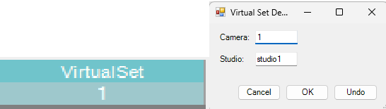

Virtual Set
Viz Virtual Studio :
  • Camera : Preset router index number to recall in Viz Tracking Hub currently loaded studio configuration
  • Studio : Studio configuration name to recall in Viz Tracking Hub
Info: For Vizrt's virtual set manager, Viz Arc, please refer to section Viz Arc support within a Mosart show.

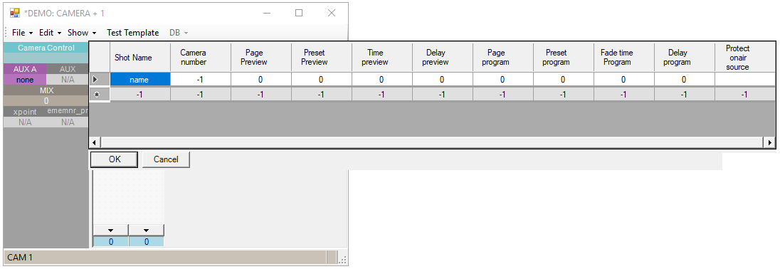

Robotic Camera Control
The camera control device allows for recalling camera shots (and pre-programmed moves) when the template is cued in preview or aired in program. The device editor supports salvo recalls of shots by adding multiple lines for each shot recall.
The Standard Robotic Camera Control Properties are described below, as well as exceptions for specific camera types.
Guidelines for Standard Robotic Camera Control Configuration
Shot Name
Not used.
Camera number
  • -1 : Shot is sent to all cameras that are not in standby.
  • >=0 : Shot is sent to the camera with the same number. The number refers to those given in the Cameras fields in AV Automation > Devices > Camera Robotics.
Preview
The exact meaning and format of the Preview fields depend on the type of camera robotics. (See the sections below.) These following three fields govern what happens when the template is taken in preview.
Page Preview
This field (together with Preset Preview below) determines the shot/move.
Preset Preview
This field (together with Page Preview above) determines the shot/move.
Time preview
This field (together with Preset Preview and Page Preview above) determines the duration of a move.
Delay preview
Not used.
Program
The exact meaning and format of the Program fields depend on the type of camera robotics. (See the sections below). These following three fields govern what happens when the template is taken to air.
Page program
This field (together with Preset program below) together determine the shot/move.
Preset program
This field (together with Page program above) together determine the shot/move.
Fade time Program
This field determines the duration of a move.
Delay program
Delay of move in Program (frames).
Info: Only available for Vinten robotics systems
Protect onair source
Protected video switcher cross-point. If the video switcher cross-point is On Air, the shot/move recall will be ignored.
For Technodolly, this protection can be confined to Preview and/or Program, and to Cuts and/or Moves.
Info: Newsroom tags are available on every column of the Robotic Camera Control device — Shot Name, Camera number, the Page, Preset, Time and Delay columns for both Preview and Program, Fade time Program, and Protect onair source. Right-click a cell and select Add newsroom tag; see Linking Device Properties and Newsroom Tags. These are free-text fields in the NRCS.

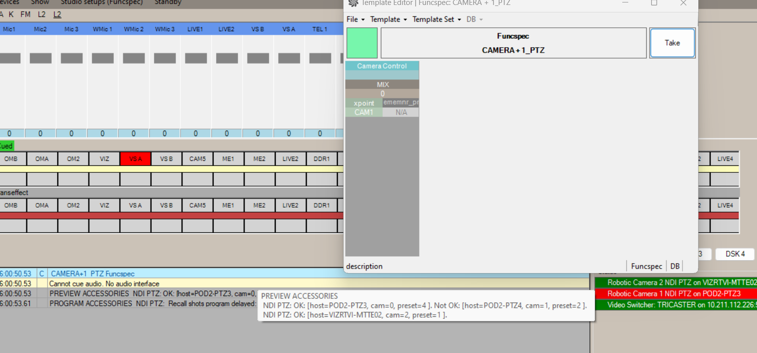

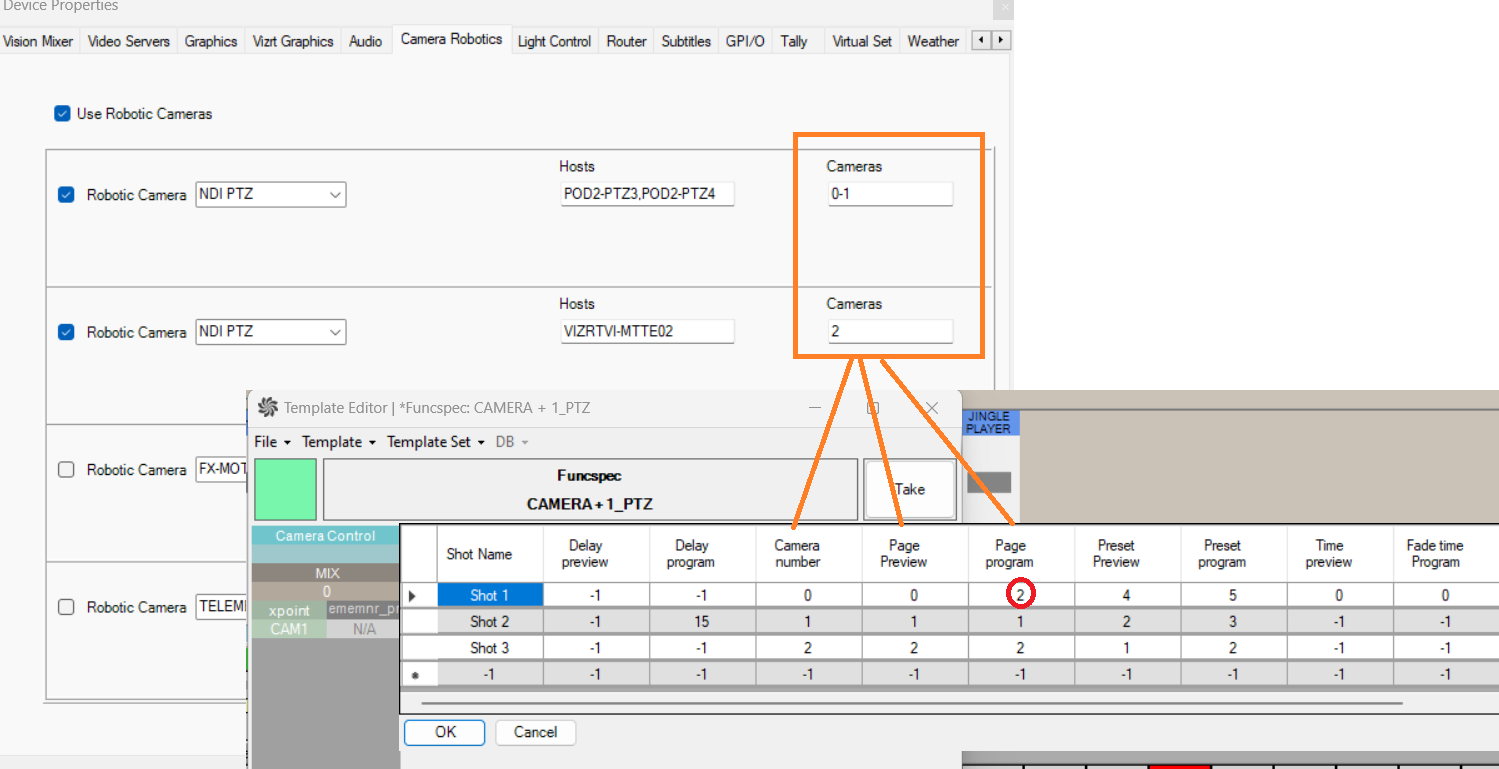

NDI PTZ Properties
  • Camera Number: A number as configured in the Cameras field for a robotic camera controller (see section Camera Robotics). This is used by Mosart to filter the shots for execution by a camera robotic controller.
    If value -1 is set, the shots will be executed for all controllers are not in stand-by, as configured in AV Automation Device Properties.
  • Page Preview/Page program: A number as configured in the Cameras field for a robotic camera controller (see section Camera Robotics). This identifies the exact camera for which the shot will be executed.
    As long as the Camera number is greater or equal than 0, a number within the range of cameras supported for that controller should be set for either Page Preview or Page Program.
  • Preset Preview/Preset program: Name of shot or move to recall.
  • Delay preview: Not supported.
  • Delay program: Delay of move in Program (in frames).

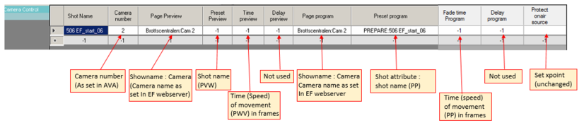

Electric Friends Robotic Camera
For Preview use:
  • Page Preview: Show and Robotic camera name separated with a colon (e.g.: ShowName:Cam 1).
  • Preset Preview [Optional]: Shot name. Shot attributes: prepare, prepareplay and loop. Separated with a colon (for example, prepare:ShotName and prepareplay:ShotName).
  • Time Preview [Optional]: Duration for move in frames. The time is rounded up to the nearest second.
For Program use:
  • Page Program: Show and Robotic camera name separated with a colon (e.g.: ShowName:Cam 1).
  • Preset Program [Optional]: Shot name. Shot attributes: prepare, prepareplay and loop. Separated with colon (for example, prepare:ShotName and prepareplay:ShotName).
  • Fade time Program [Optional]: Duration for move in frames. The time is rounded up to the nearest second.

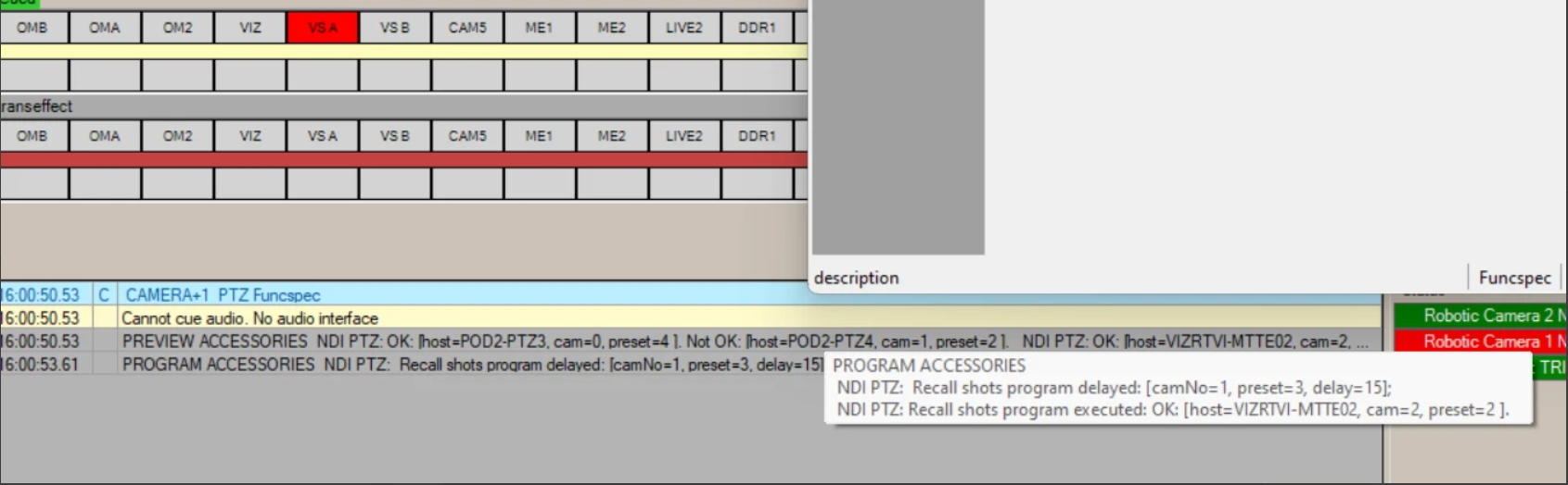

Example: Setting up a Template with Camera Control Device Enabled
This example demonstrates configuring a template for a Camera Control device using an NDI PTZ camera. Whilst the steps are specific to NDI PTZ cameras, a similar setup applies to other camera types.
Depending on the camera model and its supported features, slight adjustments in the configuration may be required.
We assume the following setup is configured as described in section Camera Robotics (under Device Properties):
  • POD2-PTZ3 and VIZRTV-MTTE02 are connected.
  • POD2-PTZ4 is currently disconnected.
On a Mosart template, we have the following shots for a Camera Control device:
In the screenshot above, based on the numerical input Cameras, shots 1 and 2 will be executed by the first robotic camera controller, while shot 3 will be executed by the second robotic camera controller.
  • Shot 1:
    • Cameras number is set to 0, meaning the shot will be applied to the first controller configured, as 0 is within the range 0-1 set in the Cameras field.
    • Page Preview is set to 0, meaning Preset 4 (in field Preset Preview) will be applied to camera POD2-PTZ3 in Preview.
    • Page program is set to 2, which is outside the range 0-1, so the preset will not be applied in Program.
  • Shot 2:
    • Camera number is set to 1, meaning the shot will also be applied to the first controller, as 1 is within the range 0-1 set in the field Cameras.
    • Page Preview is set to 1, meaning Preset 2 will be applied to camera POD2-PTZ4 in Preview.
    • Page Program is set to 1, meaning Preset 3 will be applied to camera POD2-PTZ4 in Program, but with a delay of 15 frames.
  • Shot 3:
    • Camera number is set to 2, meaning the shot will be applied to the second controller configured, as the number matches the value set in the field Cameras.
    • Page Preview is set to 2, meaning Preset 1 will be applied to camera VIZRTV-MTTE02 in Preview.
    • Page Program is set to 2, meaning Preset 2 will be applied to camera VIZRTV-MTTE02 in Program.
In other words, the following moves were executed in Preview (note that camera POD2-PTZ4 is disconnected):
and the following moves were executed in Program (again, note that POD2-PTZ4 is still disconnected, the shot will not be executed. This event also appears in the technical logging):

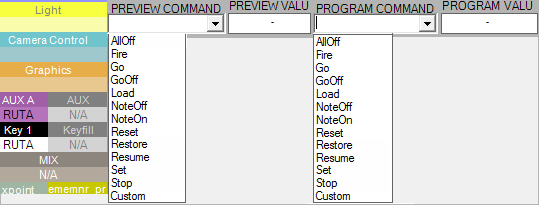

Light Control
Info: The commands to use are driver-dependent and may vary.
Guidelines for Light Control Configuration
Option
Description
PREVIEW COMMAND
Command to use for the light mixer cue to be recalled when template is cued in Preview.
PREVIEW VALUE
Light mixer cue to use when template is cued in Preview.
PROGRAM COMMAND
Command to use for the light mixer cue to be recalled when a template is taken in Program.
PROGRAM VALUE
Light mixer cue to use when a template is taken in Program.
Preview Command and Program Command options are available from the drop-down list.

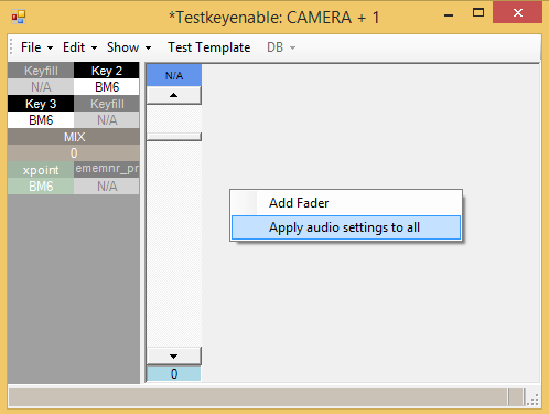

To add audio faders
  1. Add audio faders to the template by right-clicking in an empty part (large grey area to the left) of the audio fader area and selecting Add fader.
  2. Set the audio mixer crosspoint from the drop-down menu by clicking the label at the top of the fader.
Note: Clicking Apply audio settings to all applies all the changes to all templates of the same type and variant throughout all template sets.

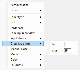

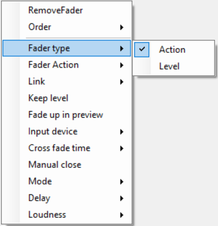

To configure a fader
  • Right-click over the fader to open the context menu and follow the Guidelines below.

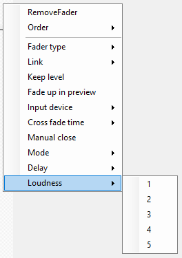

Guidelines for Audio Fader Configuration
Remove Fader
Removes the fader from the template.

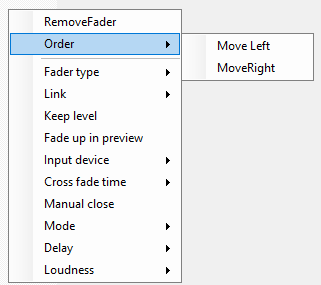

Order
Rearranging the order:
  • Move Left
  • Move Right

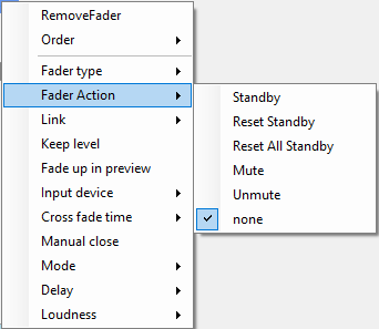

Fader type
Action: When a fader control is set as an Action fader, the controls define whether the fader is enabled or disabled.
Level: For standard audio operation.
Fader Action
  • Standby: Fader is placed in standby
    (A fader in standby ignores any commands sent to it via a template)
  • Reset Standby: Fader is placed in a non-standby status
  • Reset All Standby: All faders are placed in a non-standby status
  • Mute: Mute the fader
  • Unmute: Unmute the fader
  • none: Take no action
Link
Assigns a video/audio link group to this fader.
  • none
  • 1
  • 2
  • 3
  • 4
  • 5
  • 6
  • 7
  • 8
Keep level
Keeps the fader level until manually changed.
Enabled to let the automation open the audio fader, leaving it open until is is closed from another template, or the Viz Mosart client operator closes it with the FADE_OUT_KEEPS control command (recalled from an Audio keyboard shortcut).
Fade up in preview
Fades up the audio in preview, when camera is in program.
To let the audio fader open when the template is cued in program, set to enabled.
Enabling this functionality only works with specific template combinations, as shown below:
Program
Preview (with Fade up in preview enabled)
Result
CAMERA
LIVE
(tick)
DVE
(tick)
TELEPHONEINTERVIEW
(tick)
PACKAGE
(tick)
Other Templates
(error)
Other Templates
PACKAGE
(tick)
Other Templates
(error)

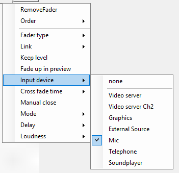

Input device
Sets the type of the audio fader.
The setting is used in combination with primary template type and On Air status to identify which fader should be treated as secondary audio.
This special handling is applied to the types below:
  • none: No special treatment.
  • Video server: The fader controls a video server channel audio output.
  • Video server Ch2: The fader controls a second video server channel audio output.
  • Graphics: The fader controls audio output from the Graphics Engine.
  • External source: The fader controls an external audio source.
  • Mic: The fader controls a studio microphone.
  • Telephone: The fader controls a telephone hybrid.
  • Soundplayer: The fader controls the Mosart Audio Player output.
Crossfade time
Sets the in and out crossfade time (in video frames) for the fader.
  • In
  • Out
Manual close
Select to ignore sending Close-level commands to audio mixer.
When selected, sending the Take out for the fader at the end of the element is ignored; The fader has to be manually taken down.

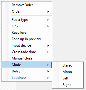

Mode
Only for Studer Vista and Lawo!
Sends the chosen value to the mixer board for the audio fader.
  • Stereo (not for LAWO EMBER+)
  • Mono (not for LAWO EMBER+)
  • Left (LAWO EMBER+: Stereo faders only)
  • Right (LAWO EMBER+: Stereo faders only)

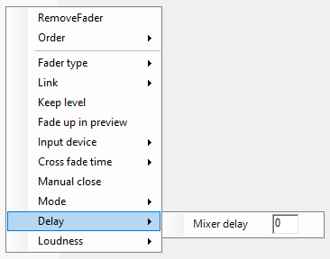

Delay
Only for Studer Vista, Studer 3000 using Ember and Lawo RMNOPL!
Gives a delay value (in milliseconds) for that audio fader that will be sent to the audio board.
  • Mixer delay. Default: 0
Loudness
Sends chosen recall value to send to the Jünger audio processor.
  • 1
  • 2
  • 3
  • 4
  • 5
