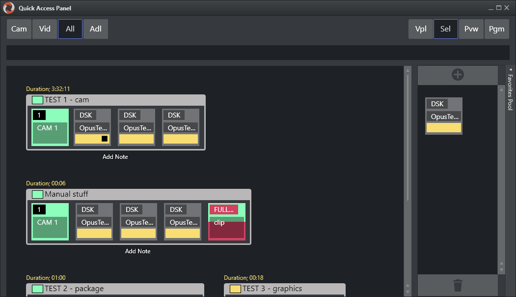

The Quick Access Panel
  • Makes it easier for a Producer making a dynamic rundown. It can also be a convenient way for Co-producers or Co-pilots to add more content to a rundown, while the Producer runs the show.
  • Shows all the executable control elements of the entire rundown, as buttons grouped by their originating stories.
  • Includes modifiable Story Filters, in the example above Cam, Vid and All.
    The Producer or Co-pilot can filter to find specific elements, for example only cameras, which they can then modify in a running rundown.
The Quick Access panel can be displayed and operated separately from a second Viz Mosart client or as an standalone panel on the primary Viz Mosart client. The button size can be changed to suit typical screen sizes setups.

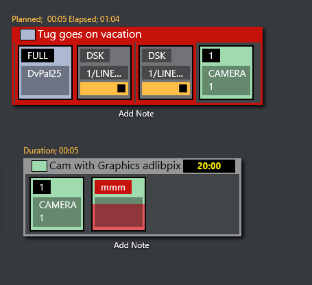

Story Item
Story Control
The Quick Access Panel shows each story as a rectangular box. Within the story box, each element and sub-element appear as a button. The story type is indicated in the story box header by color, corresponding to the type of story element.
The type of the story is determined by the elements it contains. Beneath the story box the user can add a description by clicking Add Note.
  • The story item is always displayed within a story.
  • The background of the button indicates the template type.
  • The heading indicates template variant.
    • A white text and red background as the template variant text indicates an unavailable template.
    • The transparent text shows the slug.
You can take items (for example, lower third, accessories, sound elements) On Air by clicking the button.
The button gets a red border and appears in the Program window. Take it Off Air by clicking the button again.
Info:
  • Clicking an item that already has gone Off Air, puts it back On Air again.
  • If the item has a fixed time, it goes Off Air autonomously.

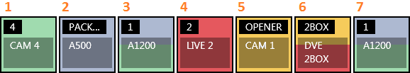

Primary Elements
  1. CAM: Camera
  2. PACKAGE: Video
  3. VO: Voice over
  4. LIVE: Live element
  5. GRAPHICS: Full screen graphic element
  6. DVE: Butterfly/DVE
  7. FLOAT
Secondary Elements
Secondary elements are shown with a gray background.
  1. LOWERTHIRD
  2. SOUND
  3. ACCESSORY

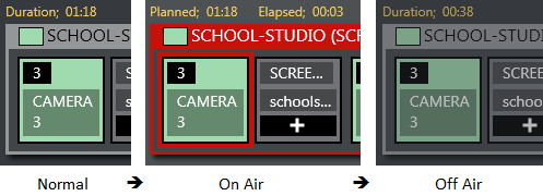

Story Status
If a story is On Air, its frame becomes red with a white font.
The item that is On Air also gets a red frame. When the story or story item has been On Air, it gets a denser color.
If a lower-third has continue points, a bubble appears on the right, indicating remaining continue points.
Story Timing Information
Timing information is shown on top of stories.
  • Duration (normal): How long the story is planned to last.
  • Planned (on air): The same as duration.
  • Elapsed: How long the story has been On Air.
  • Duration (off air): How long the story lasted.
  • Countdown (black box): Time until story is planned to go On Air.

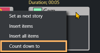

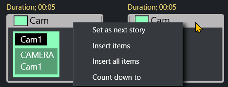

Quick Access Panel Context Menu
Clicking in an item title bar displays a context menu:
  • Set as next story: This story is set as next.
  • Insert items: Inserts all visible items (except floats) in the current order after the running item in the current story. If the command mode is Air Mode, the first item is taken directly.
  • Insert all items: Inserts all items (except floats) in the story after the running item in the current story. If the command mode is Air Mode, the first item is taken directly.
  • Count down to: Starts counting down to the first visible item in the story.

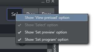

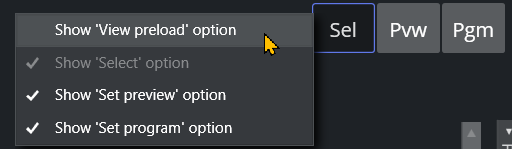

  • You select which command buttons are displayed by right-clicking any of the displayed buttons.

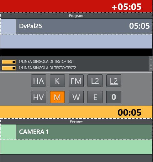

Sel - Select Mode
  • The selected item becomes the focused item.
This item can then be sent to preview, program or wall by selecting within the dotted line on the relevant control.

Info: This mode is hidden by default, activate it from the context menu by right clicking on any of the buttons:

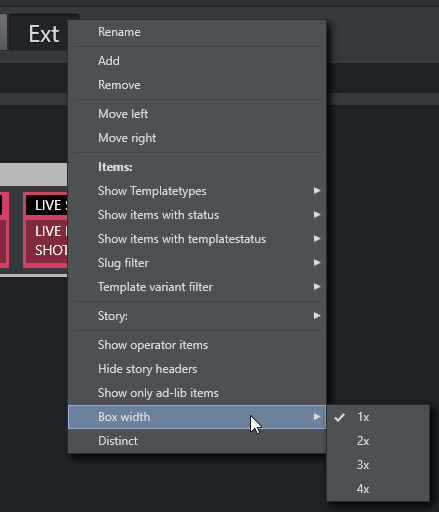

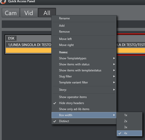

Filter Bar Context Menu
Right-clicking in the filter bar opens a context menu, for filter operations.
  • Rename: Changes the name of the filter.
  • Add: Adds another filter.
  • Remove: Removes this filter.
  • Move Left: Changes the order of the filter left.
  • Move Right: Changes the order of the filter right.
  • Items (header): Applies filters below to the items within each story.
  • Show Templatetypes: Selects which kind of template types that are visible when this filter is applied
  • Show items with status: Selects which statuses the visible items can have: Valid, Invalid (missing content etc), Aired (has been On Air), OnAir (currently On Air), Other.
  • Show items with templatestatus: Selects if items with Valid or Unavailable templates are allowed; or both.
  • Slug filter > Add: Adds a slug filter.
  • Slug filter > Delete: Removes a slug filter by selecting from a list.
  • Template variant filter > Add: Adds a template variant, within the selected template group.
  • Template variant filter > Delete: Deletes a template variant, within the selected template group.
  • Story (header): Applies the filters below to each story.
  • Story > Show story types: Selects which kind of story types that are visible when this filter is applied. Lists all primary and secondary templates.
  • Story > Show story with status: Selects if items with the different statuses are visible when this filter is applied: Valid, Aired (has been On Air), OnAir (currently On Air), Preview (story is next), Other.
  • Story > Add slug filter: Adds a filter of the story slug/title.
  • Story > Delete slug filter: Removes a filter of the story slug/title.
  • Show operator items: Displays elements added within the GUI when checked. If not, all elements added by the GUI operator are not visible, only the NCS content is shown.
  • Hide story headers: When checked, only items in a list without story headers are shown, e.g. to save space.
  • Show only ad-lib items: Shows only items that do not have a planned in-time in the rundown show. Applies to ad-lib pix templates and manual lower thirds.
  • Box width: (1x, 2x, 3x, 4x): Specify the size of the item boxes. 4x is largest box, useful for viewing full clip names or long lower third slugs.
  • Distinct: Removes any duplicate item templates from the list. This selection also automatically enables Hide story headers.

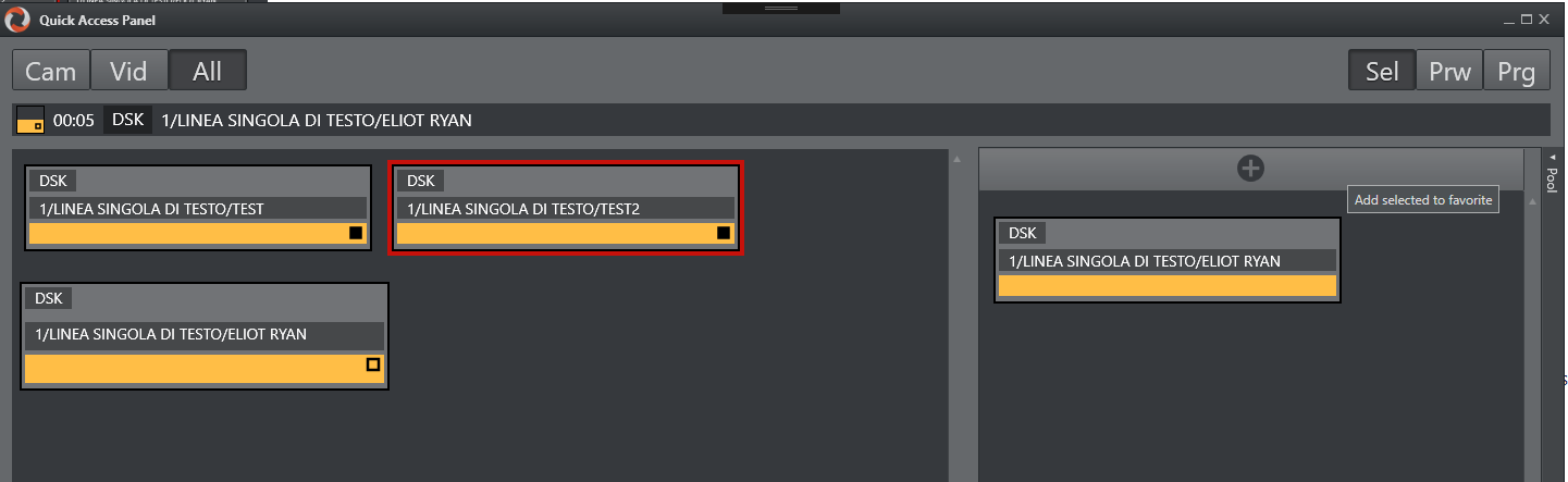

Pool Favorites
The Favorites pool is by default hidden. Enable it by clicking on the bar on the right edge of the Quick Access Panel. This expands the pool Favorites section.
Working with Pool Favorites
To Add an Item to the Favorites Pool
  1. Mark Sel as command mode.
  2. Select an item in the left section.
  3. Click the + icon at the top of the Favorites pool panel.
To Remove a Favorite from the Pool
  2. Select an item in the pool.
  3. Click on the trash icon bar at the bottom of the favorites pool.
Info: The items in the Media Pool are the same as in the Quick Access Panel pool.
