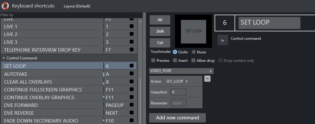

Video Port Keyboard Shortcuts
To be able to use the video port control commands, you need to add a set of shortcuts for each video port. You have to create a new set for each video port A, B, C etc. Here port A is used as an example.
For all examples VideoPort = A

SET_LOOP: Viz Mosart sets the already cued clip to looping.
Parameter: OFF, RESET. Viz Mosart turns off looping.
Parameter: 12-444 (configurable). Viz Mosart sets looping from frame 12 to frame 444.

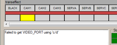

Video Port Error Messages
If AV Automation is unable to execute the command, an error message displays (for example: Failed to get VIDEO_PORT using āc/dā).
