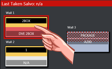

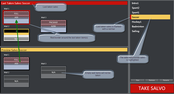

  • In the top area (red) the on-air wall templates are shown. In the bottom preview area (yellow) the selected salvo is shown.
  • The TAKE SALVO button takes the wall items in the preview area on air. It is also possible to take templates directly on air without using the salvos.
  • During a show you can change templates on preset video wall salvos by selecting a salvo and then pressing Take Salvo.

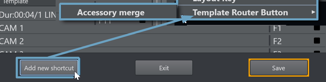

To create a Template Router wall shortcut
You create a Template Router wall shortcut, using the Keyboard Shortcuts editor on the Viz Mosart menu bar.
  1. Select Tools  >  Keyboard shortcuts editor.

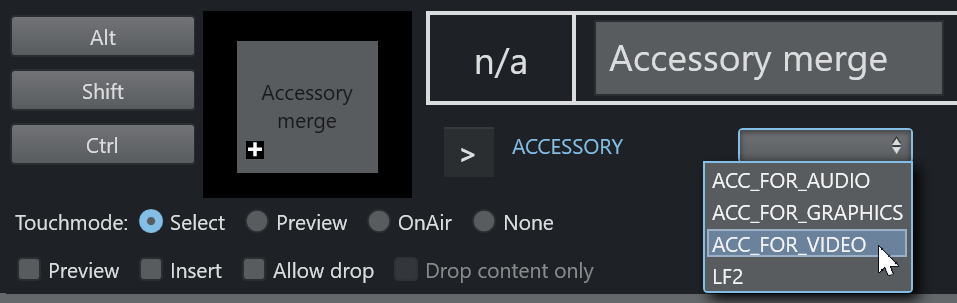

  2. Click Add new shortcut.
  3. Select Template Router Button > Accessory merge.
  4. Select the accessory template for the wall you want to control.
  5. Type in a name for the wall. It is recommended that you call the wall shortcut the same as the Accessory, but this is not mandatory.
  6. If you are using several wall elements you have to drag and drop them to the wall canvas in the Template Router.

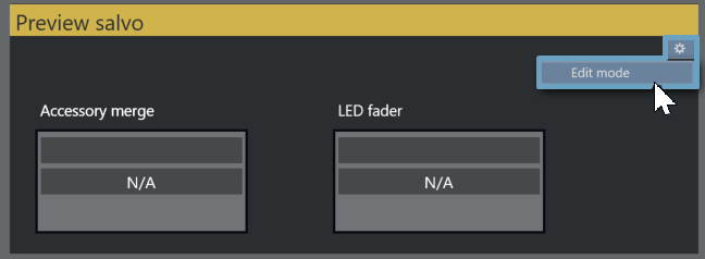

    1. If not visible, reveal the Template Router panel with View > Floating windows > Template Router.
    2. Click the tools Cogwheel and select Edit mode.
      While in this mode it is possible to drag the wall items around and make it easier to recognize the different elements during production.
    3. When ready, click Edit mode again, to exit.
  7. When you have added all the wall items you want to use, click Save and close the editor.

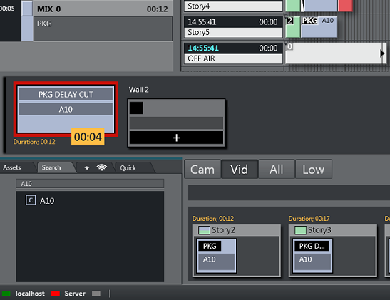

When a video clip is played on a wall using the methods described in Creating a Template Router Shortcut above, the Template Router will display a countdown of the clip in the element in the on air canvas.
When the video clip is stopped, the countdown square is not shown.
For example, the image below shows a clip with a duration of 12 seconds, and 4 seconds remaining.

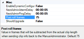

Post Roll Frames
The media administrator has Post roll frames, which will not be used when counting down. For example, if a post roll of 75 frames is used, then there will still be 3 seconds left of the clip.
Set the Post roll frames to 0 if you want to see the actual countdown.

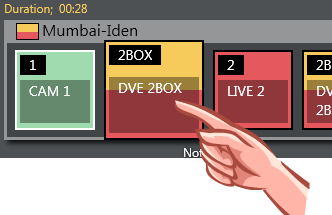

  2. Select a Story Item
  3. Select the element to take on air

Salvo

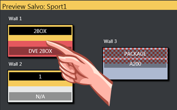

salvo is a set of templates that will be sent to some elements. When taking a salvo all the items in the salvo will be taken on air. The Template Router UI encourages the use of salvos when working with wall elements.
To add a salvo
  • To add a new salvo click the New button, type in a name of the salvo and press OK.
  • You also have the option to Remove or Rename the selected/previewing salvo.
To Fill a Salvo
To fill a salvo with routed templates, you use a procedure similar to that for Direct Take Route Shortcut (above).
The only difference is that you click the items in the Preview canvas instead of the items in the On air canvas, as follows:

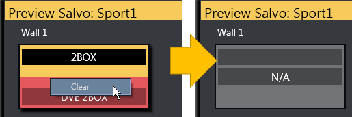

To clear existing salvo items
  • To remove a item from the preview canvas you can select another item from the keyboard buttons or Quick Access panel and click the item you wish to replace.
  • To clear a item, open the context menu and select Clear.

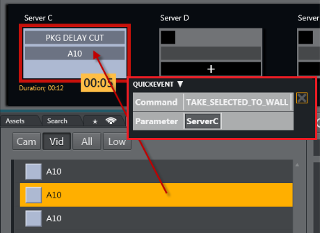

Note: The QUICKEVENT control commands use WALL terms as the Template Router was previously named Wall Manager. For backwards compatibility the command name has not been changed.
  1. Select the item you want to send to wall using the QUICKEVENT commands.
  2. The Quick Access Tab (QAT) can be used with the QUICKEVENT Control Command TAKE_SELECTED_TO_WALL.
    If you want to use the selected preview wall salvo then use the PREVIEW_SELECTED_TO_WALL control command.
  3. Click the keyboard button with the defined shortcut with the QUICKEVENT variant TAKE_SELECTED_TO_WALL and the name of the accessory used by the wall item as the parameter.

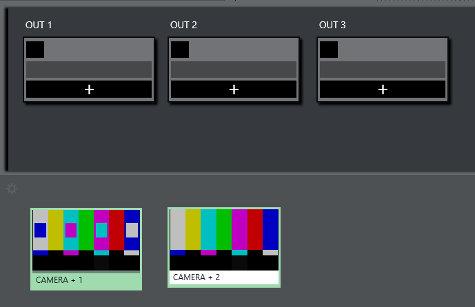

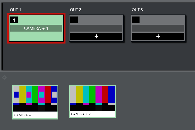

  1. Select the source you want by clicking on the Sourceview source.
Note: Only sources with template source types Camera, Graphic and Live can be used with Template Router. Other source types are not supported.
  1. Select the element to fill in the item.

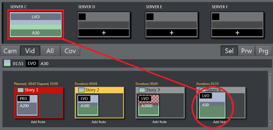

In combination, these elements become a “clip router” – enabling the operator to select any clip from the Quick Access panel and send it to cue and play in the port of their choice.
If available, the Quick Access panel and Template Router can be set up on a touch screen – making it even more user friendly.
With this configured it is now possible to manually assign clips to play in these four ports simultaneously - outside the timeline of Viz Mosart. As long as the selected mode in Quick Access panel is Sel - Select Mode. These routings are entirely independent of the A/B roll. Ensuring that the primary clips will not be interrupted by the playout of cover pictures.
In the example below, the LVO clip “A30” has been sent to play in Server Port C.
