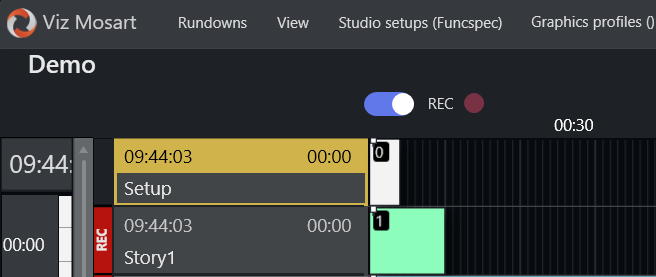

To enable/disable Story Recorder mode
You can enable or disable Story Recorder mode using any of these methods:

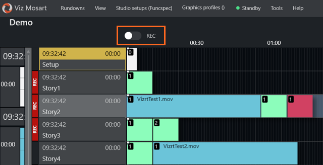

  1. Story Recorder panel toggle: in the Viz Mosart UI, the On/Off switch at the top of the menu bar selection View > Floating windows Story Recorder tool.
  2. Timeline toolbar toggle: When the rundown contains stories that have been marked in the NRCS for recording, an SR toggle button (REC) appears directly in the Viz Mosart UI timeline toolbar:

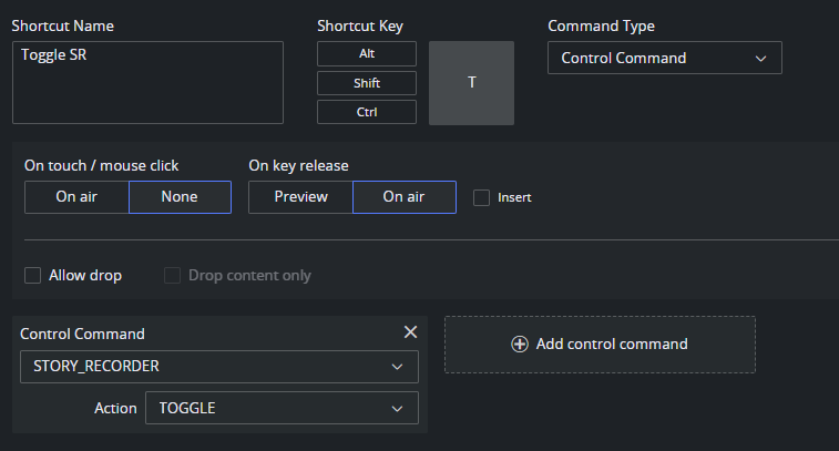

  3. Keyboard shortcut: A configured keyboard shortcut can toggle, enable, or disable SR mode.
  4. Template control command: the STORY_RECORDER control command on a template can automatically toggle, enable, or disable SR mode when the template is taken.

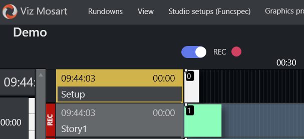

All four methods produce the same result. The current recording status is shown in both the Timeline toolbar and the Story Recorder panel:
  • Pale red REC indicator: Story Recorder mode in the toolbar above the Timeline indicates that story recording is enabled, but recording has not yet started.
  • Bright red REC blinking indicator: Story Recorder is actively recording.
    • In the Story Recorder panel, the REC button blinks during recording.
    • The Timeline toolbar showing SR mode enabled (REC) and recording.

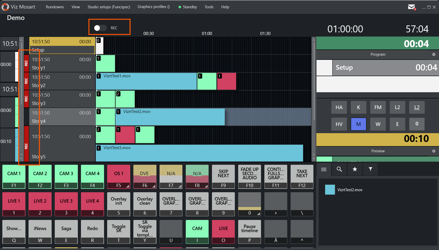

  • When there are stories tagged for recording, the SR toggle and status are shown directly in the Viz Mosart timeline, together with a red REC indicator alongside the tagged stories (for example, Story1 above).

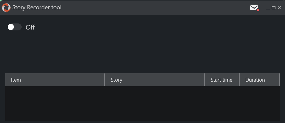

To display the Story Recorder panel
  1. With Viz Mosart running, from the menu bar select View > Floating windows > Story Recorder tool.
  2. Position the Story Recorder window on your workspace.
    (You can also place this window on a second screen.)

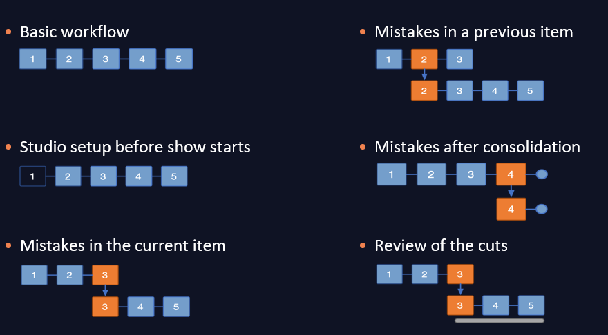

In this Show workflow, the entire show is recorded and a .tsedl EDL file is broadcast to a Vantage transcoder, which stitches all recorded segments into a single final clip. The operator can pause, make corrections, and resume recording from a selected retake point.
The following diagram illustrates common recording scenarios. Blue items are recorded segments; orange items indicate retake points.
The sections below describe three common use cases for supporting error-free production and recording of a Viz Mosart-driven show.
Tip: For a quick guide to what is displayed in Story Recorder, refer back to the illustration The Story Recorder Panel.

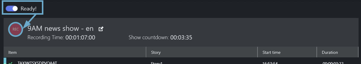

  3. From the Story Recorder panel, switch on Story Recorder mode (described above).
    After a few seconds, the REC button is red, indicating the system is ready to record your show.
  4. If Step 2 above was performed, then execute Take Next to continue with the next story item in the show (this will be the first recorded story item).
    Otherwise begin the show by taking at the first story item of the show.
    For each story item taken, a row is presented in the Story Recorder panel, the most recent indicated with Recording...

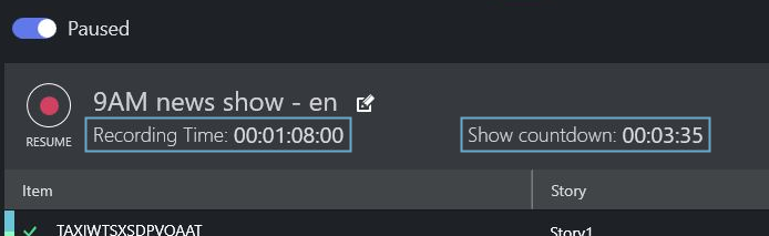

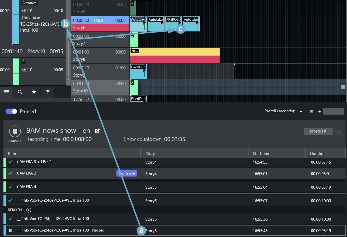

  2. Press PAUSE to interrupt recording as required. Refer to the screenshot below:
    1. In the Story Recorder panel, the current story item is marked as Paused (a).
    2. In Rundown view above the Story Recorder panel, the corresponding rundown story title is also blue (b).
    3. In the Rundown view, on the story row, a PREROLL template (c) is automatically inserted before the paused story item.
  3. Make required changes and prepare to recommence recording, by clicking the Story Recorder panel icon, PAUSED srP.png .
    A countdown timer cues for retake and recording resumes from the break point.
    Continue as above till the last story line, where an information text warns that the show recording will soon be complete.

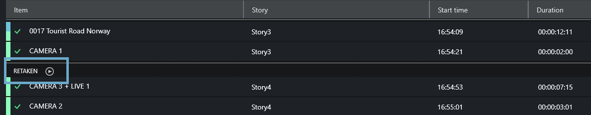

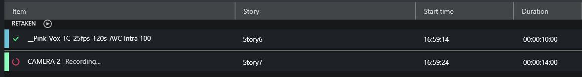

  4. (Optional) When resuming after a pause, approximately 10-15 seconds into the new recording, a snippet featuring the previous cut is available for review.
    Click the RETAKEN Play icon to review the snippet.

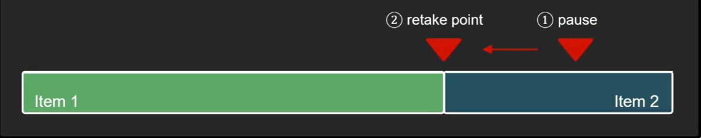

Rolling Back in Time at Retake
The smallest rollback is a Viz Mosart primary story item. A story row usually comprises several story items, each item defined with a Viz Mosart primary template.
So for example, if your running show is executing item three of the four primary items that make up the story, then the pause will cause a rollback to the start of item three.
A retake point is always at the start of a primary item, regardless of where the pause was made.
Note: Currently, it is not possible to replace a specific recorded story item. All the recorded story items after the retake point, including the story item set as retake point, must be re-done once the show is restarted after a pause.

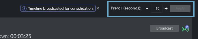

Pre-roll
When you pause a story, Viz Mosart automatically inserts a pre-roll event in the story row, before your paused story item.
The duration of this pre-roll is configurable, usually around 10-15 seconds. The pre-roll period provides the system time to automatically initialize itself back to a stable, known status for all equipment like robotic camera positions, onscreen graphic elements, media clip availability, fader levels. It also provides a cue for the talent to prepare for beginning again.
Critically, the pre-roll period can never be less than the time the video server hardware requires to prepare for recording. This is typically 10-15 seconds.
  • You can configure the pre-roll time from the Story Recorder panel:

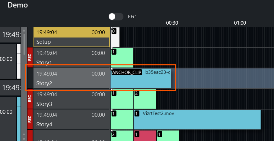

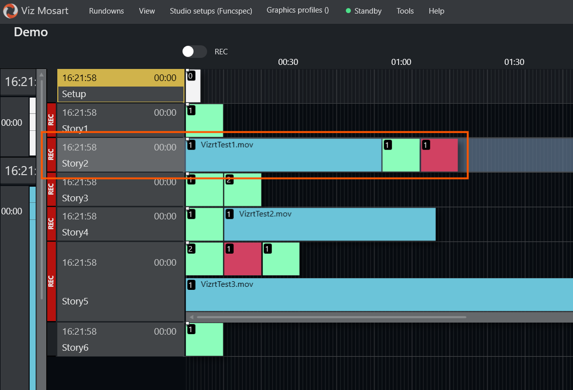

Stories Marked for Recording
For the story clip production workflow, stories must be tagged for recording in the NRCS before the show. Any NRCS that can provide the required metadata fields on the MOS story object can be used with this workflow. Saga and Showmaker offer built-in integration; other NRCS systems can be configured via Newsroom Settings field mapping.
See Story Recorder Setup for the NRCS metadata requirements and configuration details.
When a rundown containing tagged stories is loaded in Viz Mosart, these stories are shown with a REC indicator in the main timeline view. The Story Recorder mode toggle at the top of the timeline also indicates whether there are stories to be recorded.
The REC indicators means that the tagged story is configured for clip production. When Story Recorder mode is enabled and a clip output (renderer/transcoder) is configured, a clip will be produced for this story. The indicator does not mean the story is currently being recorded, and no clip production occurs unless Story Recorder mode is enabled.

  1. In the NRCS, ensure the relevant stories are marked for recording.
  2. Load the rundown in Viz Mosart. Verify that tagged stories show REC indicators in the timeline.
  3. Enable Story Recorder mode (using any of the methods described in Managing a Story Recorder Session).
  4. Run the show: Take stories as usual, with Take Next (default F12).
    • When the first item of a new story is taken on air, the previous story's recordings are automatically submitted for clip production.
    • Stories that are not marked for recording are silently skipped.
  5. When done, disable Story Recorder mode. Any remaining recorded story is submitted for clip production automatically.

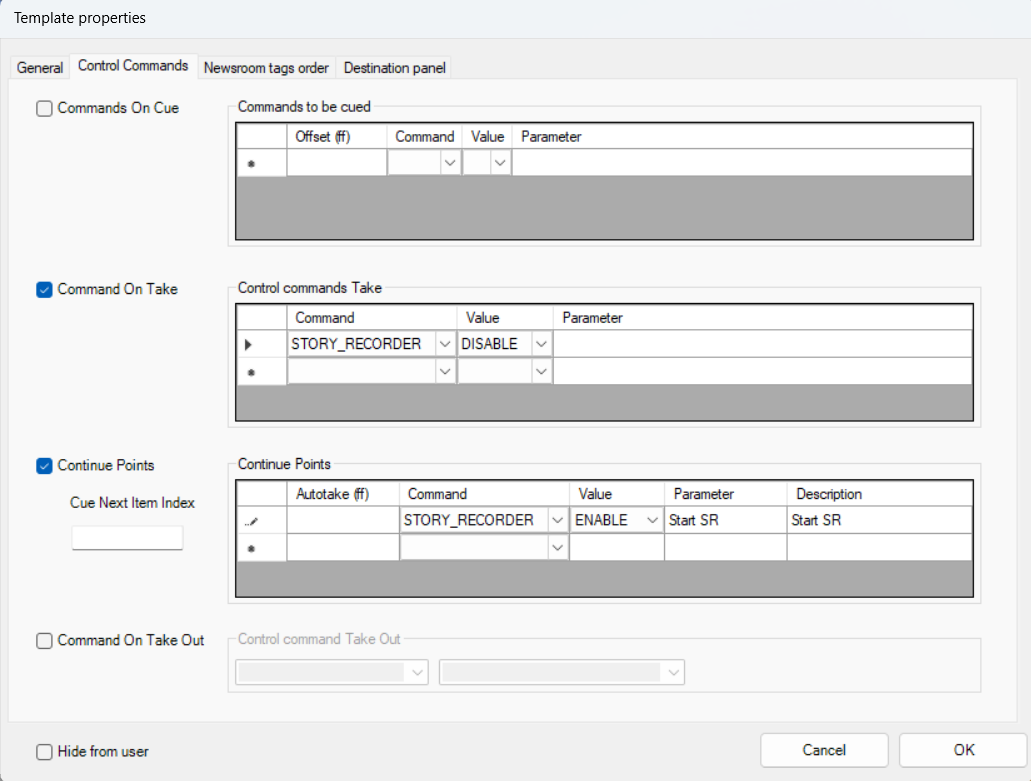

Offline recording with stories back-to-back
In this use case, you record multiple stories in an offline session where the operator controls the pace between stories For example, allowing the anchor time to prepare or reposition between takes.
This is achieved by using a dedicated template with a STORY_RECORDER control command that toggles SR mode on and off between stories. The template is configured with:
  • Command On Take: STORY_RECORDER with value TOGGLE (or DISABLE) . This disables SR mode when taken on air, triggering clip production for the completed story.
  • Manual Continue Point: STORY_RECORDER with value TOGGLE (or ENABLE). This re-enables SR mode when the operator takes the next manual continue point.

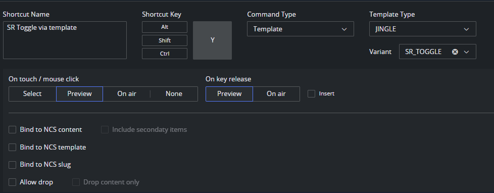

The SR Toggle Template can be executed in two ways:
  • Keyboard shortcut: Configure a keyboard shortcut to take the template in Preview. The operator recalls this shortcut on the last item of each story, then takes the template on air when ready to end the story.
  • From the NRCS: Add the SR toggle template at the end of each story in the rundown. The template is then automatically queued as the last item of the story.

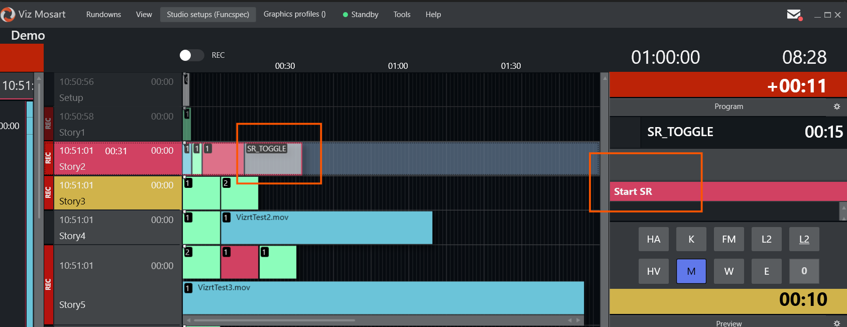

Workflow:
  1. In the NRCS, tag the stories for recording.
  3. Enable Story Recorder mode and take the first story.
  4. On the last item of a story, bring the SR Toggle Template into Preview (using its keyboard shortcut, or automatically if placed in the rundown).
  5. When the story is finished, take the template on air. This disables SR mode and triggers clip production for the completed story.

Using Recorded Story Clips
Once a story clip is produced, it can be used in several ways:
  • Replace the original story
    The NRCS can be configured to play the recorded clip instead of the original scripted content.
    This is useful when a pre-recorded version of the story should air in place of the live segment.
  • Reuse in other rundowns
    The recorded clip is available as a regular media asset and can be inserted into any other rundown.
  • Add graphics to a clean feed
    If the clean feed (without burned-in graphics) was recorded, new graphics can be overlaid on the clip, for example for rebranding or a different-language broadcast.
Switching between original and recorded clip in the NRCS
As an example of an NRCS, with Saga, the producer can choose per story whether to use the original script or the recorded clip version. When the recorded clip is selected for a story, Saga sends the clip to Viz Mosart using a template of type PACKAGE with variant ANCHOR_CLIP.
Info: This template must first be created in Viz Mosart's Template Editor before it can be used.
Timing Details
The Mosart UI has been extended with support for Story Recorder-related timing fields.
The Story Recorder panel displays the following new timing details:
The Recording Time field starts at zero when a Story Recorder session is started, and
  • When the timeline is running, this counter is continuously growing, equal to the sum of the already recorded sections + the duration of the current recording.
  • When the timeline is paused, this counter is static, equal to the sum of the recordings prior to the selected Retake point.
The Show Countdown field displays the difference between the planned duration as defined in the NRCS and the Recording Time.
  • When the timeline is running, this counts down.
  • When the timeline is paused, this is static.
If Recording Time exceeds Show Planned Duration, then Show Countdown becomes negative and will be counting up.

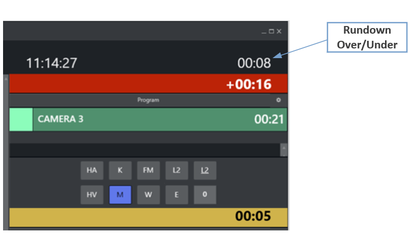

The Rundown over/under field is an existing field in the Viz Mosart UI, and when Story Recorder mode is enabled, it provides an indication of the executed recordings relative to the remaining rundown and the planned duration of the rundown:
  • Under: indicates the number of seconds the show must be extended to meet the planned duration.
  • Over: indicates the number of seconds the show exceeds the planned duration.
All these Story Recorder related time fields are also shown in the Mosart Timing Display and forwarded to the Plura Timing System (using the Time Request Protocol).
