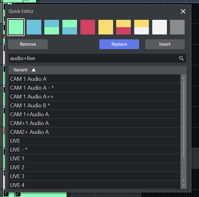

The Quick Editor provides a convenient method for modifying template characteristics in a rundown story. For example, when you decide to perform the next studio shot in Cam 2 instead of Cam 3.
Quick Editor Operations
After double-clicking a template you can:
Change the type: Delete, replace, and insert primary elements (for example, Camera)
Change the variant: Delete and replace accessories, delete lower thirds
Delete the entire template
Insert a new template directly after the current one.
Template types Camera, Package, Voice over, Float, Live, Graphics, DVE, Telephone, Break and Jingle are supported as primary story items in the Quick Editor.

When using a predefined template set from the NRCS, these are listed below the Remove button (after double-clicking a template).
Only templates from their own set are shown in the Quick Editor.

Double-click the information area of a story, on a template or to the right of the last element in a story.
The Quick Editor opens:

To Search for a Template Variant
The Quick Editor Search field helps you locate a specific template. The search tool is not case sensitive. Some tips:
A space between keywords acts as a logical AND, enabling multiple keywords.
For example:CAM VIDEO: Lists variants with both CAM and VIDEO in their name.
CAM AUX 3: Lists variants with with all three namings CAM, AUX and 3.
A + sign between keywords acts as a logical OR, enabling multiple keywords.
For example:CAM+VIDEO: Lists variants that have CAM or VIDEO in their name.
CAM+AUX+3: Lists variants with any of the namings CAM, AUX or 3.
Combination of space and + (+ sign has a lower priority).
For example:CAM+AUX 3: Lists variants that have CAM or AUX and 3 in the name.
CAM AUDIO+AUX 3: Lists variants that have CAM and Audio or AUX and 3 in the name.
