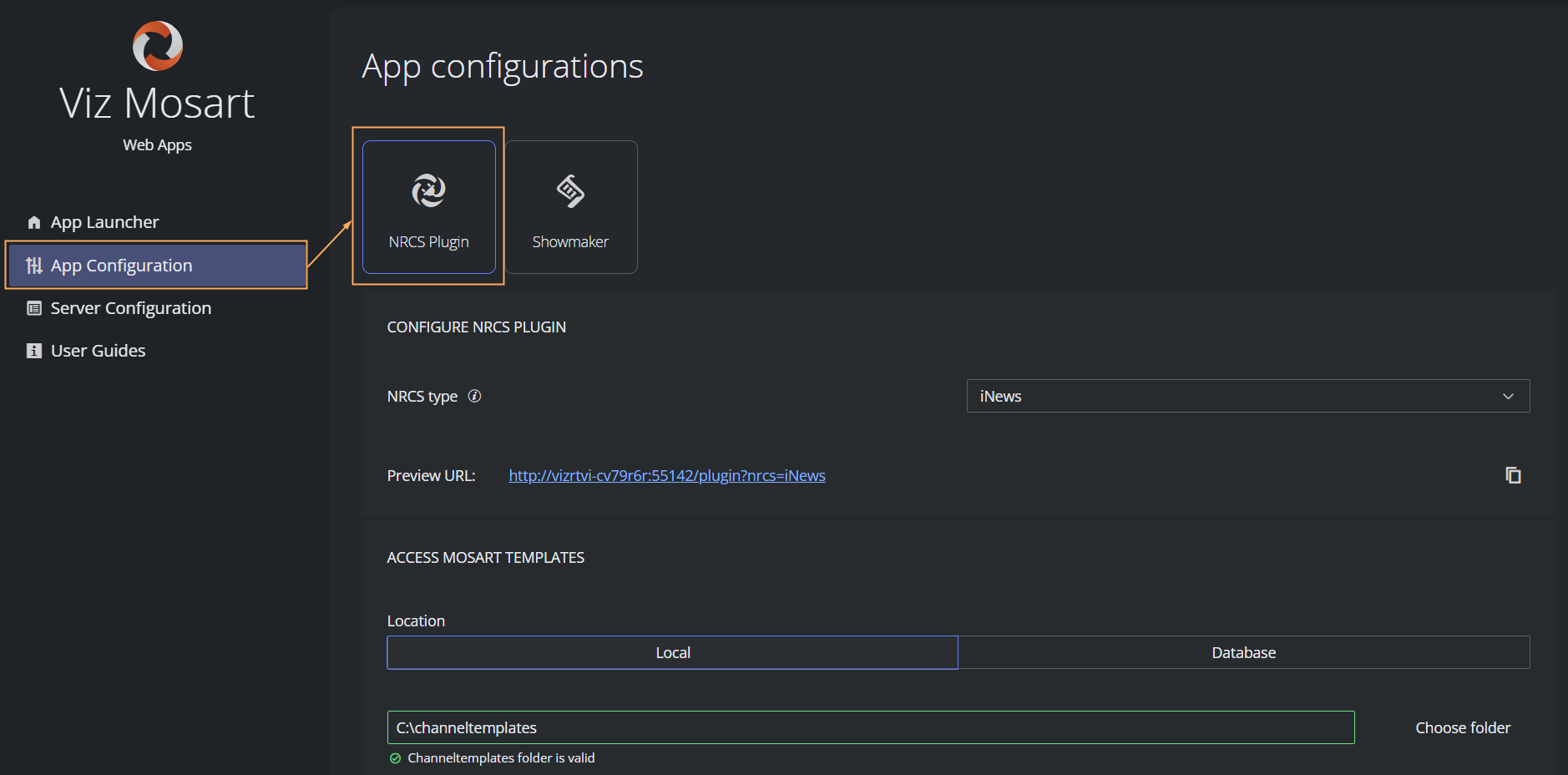

To configure the NRCS Plugin
First perform the Getting Started (Installation) procedure.

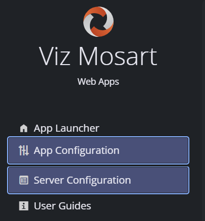

Select App Configuration and click NRCS Plugin.
From the NRCS type drop-down menu, select your newsroom system type.
(If iNEWS is selected NRCS type, ignore this step)

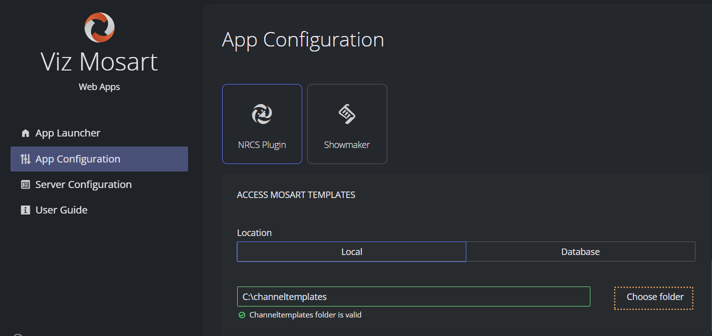

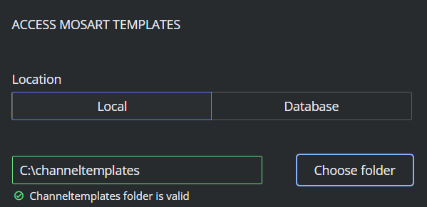

Back in the Web Apps Configuration Tool App Configuration page for the NRCS Plugin, in section ACCESS MOSART TEMPLATES, specify the location of your Viz Mosart templates.
This can be eitherLocal: By default, this is a local folder C:\channeltemplates. The tool will automatically scan for three files:
channeltemplates.xml
avconfig.xml
newsroomsettings.xml
If successfully identified, a green validation message is displayed.
A network folder: When your template folder is on a network drive
Click Choose folder and navigate to the target folder.
Ensure the network folder has adequate permissions.
Database: If template details are stored in a database, enter host access and authentication details.
Click Save.

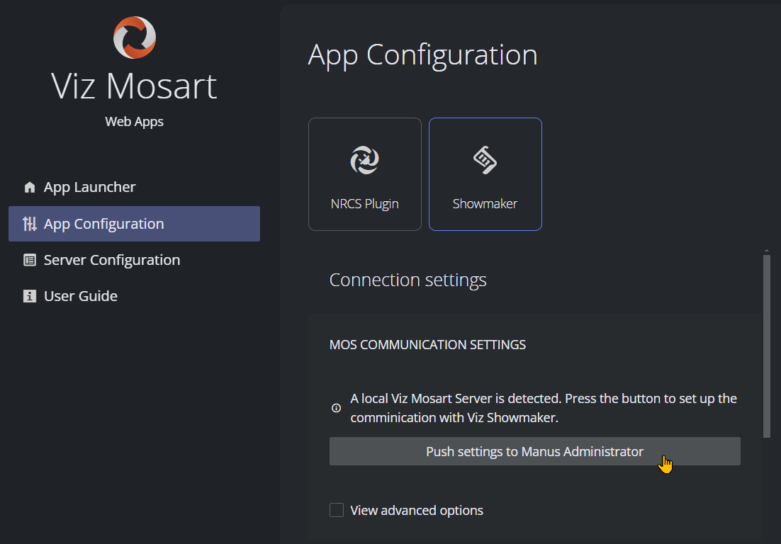

Showmaker is installed on the same server as Viz Mosart
If you are running Showmaker on the same server as the Viz Mosart server, the Configuration Tool provides a way to automatically configure Viz Mosart to establish communication with Showmaker.
From the App Configuration page, under Showmaker, tick View advanced options and review settings. If necessary, adjust the default values as described in the table above.

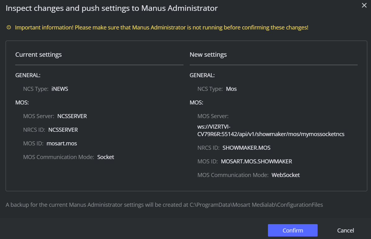

In the same App Configuration menu for Showmaker, click Push Settings to Manus Administrator.
A warning message reminds that Manus Administrator shall not be running at this point.
Ensure Manus Admin is closed before continuing.To complete the action, click Confirm.

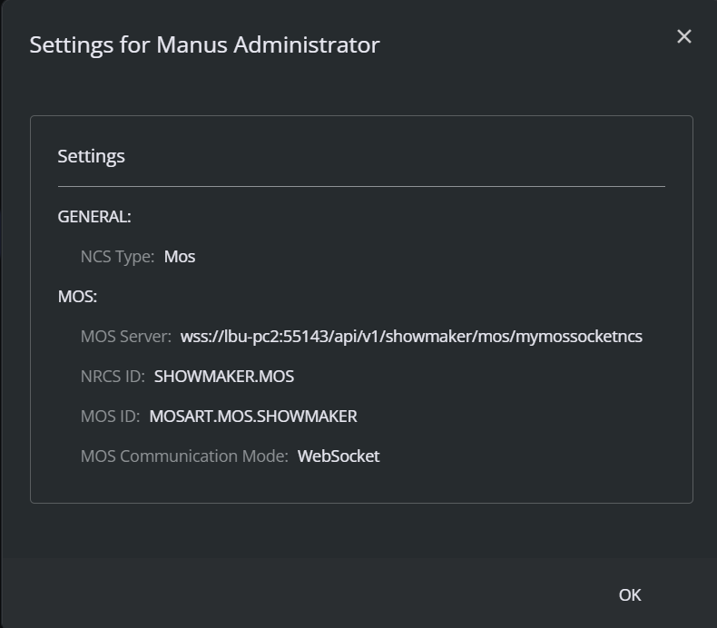

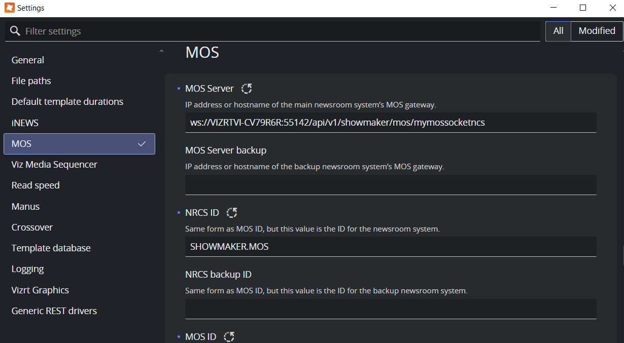

In the App Configuration menu for Showmaker, click View Settings for Manus Administrator.
On the Viz Mosart server, in the Viz Mosart Manus Admin console, type settings
From the Settings menu that appears, navigate to the section MOS.
Configure the MOS settings as presented in the pop-up menu Settings for Manus Administrator (shown above) in the Web Apps Configuration Tool.
Click Save.

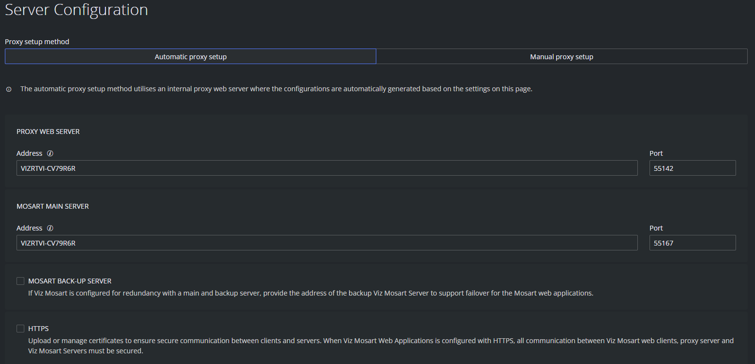

Automatic Proxy Setup
To set up the automatic proxy server
You can use the onboard proxy web server where configurations are automatically generated based on the settings displayed on the Server Configuration page.
All default settings are already pre-filled and no further action should be necessary.
However, if you need to change any values see the settings below:PROXY WEB SERVER
Address: Hostname or IP address of the machine where the Mosart Web Applications are installed. The system attempt an auto-detect. If the FQDN is required (for example, by a certificate), provide this instead.
MOSART MAIN SERVER
Address: By default, this field will contain the address of the Mosart Web Applications. Please enter the hostname, IP address, or FQDN of the main Viz Mosart server if located on another machine.
MOSART BACK-UP SERVER
When running Viz Mosart with a backup for redundancy, provide the backup server address.Select the MOSART BACK-UP SERVER check-box.
Address: Enter the hostname, IP address, or FQDN of the backup Viz Mosart server.
Click Save.

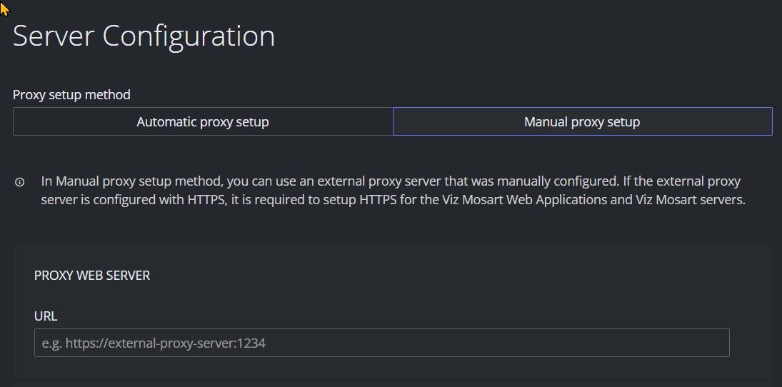

Manual Proxy Setup
You can use an external proxy server, but it must be manually configured.
If the external proxy server is configured with HTTPS, you must also set up HTTPS for the Viz Mosart Web Applications and Mosart servers.
Tip: You can examine the Caddy file generated when Automatic proxy setup is selected to understand how to set up an external proxy. This Caddy file resides at C:\ProgramData\Mosart Medialab\Mosart Web Apps.
To set up a proxy server manually
From the Server Configuration page, select Manual proxy setup.
Under section PROXY WEB SERVER in field URL, enter the URL address to the external proxy server. This must be a valid web URL starting with http or https.

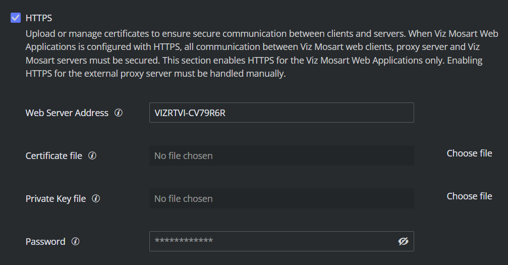

HTTPS
In Manual proxy setup, the certificate is only for the Mosart web server. The hosts included in the certificate are validated against the Mosart web server address field (under the HTTPS section).
If you are using HTTPS, continue with steps 3 to 5 below.Select the HTTPS check-box and follow the onscreen guidelines '
'.Web Server Address: The IP or the hostname of the Viz Mosart web server. The system attempt an auto-detect. If the FQDN is required (for example, by a certificate), provide this instead.
Certificate file: The certificate in encrypted PEM format. If FQDN is specified in the certificate file, the Mosart web server address must also be a FQDN.
Click Save.
