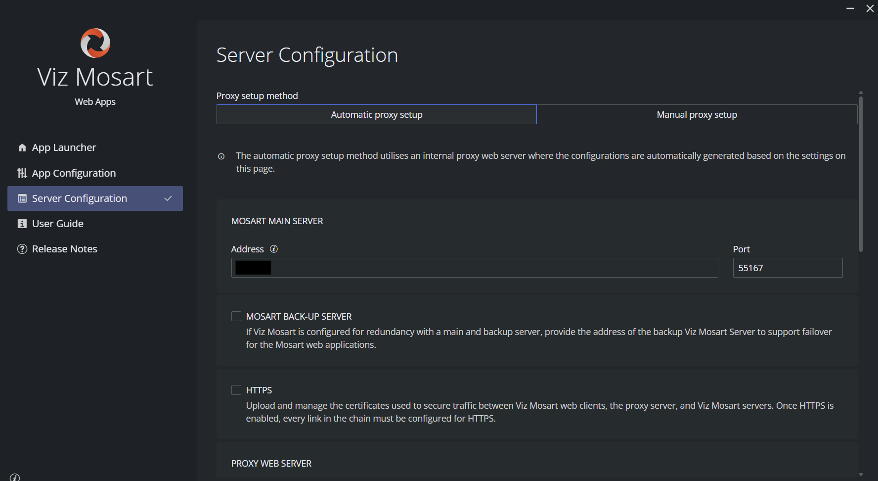

Step 4: Point the Web Apps suite at your Mosart server.
In the Configuration Tool, open Server Configuration and fill in the main (and optional backup) Viz Mosart server addresses.
Smart Panel does not have a separate connection screen, it uses these shared settings to talk to the Mosart server.

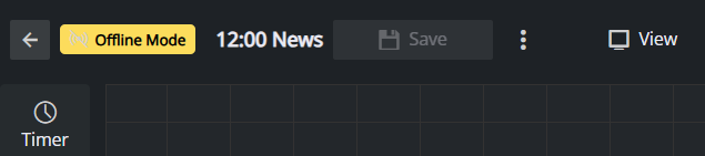

The "Offline" chip stays on in the app bar
The Offline chip means Smart Panel has lost contact with Viz Mosart. The panel keeps working, but timers, labels, and faders display fixed sample values instead of live data. As soon as the connection comes back, the chip disappears and live values resume automatically.
If the chip does not clear after a few seconds, work through the checks below in order.
Is Mosart Server configured? Open the Mosart Web Apps Configuration Tool, go to Server Configuration and confirm the main Mosart Server host is set. Save and reopen Smart Panel.
Is Mosart Server running and reachable? On the Mosart Server machine, confirm Manus Administrator is running and a rundown is loaded. If it is, but Smart Panel still shows Offline, the Mosart Web Apps host can not reach the server, check the network connection between the two machines.
Using a custom reverse proxy? Smart Panel always calls
/mosart/...on the Mosart Web Apps host (SignalR hub, REST API, status endpoints). The bundled Caddy proxy forwards/mosart/*to Mosart Server automatically. If you replaced Caddy with your own proxy (nginx etc.), make sure it forwards/mosart/*to the Mosart Server.Is authentication misconfigured? If OIDC is on, an expired or rejected JWT causes the page to reload. Persistent reload loops mean the identity provider is rejecting the token. Re-check the OIDC settings.
Check the browser console. Open the browser developer tools (F12), reload Smart Panel, and look at the Console tab for red error messages. They usually point directly at one of the causes above (server unreachable, authentication rejected, network blocked).
