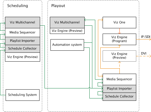

Viz Multichannel is typically installed in the following locations:
  • Viz Multichannel’s Schedule Collector and Playlist Importer on the Media Sequencer machine in the server room. Media Sequencer is in most cases installed on the Viz Engine (program) machine.
  • Viz Multichannel, it’s Schedule Collector and Playlist Importer on a client machine in the scheduling center
  • Viz Multichannel on a client machine in the master control room
