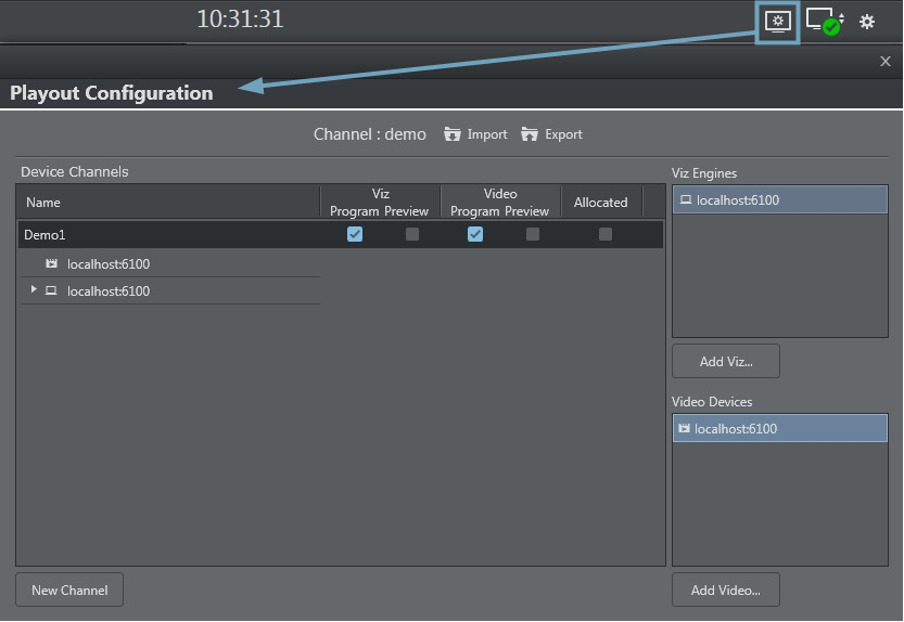

Click the Playout configuration icon on the main menu-bar to display the Profile Configuration panel:
You can use the Import and Export buttons to import (or save) a configuration to an XML-file for safekeeping. Importing a configuration from an XML-file makes it easy to quickly change configuration parameters.

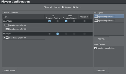

Add a Playout Device to the Device Channels List
- Click the New Channel button, or drag and drop a playout device to the Channels list.

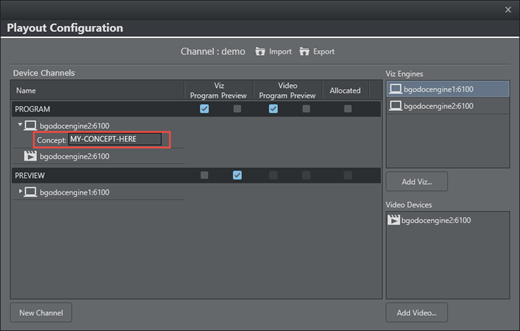

Add a Concept Override for a Channel’s Playout Device
- Expand the device channel’s playout device and append the concept name.
This will override any concepts set elsewhere. Click OK
Caution: Note that concept names are case sensitive.

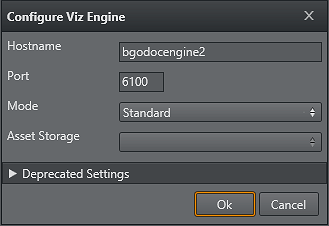

Configure a Graphics Device
- Click the Add Viz button to open the Configure Viz Engine dialog box.
- Enter the hostname and port
- Default port for Viz Engine is 6100.
- Optional: Select Mode.
- Scene Transitions: See To Enable Scene Transitions.
- Still Preview: See To Enable Scene Transitions.
- Optional: Select an Asset Storage location.
- Asset Storage lists available Viz Engine storage for clip transfer and playout.
- Click OK.
A status indicator will show if the renderer is On Air.

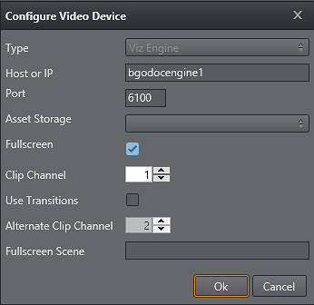

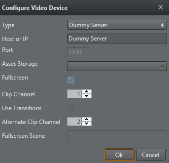

Configure a Video Device
- Click the Add Video button to open the Configure Video Device dialog.
- Select the video server Type.
- Enter the Host or IP address and the port.
- Default port for MVCP is 5250.
- Default port for Viz Engine is 6100. - Select an Asset Storage location.
- Asset Storage lists available Viz Engine storage for clip transfer and playout. - Enable/Disable Fullscreen mode.
- When Fullscreen is enabled, which is the default behavior, stand-alone video clip elements are played out full screen in the back layer. Graphics in the middle or front layer will still play.
- When Fullscreen is disabled. stand-alone video clip elements will only replace the current video clip without triggering animations or transition effects. - Select Clip Channel (only relevant for Viz Engine).
- Click OK. A status indicator shows if the device is On Air/online.
Configure a Dummy Video Device
- Select the video server Dummy Server.
- Enter a name for your dummy server (e.g. Dummy Server).
Click OK.
Note: This will enable use of the Timeline Editor when Viz One is simply a gateway and video is served from an alternative asset management system.

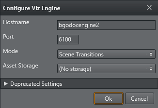

Transition Effect scenes are made in Viz Artist and can be applied to data elements to create custom transition effects from one scene to the other. If an effect is specified, the effect will be shown when the scene is taken On Air.
Effects include wipes, dissolves and alpha fades.
- Configure the Viz Engine settings as described in how Configure a Graphics Device
- Set the Mode to Scene Transitions to allow the renderer to copy (or snapshot) the scenes for creating a transition effect between them.
- Click OK.
Add the program renderer to the program channel.
Note: The program channel must be configured and on-air in order for the effects to be visible.
