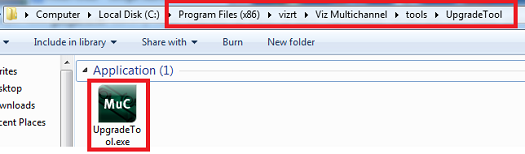

Multichannel 2.7+ provides an update tool which can be found at [Viz Multichannel installation folder]\tools\UpgradeTool]

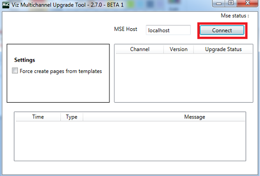

  1. Double-click the program to open it.

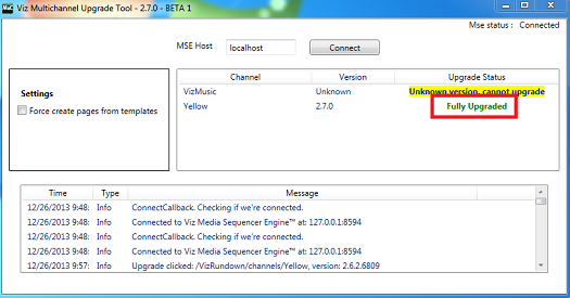

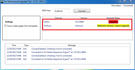

  2. Click Connect to show a channel list.
    The channel lists which are upgradable are shown with an Upgrade button.
  3. Click Upgrade to begin.
  4. The Upgrade Status will show a Fully Upgraded when the upgrading process is completed.

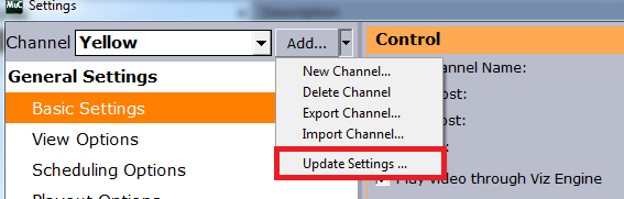

Upgrading Multichannel from 2.5 or 2.6 to 2.6.2
Caution: Always make sure you have a fully backed-up all relevant configuration settings before attempting an upgrade.

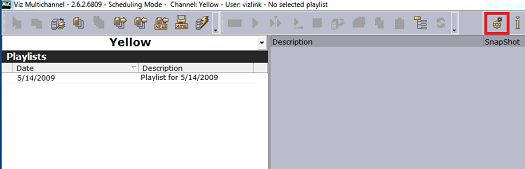

  1. Double-click the application icon to open MuC 2.6.2
  2. Open the Settings window from the Viz Multichannel toolbar
  3. From the Add button drop-down, select Update Settings
  4. After the upgrade has been performed an Information dialogue box will be displayed. Re-open the Settings form to review the upgraded configuration.

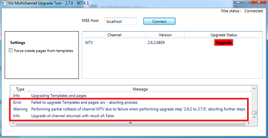

Troubleshooting the Upgrade Tool
Normally the upgrade tool performs a complete upgrade automatically. In some cases a configuration or scene settings can prevent the upgrade tool from performing a complete upgrade. In case of failure, the upgrade tool either rolls-back the complete process (in case of an unrecoverable error) or provides warning messages (in case of non-critical errors).
Critical Failures when Running the Upgrade Tool
  • The template and page information are missing
    To fix this, re-import or delete the templates and pages indicating by the error message. Then run Upgrade Tool again by clicking the Upgrade button.

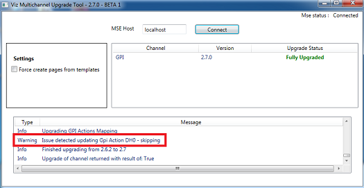

Non-Critical Warnings when Running the Upgrade Tool
  • The node value is null or empty
    The “Node value is null or empty” is not a serious problem. The Upgrade tool is able to upgrade successfully while skipping all of this failure type. However, to prevent a further error, users should fill all the missing node values after the completion of an upgrade. Often this relates to GPI-settings. Contact Vizrt support if unsure.
