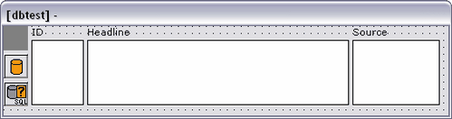

Both scripting examples use a standard Microsoft Access database. The database contains a table (dbTable) that consists of the following fields; id, headline and source.
The template itself has three labels and listboxes corresponding to the database table fields.
