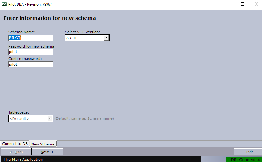

Install a new schema, set a schema name, username and password, and a tablespace name. If the user level is set to R&D mode (see Advanced Configuration), it's possible to install an unstable version of the database schema. This is typically the latest version in development, and is only recommended for testing.
Installing a New Schema
Click the Install New Schema button.
In the New Schema window, select the Viz Pilot version to be installed.
Optional: Enter the schema name and password
Optional: Enter the tablespace name. Setting a different tablespace name requires this option to be selected (see Advanced Configuration).
Click Next twice to start the installation.
Click Next when finished.
Note: If errors occur, see Database Error Logs.

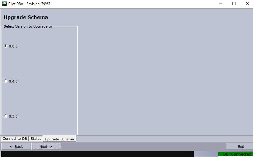

Upgrade Schema
Upgrade to to a newer version of the schema. If the user level is set to R&D mode (see Advanced Configuration) it's possible to upgrade to an unstable version of the database schema. This is typically the latest version in development and is only recommended for testing.
Upgrading to a New Schema
Click the Upgrade Schema button.
In the Select Schema window, select the schema that should be upgraded, and click Next.
When Pilot DBA has checked the status of the current schema, the Upgrade Schema window lists the available upgrade options.
Select the schema version, and click Next to see the script that will be executed.
When ready to upgrade, click Next to run the scripts.

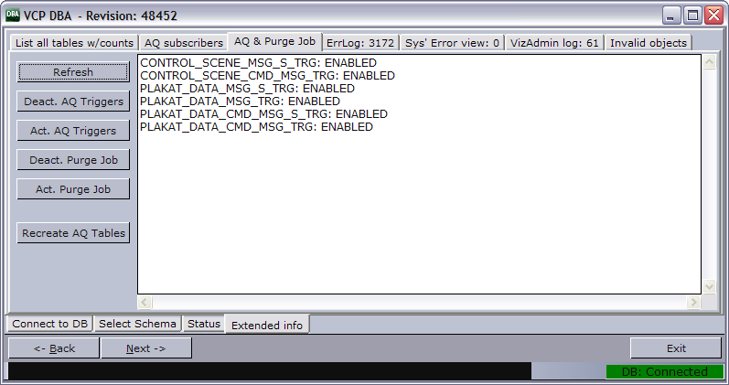

AQ Subscribers: Shows a list of the message queue (AQ) Subscribers currently registered.
AQ & Purge Job: Lists the status of and allows the user to activate/deactivate the AQ Triggers and the Purge Job. This view also has an option to recreate the AQ tables, which is done by deleting and recreating the tables.
Deact. and Act. AQ Triggers: Disables and enables the AQ system if this is working properly.
Deact. and Act. Purge Job: Disables and enables a scheduled job on the database that purges old messages from the AQ system to avoid these tables clogging the database with obsolete data. (see Purge Expired Messages).
Recreate AQ Tables: Deletes all AQ tables and all data in them, and then creates new tables and registers these with Oracle’s AQ system. This option will delete all messages not received in the AQ tables; the AQ system will not work afterwards if any errors occur. This option should therefore not be used by users that do not know how to read error logs and who are not able to fix AQ issues manually.

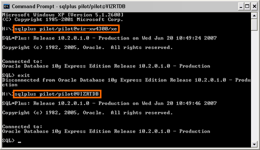

Database Test
Try connecting to Viz Pilot’s database to test if the database is successfully installed and running.
Start a command-line tool, and then type the following:
sqlplus userid/password@tnsname, or
sqlplus userid/password@hostname/SID
SQLPlus connection:
Check that the output is similar to the example output below:
C:>sqlplus pilot/pilot@viz-xw4300/xe SQL*Plus: Release 10.2.0.1.0 - Production on Wed Jun 20 12:17:19 2007 Copyright (c) 1982, 2005, Oracle. All rights reserved. Connected to: Oracle Database 10g Express Edition Release 10.2.0.1.0 - Production SQL>The example output above shows that the database is placed on a remote machine, named viz-xw4300, thus the connection string @viz-xw4300/xe (hostname/SID) or the TNS name only is required.
C:>sqlplus pilot/pilot@VIZRTDBNote: The above screenshot and output example uses the SID XE. This is the default SID for Oracle 10g XE, which is an Oracle test database.
