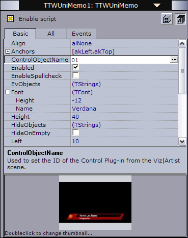

Object Inspector displays Component Properties which can then be configured, and Component Events can be added through scripting. All properties use the ControlObjectName property that ties the Exposed Objects or Scene Objects (see the Resource Panel) from the graphics scene to the template.
The majority of components contain many properties, most of which are only used in special cases. The inspector therefore has a separate properties views.
It is also possible to sort properties by category or name by clicking the sort buttons. Properties are sorted by name by default.
It is also possible to use the inspector to change the Template Thumbnail.
Note: The property editor in Template Wizard does not support Unicode directly. To edit properties like "UTF8Text", press the ellipsis button (...) and then edit the text.

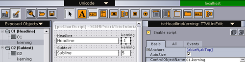

ControlObjectName
All components that support graphic scenes with Control plugins contain the ControlObjectName _property which shows the exposed object to which a property is connected. The value is linked to the structure and numbering of the exposed objects. The value below the _01 (Headline) entry named 01 contains the default value since its name is the same as the main entry - 01(Headline). This is a text string in the example above. The ControlObjectName for this value is then 01. The kerning value for the text string is grouped under the 01 node and is given the ControlObjectName 01.kerning. The naming convention is objectname.propertyname.
Note: It is good practice to name the scene’s Field Identifiers 01, 02, and 03 instead of 1,2,3,4 ... 11,12 and so on. Using 1,2,3,4 ... 11,12 will cause data to be assigned to the wrong fields when using Import Components since the Media Sequencer will place 11 and 12 before 2 and so on.

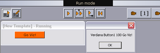

Example 1
Scenario: A user clicks a button on a template and an OnClick event triggers a new event that loads a piece of data into a dialog box.

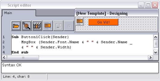

The image above shows a solution to the scenario with an OnClick Event where the button’s Sender object is an argument to the Sub procedure Button1Click. The event name is comprised of the Name (Button1) property and the event type (OnClick). The Sender object contains all the component properties of the sender.
Note: Do not confuse the Name property with the Caption property. The Caption property is what is displayed on the button, and the Name property is what is used to reference the button.
Clicking the button triggers the OnClick event, and displays a message box with the button’s font type, name, width in pixels and its label.

Adding an Event
Check the Enable script option in the Object Inspector (CTRL + F12) to enable scripting.
Click the Events tab, and double-click the empty field to the right of the event. This creates a default event name and inserts a script framework (sub procedure) into the script editor.
Template Thumbnail
All templates use the thumbnail generated when the scene was saved in Viz Artist. Multi-scene templates (for example Transition Logic) use the thumbnail from the first scene that is added to the Wizard’s Selected scenes pane (Wizard’s step 2).
It is also possible to select a custom image (such as jpeg, bmp) by double-clicking the Thumbnail image (lower-right) in Template Wizard; however, these cannot be based on Viz Artist scene icons.
Note: Thumbnails are visible in Director and Viz Pilot News.
