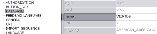

INI File Settings for TNS Alias
The TNS alias name must be set in the name property under the Database section in the ContentPilot.ini file (see Database Initialization File Configuration).
images/download/attachments/105087901/configuration_database_tns_initializationfile.png
IMPORTANT! In order for the TNS settings to work for Director, Template Wizard and Object Store, the name key must contain the same TNS name alias as in the tnsnames.ora file (for example VIZRTDB).

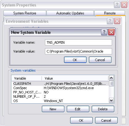

Setting TNS_ADMIN as a Local Variable
Rather than using the Changing Settings, add a local Windows environment variable called TNS_ADMIN, with the same value as the config tool option. The difference is that the config tool will only affect the Viz Pilot system, while the environment variable will affect all applications on the machine using an Oracle client. See also how best to use the Initialization File and Environment Variable.
