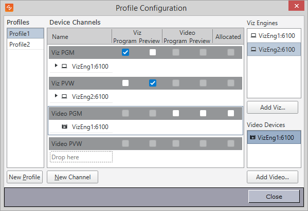

Configuring Profiles
Opening the Profile Configuration
Select Tools from the main menu, and then Profile Configuration (CTRL+M), or
Right-click the profile on the status bar (lower-left) and select Profile Configuration... from the context menu.
Adding a New Profile
In the Profile Configuration window click the New Profile button, enter a new unique profile name, then press Enter.
Renaming a Profile
Right-click the profile and select Edit Profile Name, or double-click it and enter the new name.
When finished editing the name, press Enter or click the cursor outside the Profiles list.
Deleting a Profile
Right-click the profile and select Delete Profile, or select it and press the Delete button.

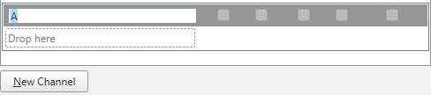

Configuring Channels
Adding an Output Channel to the Channels List
Click the New Channel button, or drag and drop a Viz Engine or video device to the Channels list.

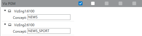

Adding a Concept Override for a Channel’s Output Device
Expand the channel’s output device and append the concept name.
This will override any concepts set elsewhere.
Info: Concept names are case sensitive.
Click OK.
Renaming an Output Channel in the Channels List
Right-click the channel and select Edit Channel Name from the context menu, or double-click the name.
Removing an Output Channel from the Channels List
Right-click the channel entry and select Delete Channel from the context menu, or select the channel and press the Delete button.
Removing an Output from the Channels List
Right-click Viz Engine or video device and select Delete Output, or simply select it and press Delete.

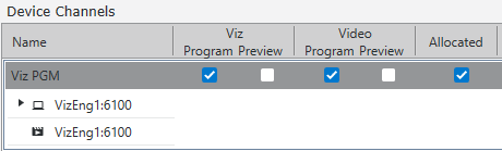

Allocating Video Clips
Checking the Allocated check-box allocates video devices for the clips in the playlist. Media Sequencer enables the transfer of all clips to all video devices for two channels with each their video device. Based on the allocation, the clips in the playlist are played out in a given order (for example A, B, A, B) to allow back-to-back playout. Allocation is not necessary for video devices that are able to play out back-to-back.

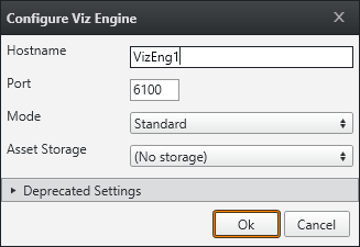

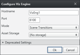

Adding a Viz Engine
Click the Add Viz... button in the Profile Configuration window to open the Configure Viz Engine dialog box.
Enter the Hostname and Port (default port is 6100).
Optional: Select Mode
Scene Transitions: See how To enable scene transitions.
Still Preview: See how To enable scene transitions.
Optional: Select a Viz One storage in Asset Storage.
Optional: In Deprecated Settings, select Visible containers and/or Font Encoding.
Click OK.
A status indicator will show if the renderer is on-air.
Note: The Asset Storage drop-down lists the available Viz Engine storage points where Viz One files can be sent for playout.

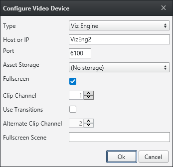

Adding a Video Device
Click the Add Video... button in the Profile Configuration window to open the Configure Video Device dialog box.
Select the video server Type:
Viz Engine
MVCP Compatible: Multiport Video Control Protocol, see Cliplist.
Dummy Server: A dummy server can be part of a channel used for timing GFX in Timeline Editor. Used when it is necessary to adjust timing based on lower clips.
Enter the Host or IP address and the Port:
Default port for MVCP is 5250.
Default port for Viz Engine is 6100.
Select Asset Storage. Select a publishing point from the list, so that clips or data elements are transferred to the right location (the specified Viz Engine) for playout.
Enable/Disable Fullscreen mode.
When Fullscreen is enabled, which is the default behavior, stand-alone video clip elements are played out full screen in the back layer. Graphics in the middle or front layer will still play.
When Fullscreen is disabled stand-alone video clip elements will only replace the current video clip without triggering animations or transition effects.
Select Clip Channel (only relevant for Viz Engine).
Note: Viz Engine 3.6 and later supports playout on up to 16 clip channels. A clip channel might be unavailable for various reasons, for example, if it is configured to be inactive in Viz Config, or if the license only covers a limited number of clip channels.
Select whether or not to Use Transitions.
Select Alternate Clip Channel.
Optional: Enter the Fullscreen Scene.
Click OK.
A status indicator shows if the video device is on-air or online.

Adding an Output to the Channels List
Drag and drop a Viz Engine or video device onto the channel in the Channels list, or select it and select Add to profile (creating a new channel) or Add to selected channel.
Enabling Scene Transitions
Transition Effect scenes are made in Viz Artist and can be applied to data elements to create custom transition effects from one scene to the other. If an effect is specified, the effect will be shown when the scene is taken on-air. Effects include wipes, dissolves, alpha fades, etc.
Configure the Viz Engine settings as seen in Adding a Viz Engine, above.
Set the Mode to Scene Transitions to allow the renderer to copy (or snapshot) the scenes to create a transition effect between them.
Click OK.
Add the program renderer to the program channel.
Note: In order to see the effects, the program channel must be configured and on-air.

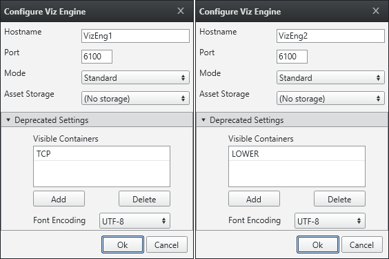

Rendering Specific Scene Containers
Before configuring your Viz Engines to render specific scene containers< it is recommended to read the Forked Execution section for further explanation.
Click the Deprecated Settings button to expand the editor.
Click the Add button to enter the scene’s container name that should be rendered visible.
Optional: Repeat step 3 to Add other containers.
Click Ok.
Changing Font Encoding
Select Font Encoding, it sets the font encoding of Viz Engine. The encoding can either be set to UTF-8 or ISO-8859-1. Default is UTF-8.
Click Ok.
