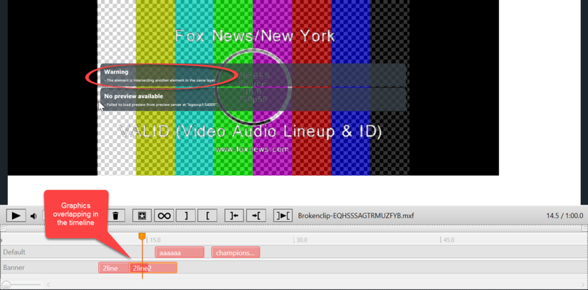

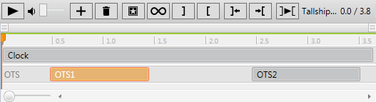

Multiple Tracks in the Timeline Editor
The Timeline Editor supports multiple tracks for transition logic scenes. This allows graphics to overlap and play out correctly, but requires that all data elements are based on the same transition logic set.
The tracks reflect the layers in the transition logic scene. A track is displayed in the timeline editor if an element using that layer has been added.

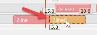

Graphics from the same layer must not be overlapped, and the timeline editor will indicate a possible conflict by coloring the graphics placeholders red, as shown below:

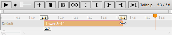

Positioning Elements on the Timeline with Snapping
Graphics snap to each other if they are on the same track.
To reproduce:
Open a video with multiple graphics on the same timeline.
Drag one graphic towards another.
Elements snap together once they get close enough. This means the in and out points on the elements line up on the timeline, as shown here:
Tip: Press CTRL while dragging a graphic to disable snapping.

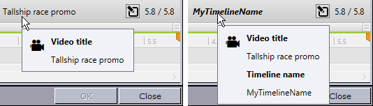

Setting a Timeline Name
After adding graphics in the timeline editor, you can give a timeline name to the resulting composite element. If the timeline name is set, it is put into the MOS element (mosAbstract node), otherwise the video title will be used. The timeline name will be displayed in the newsroom story and in the playlist.
Reopening a MOS item in a newsroom system that supports updating the items, will also update the existing name.
Note that if you open an existing item that has a timeline name, the timeline name will remain the same when editing, but will not appear as a changed name next to the label. This enables you to override the timeline name again or set it back to empty if you wish to use the name that was previously set.
The atom XML generated by the timeline editor will have the timeline name set as the atom:title (this remains empty if not set).
You can:
Hover your cursor over the video title/timeline name to see names in full.
Set or edit the timeline name, by either:
Right-clicking the video name and select Set timeline name.
Hovering over the video name and pressing the Set timeline name button .
Clear the timeline name by right-clicking the video name and selecting Clear timeline name.

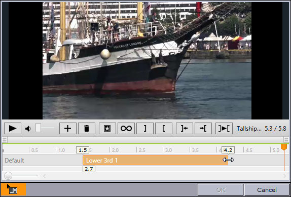

Working with the Timeline Editor
Adding Graphics to a Video Clip Timeline
In Viz Pilot News, click the Media tab to search for videos.
Right-click the video item, and from the context menu select Open in Timeline Editor.
To add graphics, click the Add button
This will open the Template and Data Elements view.
Select a template or previously saved data element, and click OK.
Clicking OK will prompt the template or data element to be saved.
After it is saved you will see a graphics placeholder on the timeline.
Adjust the placeholder to set the desired duration of the animation.
Optional: Repeat steps 3 and 4 to add more graphics.
Drag and drop the timed video and graphics onto your story.

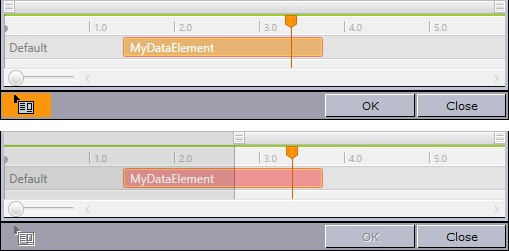

Invalid Timeline! The element is not fully inside the area marked by the In and Out points.
Timelines which have elements which are outside or intersecting the Mark In/Mark Out points cannot be saved or dragged to the rundown.
In the image below, the first timeline shows a normal element, while the second timeline contains an element which intersects the In/Out points - the second timeline cannot be saved or dragged.If loading timeline elements (overlay graphics), or calling update service (Timeline Update Service) takes more than two seconds, an abort button is shown on the loading screen. Clicking the abort button causes the video to be loaded with a missing or incomplete timeline with overlay graphics, depending on which of the two operations was aborted.

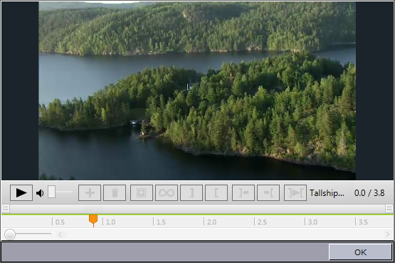

Timeline Editor Preview Mode
A basic version of the Timeline Editor is available for previewing video elements from within a template or data element. Video preview and scrubbing is available, however the controls for timeline manipulation are disabled.
The Preview option is available from the context menu of the video element.
Note: Preview is only available if the image component in the template lists is VideoMediaSearch in it is ImageSources, and is only enabled if a video asset is actually selected.
