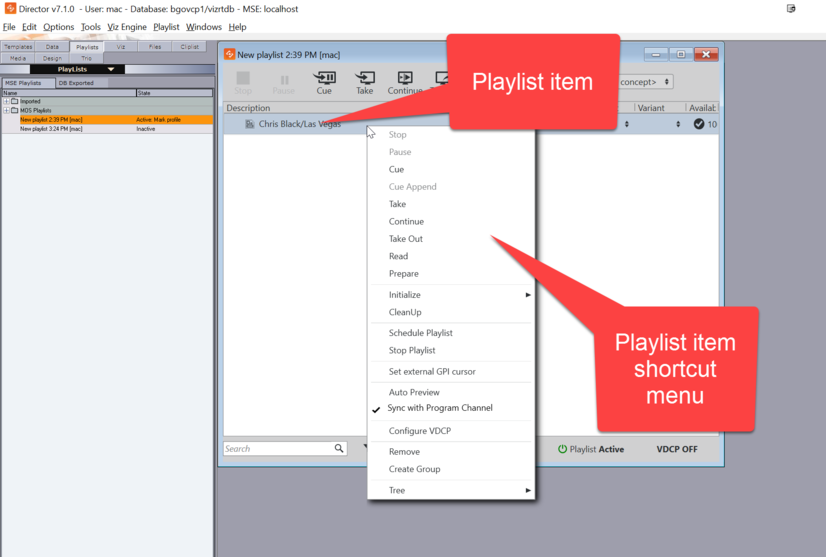

Right-click an item to bring up the playlist shortcut menu:
images/download/attachments/81476202/playlists_playlistrightclick.png
  • Stop or Pause the video.
  • Cue: Prepares the clip for playout so the first frame is ready in the player.
  • Cue Append: Prepares the clip for playout. The clip will start automatically when the current clip ends.
  • Take: Performs a direct take on the selected page.
  • Continue: Continues the playout of an element.
  • Take Out: Takes the element out (hard cut).
  • Read: Reads the element.
  • Prepare: Prepares the clip in the pending player without affecting the current clip, so it is ready to be played out. The clip will not start automatically after the current clip. Requires Viz Engine 3.3 or later.
  • Initialize Playlist or Initialize Element.
  • Cleanup: Cleans up all renderers that have an item in the current playlist by clearing all loaded graphics from memory for those channels. To clear all renderers, go to the Main Menu > Viz Engine Menu > Cleanup Renderers
  • Schedule Playlist: Activates the playlist. For example, if Begin time has been set, the playlist must be scheduled before the changes take effect.
  • Stop Playlist: Stops a previously scheduled playlist.
  • Set external GPI cursor: Sets the external cursor for a selected element. The cursor indicates the element that will be taken if a “take and advance” General Purpose Input (GPI) action is executed, for example.
  • Auto Preview: Automatically enables preview of next element from selected.
  • Sync with Program Channel: Syncs the preview with what’s showing on the program channel. For example, if you have a lower third on the preview and are showing a fullscreen video on the program channel you can see them together in the preview.
  • Configure VDCP: Opens the Video Disk Control Protocol (VDCP Tab).
  • Remove: Deletes selected items.
  • Create Group: Creates a new group. The new group will be created above the currently selected item. Groups cannot be created when multiple items are selected.
  • Tree: Organizes the elements in the current playlist and changes the font used

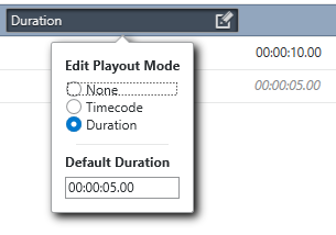

Playout Mode can be selected as a playlist column. Playout Mode specifies how groups should be played out and the different options are available using the Playout Mode column drop-down menu. The user can choose between three options: None, Duration and Timecode.
  • Timecode is the default option. The time is set in the Timecode column. Timecode indicates that an element should be played out relative to the parent group or video.
  • When Duration is selected, elements of the group will be played out one after the other, each staying on air for the amount of time that is specified in the Duration column. It is possible to set a default duration for items without an explicit duration at the bottom of the Playout Mode drop-down menu. The duration of items using this default value will be shown in italics and grayed out in the duration column. However, they can still be edited by first selecting the item row and then clicking the duration value.
    Default duration fields will not appear for the other Playout Mode options.

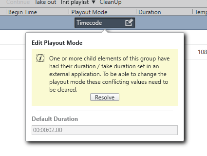

    Info: Depending on the selected playout mode for the containing group, the duration column will show one of two different underlying values for each element, internally called duration and take_duration. When playout mode is Duration, the column will show the value called duration, otherwise take_duration. However, regardless of the playout mode, both values might exist in the Media Sequencer at the same time; for example, if set in an external application or a previous version of Director. In such cases, duration will only have an effect if the playout mode is Duration, while take_duration is always considered when taking an element. Regardless of how the element is taken on air, it will be taken out after that time if it has take_duration set. Since the interface only shows one of these values, having both set might lead to unexpected results. Such conflicts must therefore be resolved by clicking the Resolve button that is shown in this state. This will remove the instance of duration and take_duration that is not currently visible on the interface.

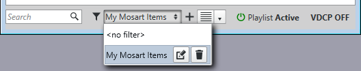

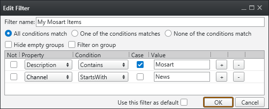

Use the Filter option to filter what items the playlist will show. You can create as many filters as required with the New option, and existing filters can be edited or deleted. When you have created a filter, simply select the filter to use in the drop-down list. Any items that do not satisfy the filter selected will be hidden from display, and not deleted. Deselect filtering to show all items.
In the example below a filter is created that only shows items in the playlist where the description contains the word Mosart:
images/download/attachments/81476202/newplaylist_playlist_filter.png
Use the drop-down entries and check-boxes to create a filter as required, based on the template attributes.

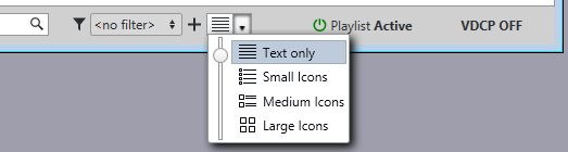

Thumbnail View
Change the thumbnail size.
