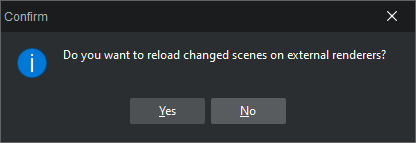

When in Viz Artist mode, Artist displays a button labelled Trio in the upper right corner. Click Trio to return to Viz Trio.
When you are back in playout mode, the confirmation dialog above asks you whether the scene should be reloaded on external renderers, like the external preview engine.
The template is re-imported automatically.

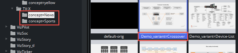

A context-enabled show has the possibility to switch concepts and variants within a show. For example, a News concept could be switched to a Sports concept. Within that concept there could be variants of a specific scene (such as lower and top third).
Graphics for all these variations must be made, but once they are available and imported into Viz Trio, they can be switched and played out at the touch of a button.
Within a specific concept, all variants of a scene are shown as a single template in Viz Trio’s Template List.
For a show to successfully use context-enabled scenes in Viz Trio, the folders and scene names in Viz must follow a certain naming convention, giving them properties and values for Viz Trio to recognize and use.
Concept Naming Conventions
Type | Property | Name | Example | |
Concept (folder) | concept | = | <conceptname> | concept=<conceptname> concept=News concept=Sport concept=Weather |
Context (folder)User-defined | <context> | = | <contextname> | <context>=<contextname> aspect=16x9 aspect=4x3 platform=HD platform=SD |
Variant (file) | _variant | = | <variantname> | <scene>_variant=<variantname> banner_variant=Lower banner_variant=Top chart_variant=Graph chart_variant=Line adds_variant=Adds adds_variant=NoAdds weather_variant=3DayForecast weather_variant=1DayForecast |
IMPORTANT! It's important to add an underscore "_" to separate the scene name from the variant’s keyword in the names of variants.
