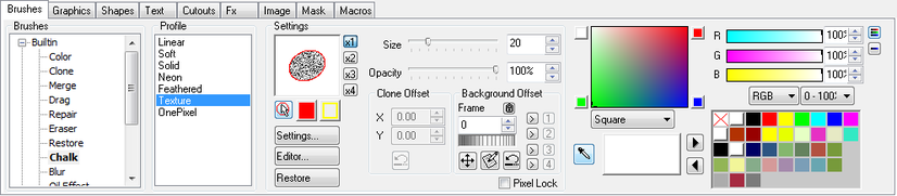

To Paint the Image or Mask
Select the Paint brushes () tool. This tool is automatically selected when you display the Brushes panel.
Select the brush you want to use in the Brush list.
Select a color for painting from the palette on the right of the Brushes panel.
Click on the image and drag to paint.
You can adjust the opacity of the paint with the Opacity slider. If you are using a pressure-sensitive input device, such as a tablet, the brush strokes respond to the pressure of your pen.

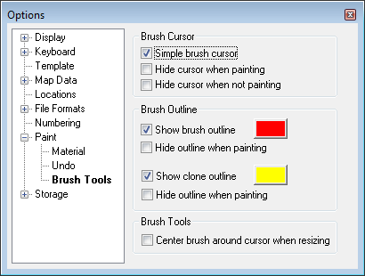

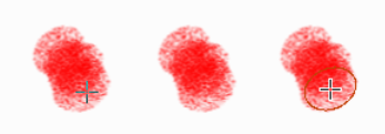

To Choose How the Mouse Cursor Displays while Painting
You can choose to hide the mouse cursor while painting, or display a colored circle or ellipse indicating the size of the brush:
The images above depicts a normal cursor, hidden cursor and outlined cursor.
On the View menu, select Options...
In the Preferences dialog box select Brush Display in the Paint section:
You can set separate options for the Clone brush.
You can also turn the outline on or off, and specify its color, by clicking the buttons on the Brushes panel:
Specifying the Brush Settings
The Profile, Size, Opacity, and Settings are set to default values specified for the brush, but you can adjust them in the controls to the right of the Brush list.

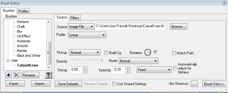

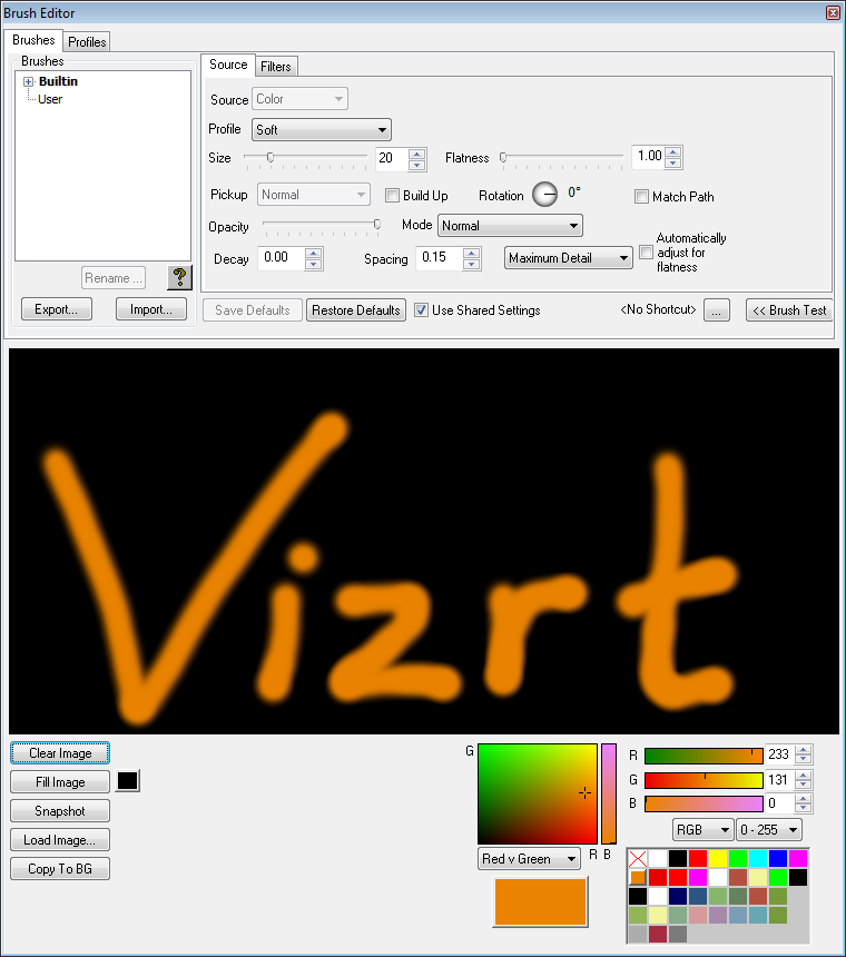

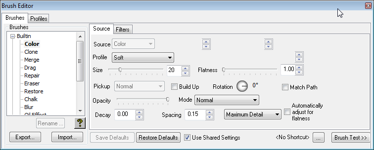

To Display the Brush Editor
Either:
On the Tools menu, click Brush Editor.
Or:
Click the Editor... button on the Brushes panel.
The Brushes list shows a list of the currently loaded brushes. Selecting any brush in the list shows its definition on the Source, Profiles, and Filters panels and allows you to edit it.
To Create a New Brush
Select the brush in the Brushes list that you want to base the new brush on.
Click the + button.
The new brush appears under the User heading and by default has Copy appended to its name, but you can rename it using the Rename... button below the Brushes list.

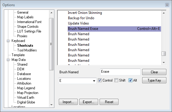

To Assign a Keyboard Shortcut to a Brush
You can assign up to ten keyboard shortcuts to the brushes you use most frequently so that you can select them with a single keypress.
On the View menu, click Options....
In the Options dialog box select Shortcuts in the Keyboard section.
In the Paint section of the Keyboard Shortcuts list, select one of the entries labelled Brush Named, enter the name of the brush in the Brush field, and enter the keyboard shortcut you want to use or click the Type Key... button and press the key combination on the keyboard:
If you assigned a keyboard shortcut to a brush it is displayed on the bottom line of the Brush Editor window.
To Test a Brush
While you are editing a brush in the Brush Editor you can test it in the Viewer, or in the Brush Test window. To display the Brush Test window, click the Brush Test button in the bottom right corner of the Brush Editor.
The Brush Test window displays. This includes a palette editor, to allow you to change the color of the brush, and controls to clear or change the image displayed in the brush test window:
To hide the brush test window: Click the Brush Test button again.

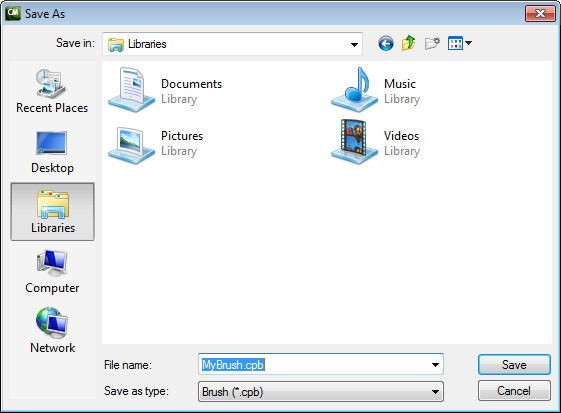

To Save a Brush
Click the Export... button below the Brushes list. The following dialog box allows you to browse a place to export the brush file to and name the brush file:
Enter a suitable name for it and click the Save button.

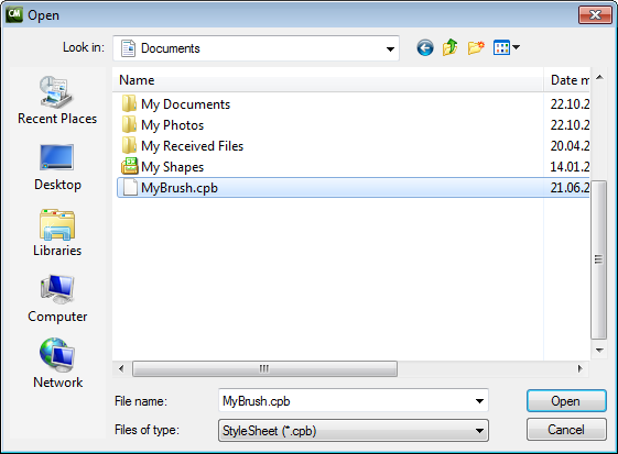

To Load a Brush
Click the Import... button below the Brushes list. The following dialog box allows you to select the brush file to import:
Select the brush file and click the Open button. The brush is added to the list of brushes in the Brushes list.

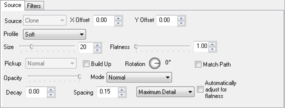

Defining the Brush Source
The options on the Source panel in the Brush Editor allow you to define the source of color for the brush, and associated options.
To Define the Paint Source
Specify the source for the paint by choosing an option from the Source pop-up menu. The options are explained in the following table:
Color: The brush paints in the currently selected color.
Clone: The brush takes the color from the image being painted. Useful in conjunction with an offset for cloning one part of the image to another part.
Background: The brush takes color from the composite background (Composite mode), or specified background layer (Single layer mode). Useful for copying from one image onto another image.
Image File: The brush paints with an image loaded from disk. Useful for painting with copies of a small image (for example, leaves).
Image Center: Colors the whole brush with the color at the center of the stamp.
Eraser: Makes pixels transparent by painting on the alpha channel.
Image: Takes color from the image.
The Image and Background Source options allow you to define an offset in the X Offset and Y Offset fields. This allows you to pick paint up from one position on the image or background and paint it in another position.
To Define the Brush Profile
Choose an option from the Profile pop-up menu. The profile determines how the paint fades away from the center of the brush to the edge of the brush, as defined by the Size parameter. You can define new profiles using the Profiles tab of the Brush Editor.
To Specify the Image Pickup
You can specify how the image is picked up by the brush using the Pickup options:
Normal: The image is picked up before each stamp.
Once: The brush is loaded once on the first stamp.
After Stamp: The image is picked up after the previous stamp.
To Define the Opacity and Decay
The Opacity and Decay define the density of the paint stamped by the brush, and the rate at which it decays as you drag. A Decay of 0 gives a brush that never dries out; larger values dry out faster.
To Define the Mode
The Mode pop-up menu allows you to specify how the paint is combined with the image; it provides the same options as the Blend Mode compositing option for layers.
To Define the Spacing
The Spacing determines the spacing between brush stamps as a percentage of stamp size. A large Spacing gives visible gaps between stamps. A small Spacing gives a smooth stroke.
Choose Fixed from the pop-up menu to make the spacing independent of your stroke speed, Constant Density to increase the spacing as you drag faster, and Maximum Detail to ignore the spacing and paint with full detail.

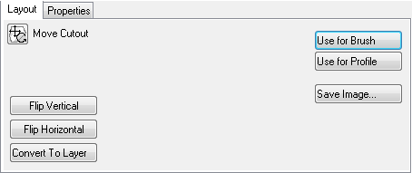

To Load a Cutout for Use as a Brush or Profile
You can use a cutout as a brush; this works in exactly the same way as painting with an image.
Alternatively you can use a cutout as the profile for painting; the cutout defines the outline of the brush.
On the Cutouts panel click the Layout tab to display the Layout panel.
Select the cutout you want to use in the Overlay list. For more information about creating a cutout see Working with Cutouts.
Click the Use for Brush or Use for Profile button:
Use for Brush saves the cutout as a TIFF image which you can load in using the Image File option in the Brush Editor.
Use for Profile saves the alpha channel of the cutout as an image file which you can load in using the Create from Image button in the Profiles panel of the Brush Editor.

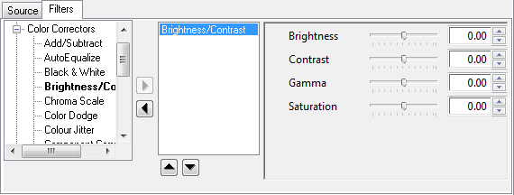

Defining Brush Filter Effects
The options on the Filters panel allow you to create brushes that selectively color correct, filter, or add an effect to the image as you paint:
The filters are divided into the following categories:
Blurs: Soften or blur the image.
Color Correctors: Allow you to do local color correction to parts of an image.
Distort: Apply marble, jitter, or turbulence effects to the image.
Effects: Provide image effects, including noise and emboss.
Filters: Process the image according to the values of the pixels.
Multiple: effects are applied in the order they are specified in the list. To change the order:
Select an effect, and click the Up or Down arrow buttons to change its position in the list.
To Create a Brush That Applies a Filter

0and the Pickup to Normal.On the Filters panel, add the effects you want to include in the brush, and for each effect set the parameters.
Defining Brush Profiles

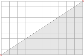

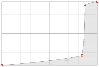

The Brush Editor Profiles panel allows you to define a number of preset profiles, and then select these when you are using or defining a brush:

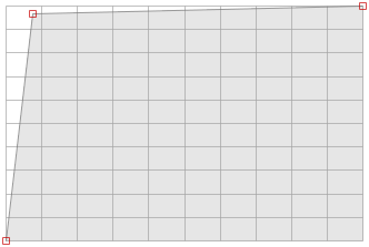

The profile determines how the paint dies away from the center of the brush to the edge of the brush, as defined by the brush size parameter.
The horizontal axis defines the radius of the brush (center on the right), and the vertical axis is the opacity of the brush stamp.
The following table shows some sample profiles together with the corresponding spread of paint they create:
Description | Profile | Effect |
Linear | ||
Soft | ||
Solid | ||
Neon |
The Create from Image... button allows you to load in an image and use its alpha channel as the profile.
You can also create a profile from a cutout; for more information see Moving and Transforming Cutouts.
To Create a New Profile
Click the + button below the Profiles list.
Edit the profile curve as required.
The profile you have defined is displayed in the Profile list on the Brushes panel, and the Profile pop-up menu on the Brush Editor Source panel.

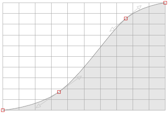

To Adjust the Profile Graph
Drag the point from the profile curve.
Click on the curve to add a new point to the curve.
Hold down CTRL and drag to extend tangent handles from a point on the curve.
Hold down CTRL to adjust one tangent handle independently of the other one.

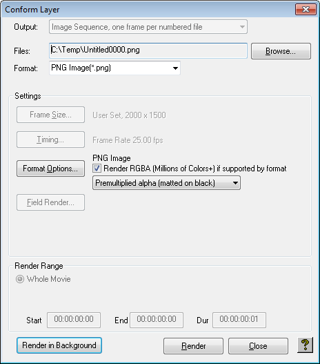

To Conform an Image or Movie Layer
Viz World Classic never changes original files on disk as they are painted. You can conform a layer to produce a new complete movie or sequence incorporating all the painted frames. The layer is then updated to use the conformed material.
Select the layer you want to conform.
On the Layer menu, click Conform Layer.... A warning confirms the Conform Layer... action.
Click the OK button to continue. The Conform Layer dialog box then allows you to give a name to the movie and specify the format:
Check Render RGBA (Millions of Colors+) if supported by format to include the alpha channel in the conformed layer.
Click the Render button to render the layer.
The movie layer is updated to use the new conformed movie, eliminating the need for the painted materials.

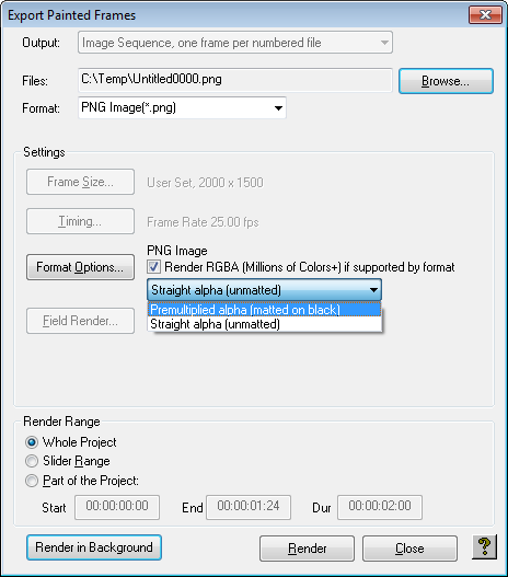

To Export the Painted Frames from a Layer or Mask
On the Layer menu, click Export Painted Frames... or Export Painted Masks....
The Export Painted Frames dialog box then allows you to specify the filename for the image sequence, and the file format:In the Render Range section specify the range of the project that you want to render.
Click the Render button to continue.
An image is created for each of the painted frames, numbered with the frame number.

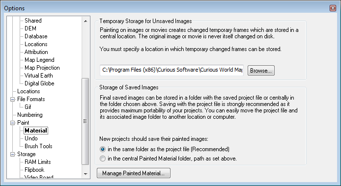

To Specify the Location of the Painted Material
In the Preferences dialog box select Material in the Paint section.
This allows you to change the location of the PaintedMaterial folder, and allows you to display the Painted Material Manager by clicking the Manage painted Material... button:
