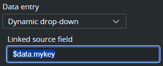

Dynamic Drop-Down Integration
You can use a key in the $data object as a source for Dynamic drop-down, for instance $data.mykey, replacing the use of a traditional model field. The source data is not stored in the payload.
vizrt.$data.mykey = "[{"label": "Tottenham Hotspur", "value": "tottenham"}, {"label": "Liverpool", "value": "liverpool"}, {"label": "Manchester City", "value": "mancity"}]"
See also Dynamic Drop-Down.

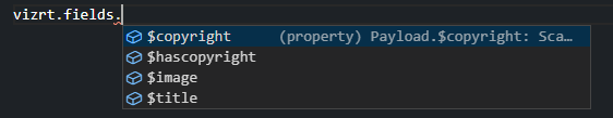

By typing vizrt.fields, the editor's autocomplete shows you the available fields to choose from.

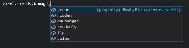

You can read and write field values, as well as react to value changes from outside the script, and access the properties error, hidden, readOnly and tip of the vizrt fields.
  • onChanged: A property on fields that you can set as a function, and if you do so, this function is called whenever the value of the fields changes, and gets the new value as an argument If this is not set, it is null
Note: Changes done to field values by the template script do not trigger the onChanged function to be called.
  • readOnly: Read and write  boolean  access, to whether the field should be editable in the form or not. If  false , the field and its input elements are editable in the UI. If  true , they are read-only and greyed out in the UI, but are accessible, saved and loaded as part of the payload.
  • hidden: Read and write  boolean  access, to whether the field should be editable in the form or not. If  false , the field and its input elements are present and visible in the UI. If  true , they are hidden from the UI but are accessible, saved and loaded as part of the payload.
  • error: Read and write string access, to an error to display for this field. It overrides other error messages associated with the field when non-empty (e.g. errors due to input length or regex constraints specified in the field definition).
  • tip: Read and write string access, to a tip to use for this field. It overrides the tip specified in the field definition when non-empty.

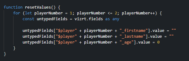

Note: Dashes cannot be used in Typescript with the dot syntax, instead you can use vizrt.fields["$01-week"] syntax to be able to access it.
Typescript lets you access fields using known names (for example, vizrt.fields["$field_2"]), but does not allow expressing the field names using variables (for example, vizrt.fields["$field_" + num]), as it is unable to determine whether the field name is valid and what type the field is.
This must be used, for instance, when addressing the layers in a Transition Logic combo template, such as: vizrt.fields["$-vizlayer-TL_FS"].
To overcome this, the type checking associated with vizrt.fields can be locally ignored by using the any type. You may do so inline using for example (vizrt.fields as any)["$field_" + num], or storing it as a new variable, as shown in the example below.
Note: Be aware that when using an object cast to any, the script editor isn't able to help you catch errors like setting a boolean value to a string field, or even trying to access a field that does not exist..

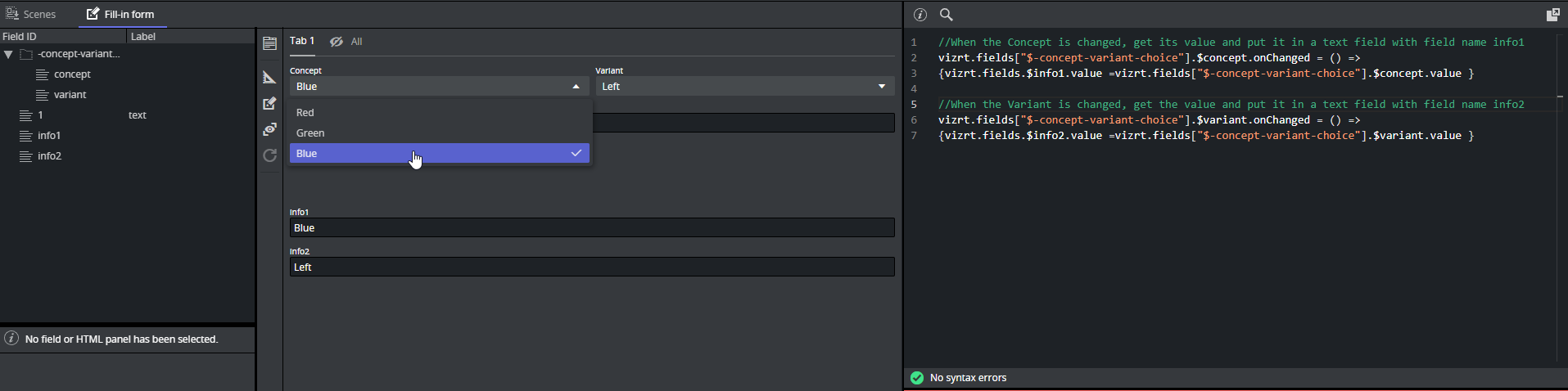

Accessing Concepts & Variants from Scripting
To access the information from concept and variants fields, because they contain dashes, you must use square brackets, as shown in the example below.
//When the Concept is changed, get its value and put it in a text field with field name info1
vizrt.fields["$-concept-variant-choice"].$concept.onChanged = () =>
{vizrt.fields.$info1.value = vizrt.fields["$-concept-variant-choice"].$concept.value }
//When the Variant is changed, get the value and put it in a text field with field name info2
vizrt.fields["$-concept-variant-choice"].$variant.onChanged = () =>
{vizrt.fields.$info2.value = vizrt.fields["$-concept-variant-choice"].$variant.value }
