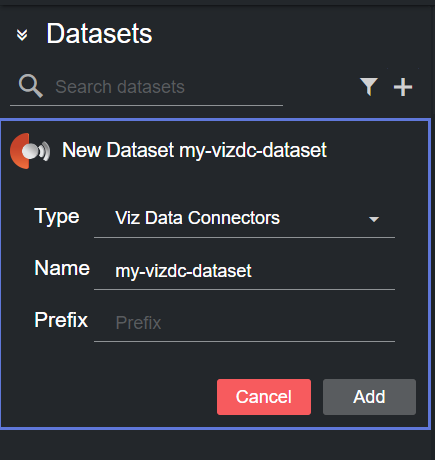

  1. Create a new dataset of type Viz Data Connectors, specifying a name and (optionally) a prefix to use to identify the dataset and its values:

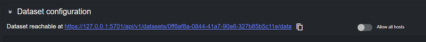

  2. Click Add. The following link is displayed in the Dataset configuration panel:
    This link can be used in the Flowics web-ui, to configure the Middleware to forward data to Datacenter.
The basic setup assumes that both Datacenter and the Flowics Middleware run on the same machine. When this is the case, no further steps are required to setup a Flowics dataset, and any data configured to be forwarded by the Middleware, should also appear in the Dataset Entries panel. However, for setups where Datacenter runs on a different machine than the Flowics Middleware, the following additional steps have to be performed:
  1. In Datacenter's Dataset configuration panel, enable the Allow all hosts toggle.
    1. Substitute the localhost/127.0.0.1 part of the address shown in the Dataset configuration panel with the machine public IP, and use this new address to configure the Middleware to forward data to Datacenter.

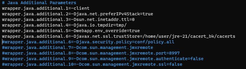

  • If a copy of the JVM trust store has been used (for example, in /home/user/jre-21/cacert_bk/cacerts), Middleware needs to be made aware of its location. This can be done by adding a line pointing to the modified trust store in the config file /home/user/dev/middleware-cli /conf/middleware.conf. To do so, open this config file and replace the line starting with wrapper.java.additional.6 with the following line:
    wrapper.java.additional.6=-Djavax.net.ssl.trustStore=/home/user/jre-21/cacert_bk/cacerts
