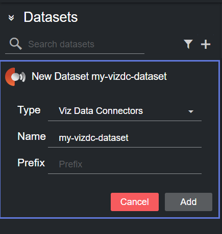

  1. Create a new dataset of type Viz Data Connectors, specifying a name and (optionally) a prefix to use to identify the dataset and its values:

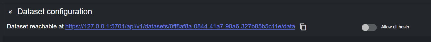

  2. Click Add. The following link is displayed in the Dataset configuration panel:
    This link can be used in the Flowics web-ui, to configure the Middleware to forward data to Datacenter. The basic setup assumes that both Datacenter and the Flowics Middleware run on the same machine. When this is the case, no further steps are required to setup a Flowics dataset, and any data configured to be forwarded by the Middleware, should also appear in the Dataset Entries panel. However, for setups where Datacenter runs on a different machine than the Flowics Middleware, the following additional steps have to be performed:
  3. In Datacenter's Dataset configuration panel, enable the Allow all hosts toggle.
    1. Substitute the localhost/127.0.0.1 part of the address shown in the Dataset configuration panel with the machine public IP, and use this new address to configure the Middleware to forward data to Datacenter.

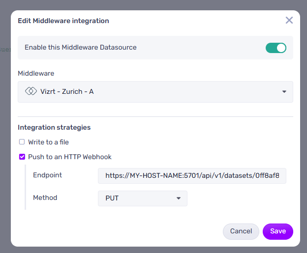

  • Once logged in, navigate to Data Connectors > Data Middleware Sources and select the source from the list where relaying to Datacenter needs to be enabled.
  • On the Data Source page, locate the Middleware Integration section and click on the Edit button. In the dialog that opens, make sure to enable Push to an HTTP Webhook and in the Endpoint input the Datacenter dataset link shown in the Dataset configuration panel.
Info: If the Middleware runs on a separate machine than the one running Datacenter, substitute the localhost/127.0.0.1 part of the address in the Dataset configuration panel, with the machine public IP.
  • Click Save. The configuration should be downloaded to the Middleware, and shortly after the dataflow should start towards Datacenter.

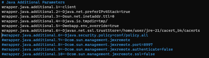

  • If a copy of the JVM trust store has been used (for example, in /home/user/jre-21/cacert_bk/cacerts), Middleware needs to be made aware of its location. This can be done by adding a line pointing to the modified trust store in the config file /home/user/dev/middleware-cli /conf/middleware.conf. To do so, open this config file and replace the line starting with wrapper.java.additional.6 with the following line:
    wrapper.java.additional.6=-Djavax.net.ssl.trustStore=/home/user/jre-21/cacert_bk/cacerts
