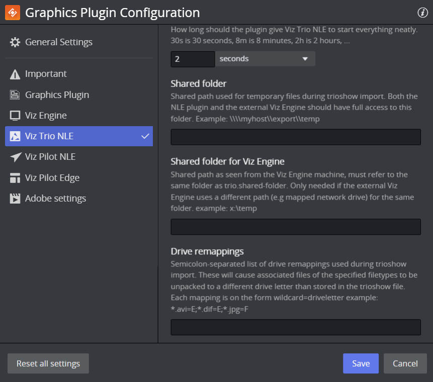

Viz Trio NLE
Host: Sets the hostname or IP address of the Viz Trio renderer.
Executable: Name of the editor's executable file. Can be changed if a different filename is in use. Default value is trionle.exe.
Options: The exact command line options string passed to the editor’s process at startup. For more information on command line options, see the Startup Variables section.
Network timeout: Controls how long connections to Graphics Plugin Editor wait for replies. This should not be changed unless network data for the Graphics Plugin Editor has been measured. Default value is 90s.
Shared folder: Shared path used for temporary files during import of Viz Trio shows. Both the Graphics Plugin and the external Viz Engine should have full access to this folder.
Shared folder for Viz Engine: Shared path as seen from the Viz Engine machine, must refer to the previous setting. Only required if the external Viz Engine uses a different path (such as a mapped network drive) for the same folder.
Drive remappings: Semicolon-separated list of drive remappings used during import of Viz Trio shows. These will cause associated files of the specified file types to be unpacked to a different drive letter rather than stored in the *.trioshow file. Each mapping is in the form wildcard=driveletter.
