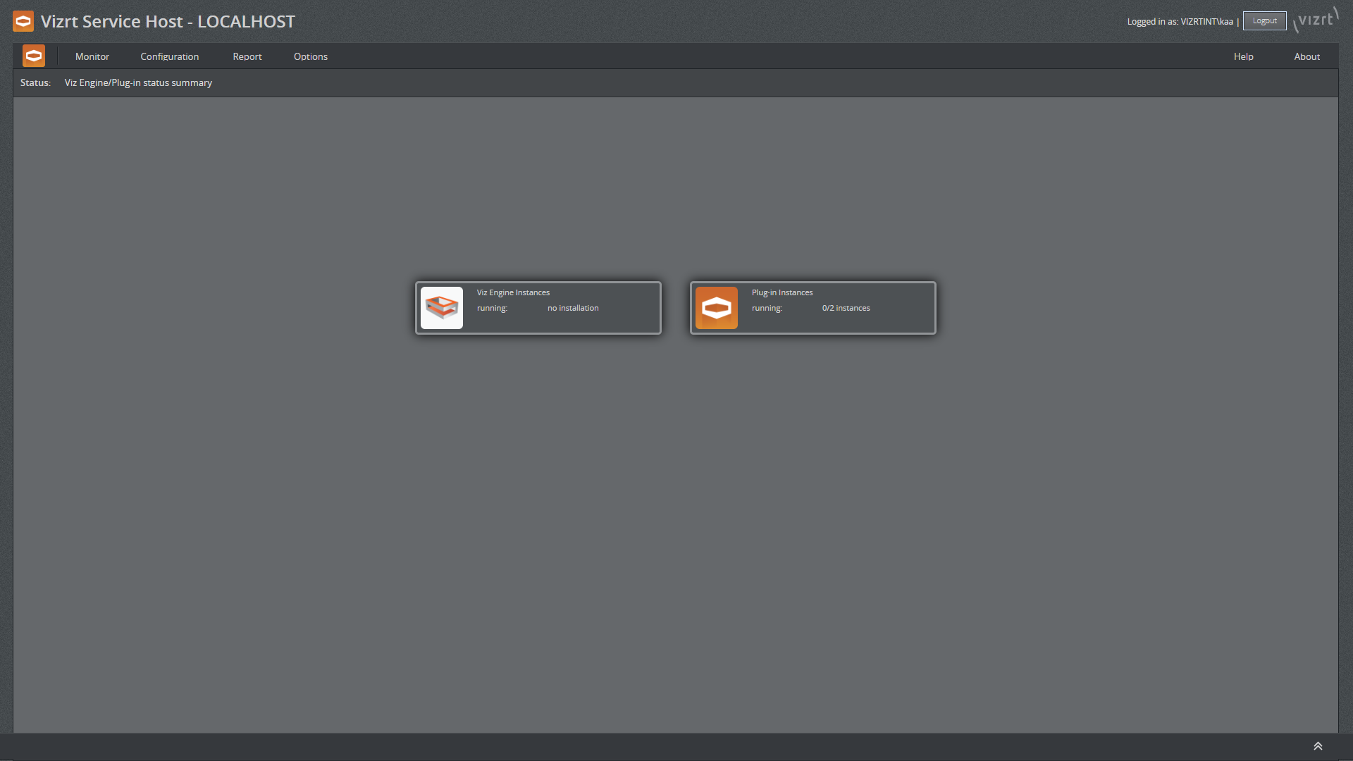

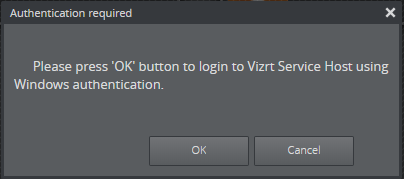

On the welcome page, the first thing to do is to log in. The login name is used to log all interactions with the Control Mode. The login name can be viewed on the upper right of the GUI, next to the Login/Logout button.

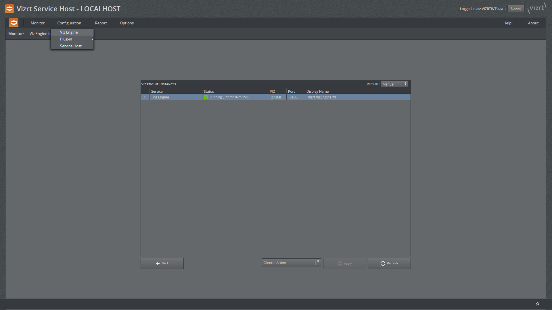

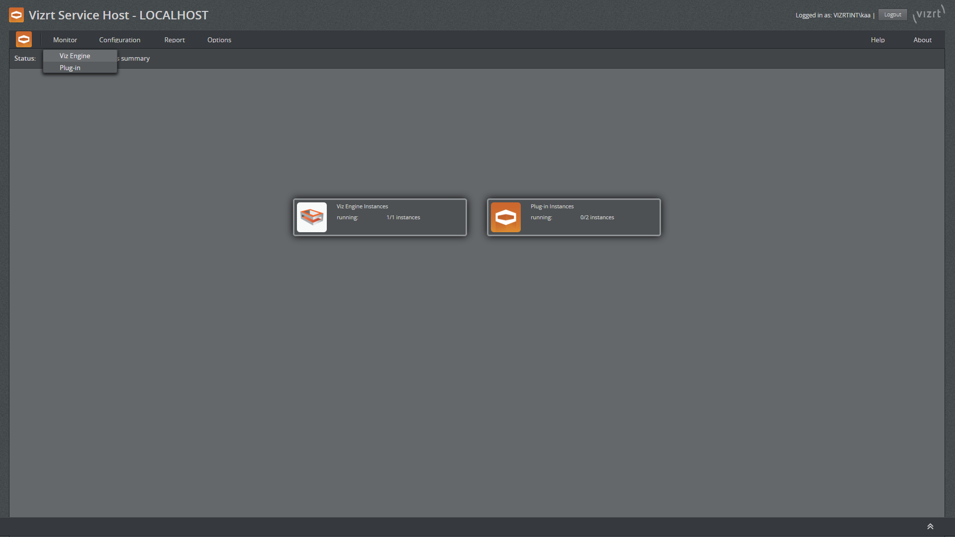

The Control Mode is aware of Viz Engine instances on the local machine. They can be controlled from here.
Follow the menu Monitor > Viz Engine.
And go to this screen.

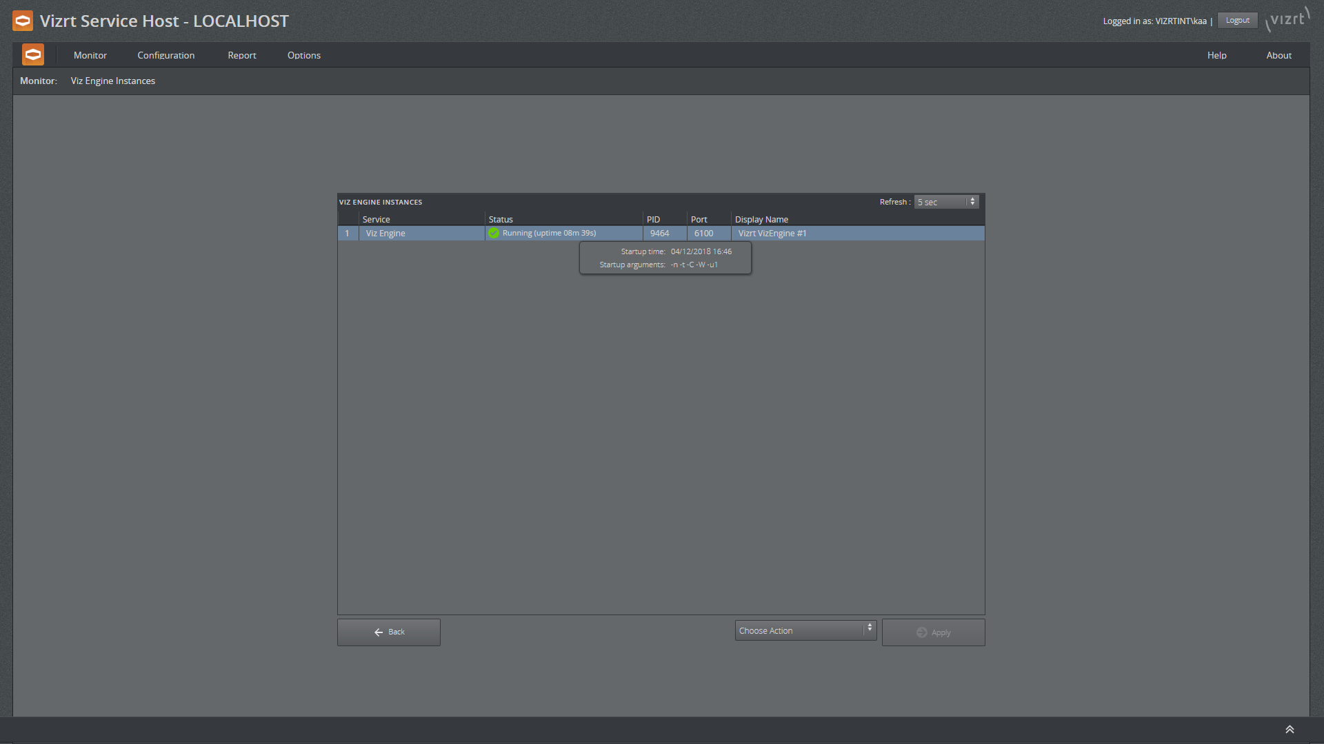

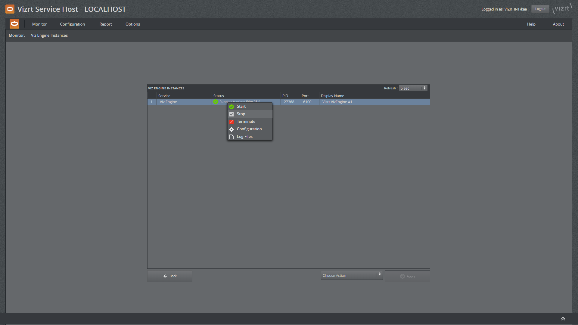

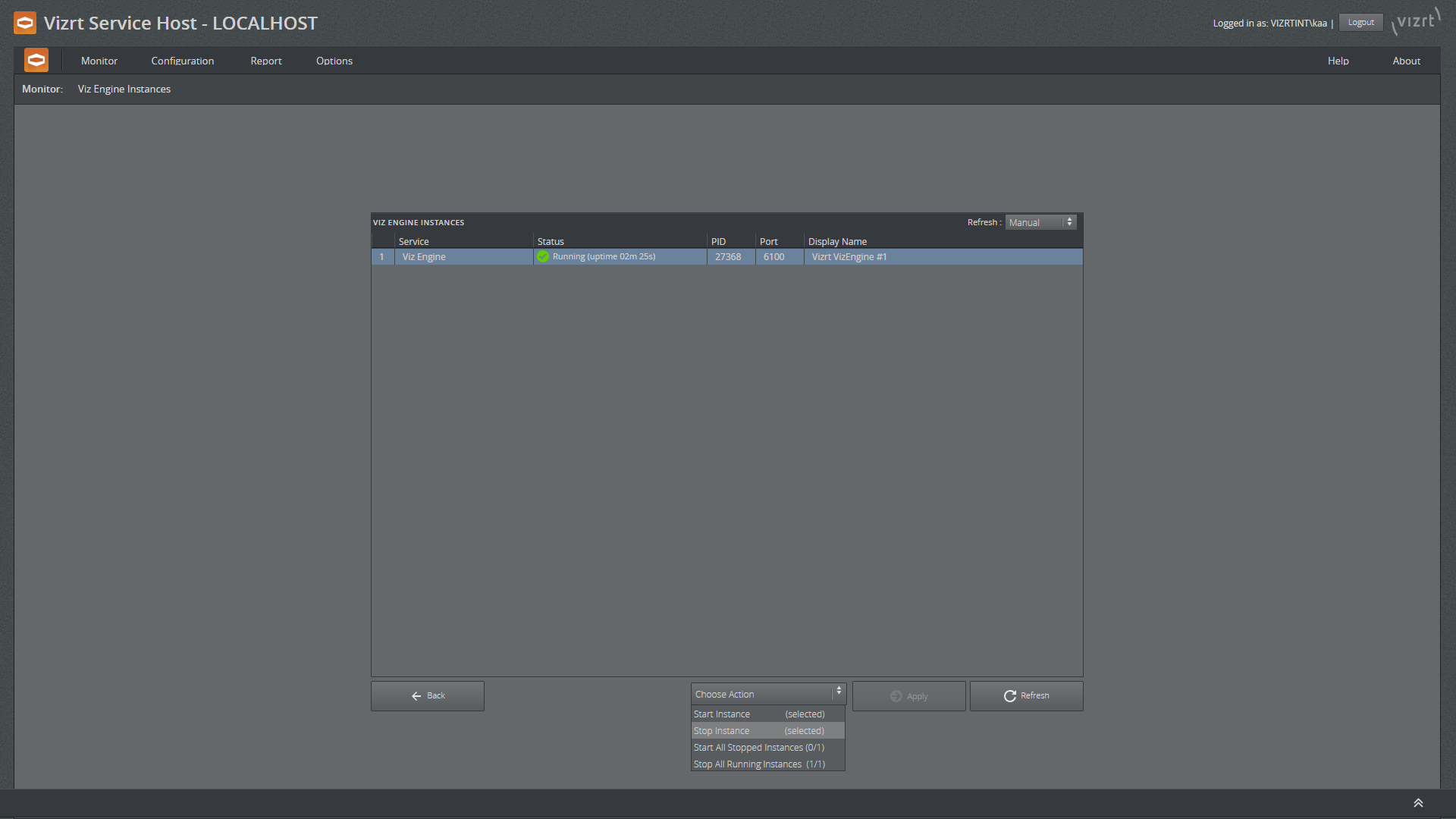

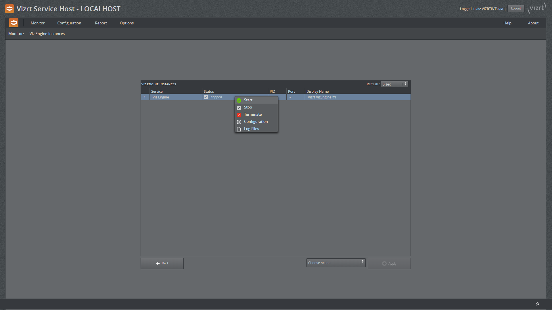

Start a Viz Engine Instance

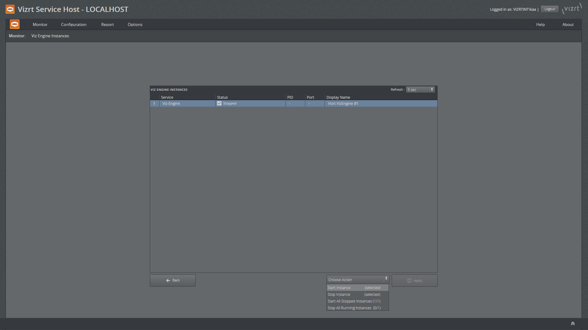

From the Viz Engine Instances Monitor page, the context menu on an individual Viz Engine instance or use the action bar on the bottom of the screen can be used to start Viz Engine instances.
The page is automatically refreshed every five seconds by default.
Preconditions
Viz Engine needs to be installed at the default location.
Postconditions
Start: A Viz Engine was launched without GUI and without a console.
Start: The launch may have failed. Please check the reason in the logs. Context menu Logs or Menu Report > Logs > Viz Engine.
Stop a Viz Engine Instance
From the Viz Engine Instances Monitor page, the context menu on an individual Viz Engine instance or use the action bar on the bottom of the screen can be used to stop Viz Engine instances.
Preconditions
The General Communication Port of each Viz Engine instance needs to be configured properly. Otherwise, the control instance is not able to stop the specified Viz Engine instance correctly.
Postconditions
Stop: The Viz Engine instance was sent the
EXITcommand.
The shutdown of a Viz Engine may take some time. To kill the process, with all consequences, select Terminate from the context menu.

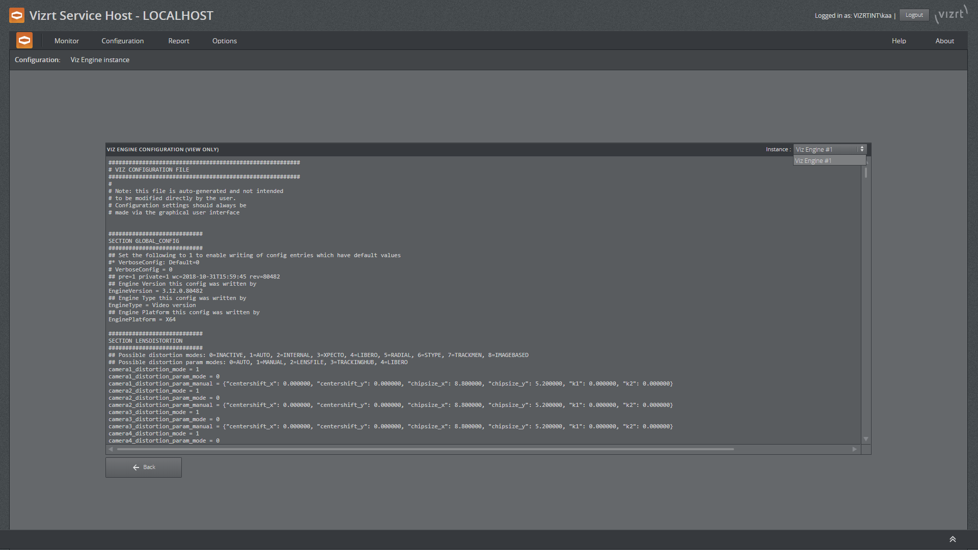

View Viz Engine Configuration
The config file of a Viz Engine instance can be viewed either from the Context menu on the Monitor page or via menu Configuration > Viz Engine.
From there, select the Viz Engine instance.
The page is view only.

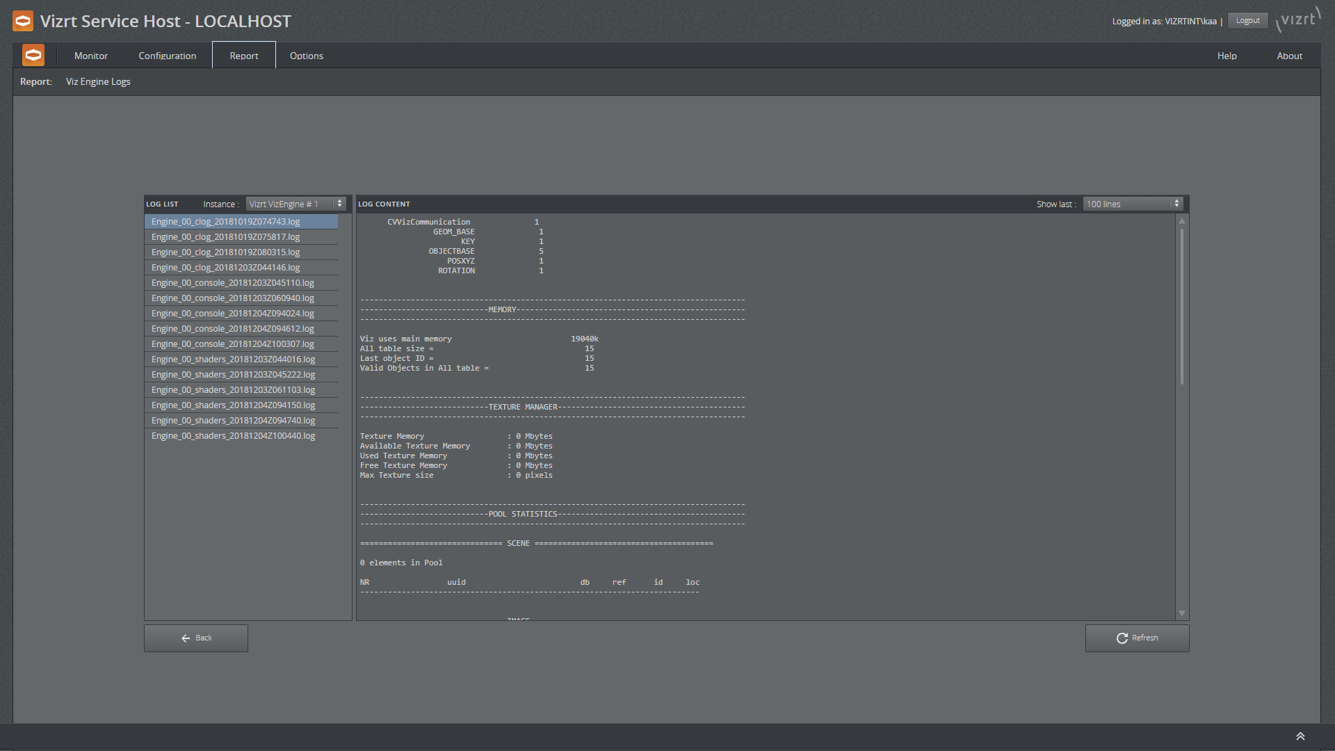

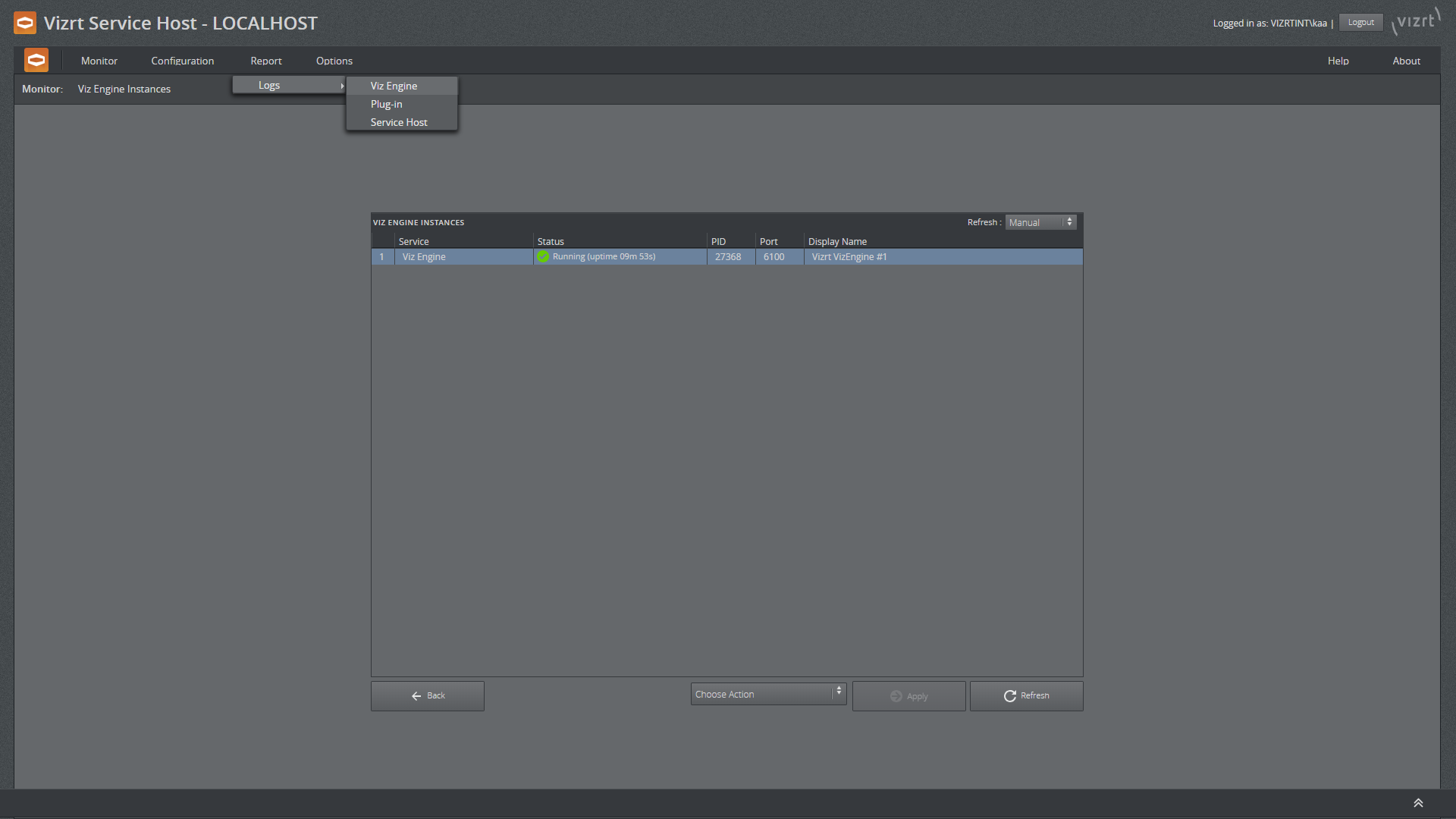

View Viz Engine Logs
The log file of a Viz Engine instance can be viewed either from the Context menu on the Monitor page or via menu Report > Logs > Viz Engine.
From there, select the Viz Engine instance to filter the available log files and how many lines to display.

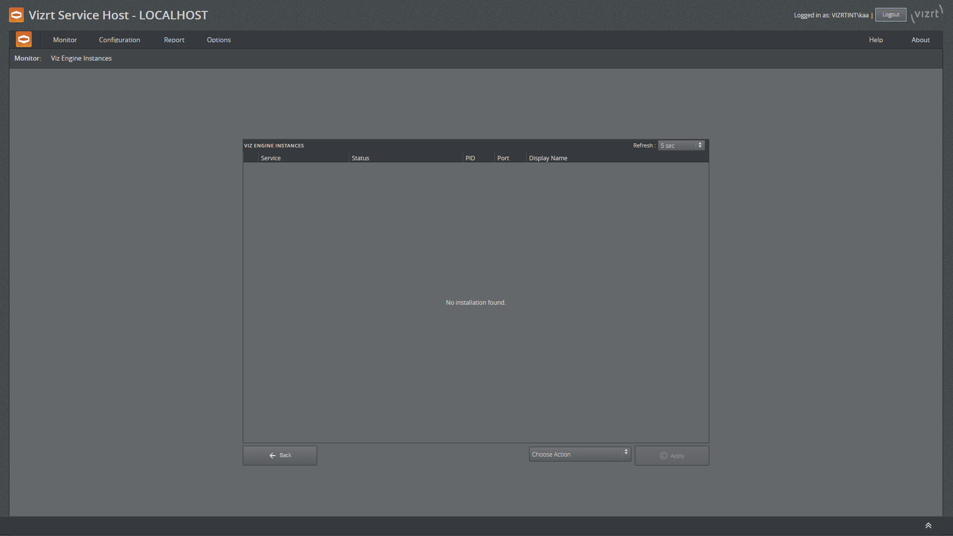

Viz Engine is not Installed
If Viz Engine is not installed on the machine, Service Host shows no installation at the status page.
No instances are shown in the Monitor Viz Engine page.

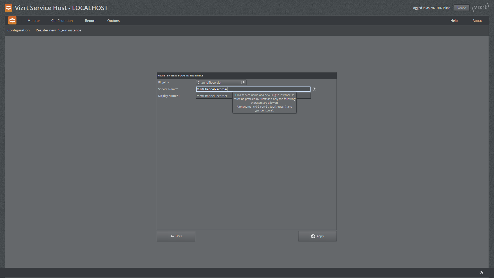

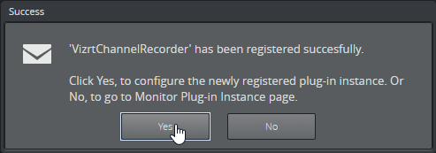

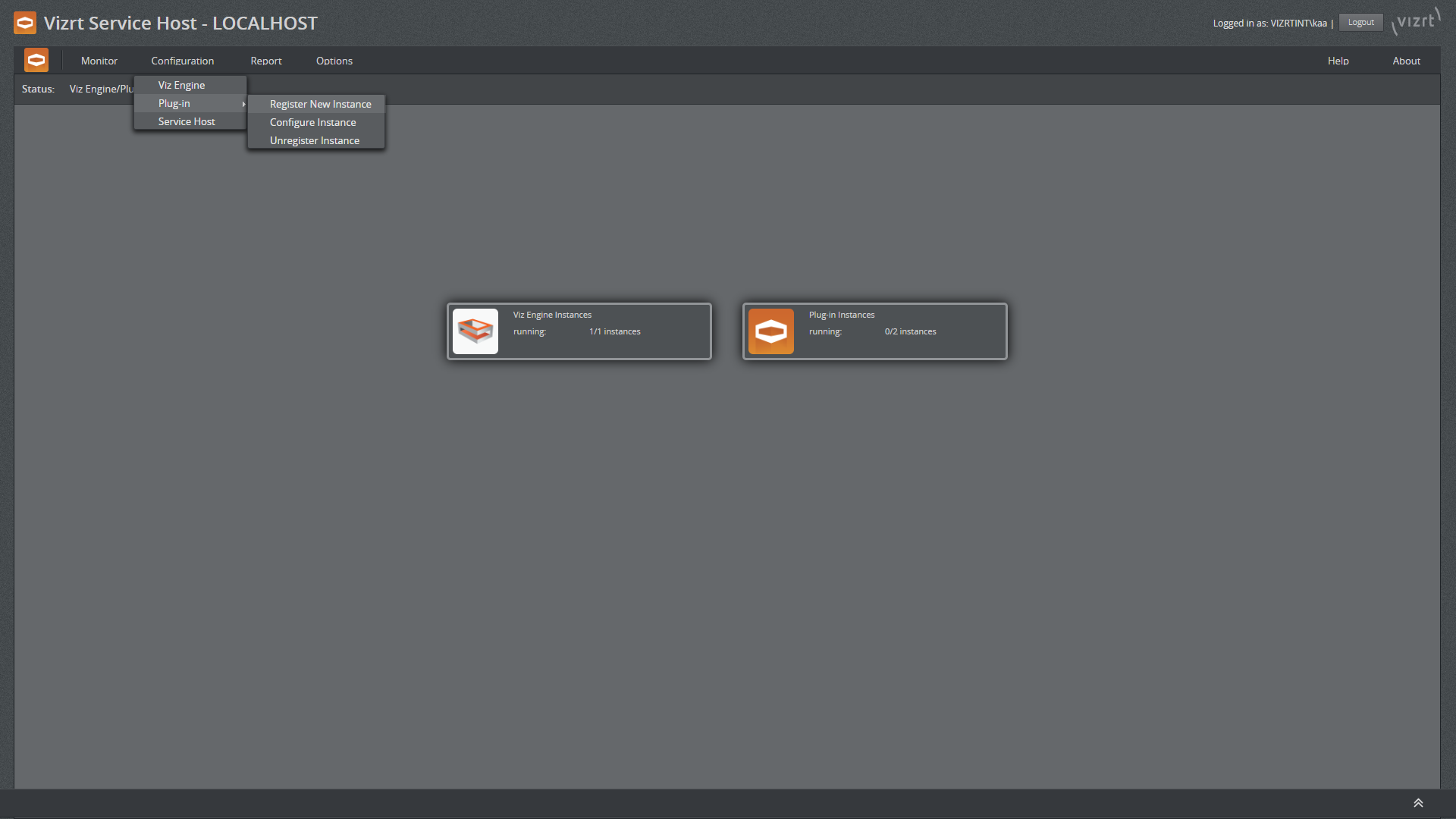

Register a Plug-in Instance
To register a new instance of a plug-in as a Windows Service, use the menu Configuration > Plug-in > Register New Instance.
On the following screen, select the plug-in type and give the instance a service and display name (for example, register a Channel Recorder):
Confirm by clicking Yes. The dialog moves directly to the configuration of this plug-in instance.

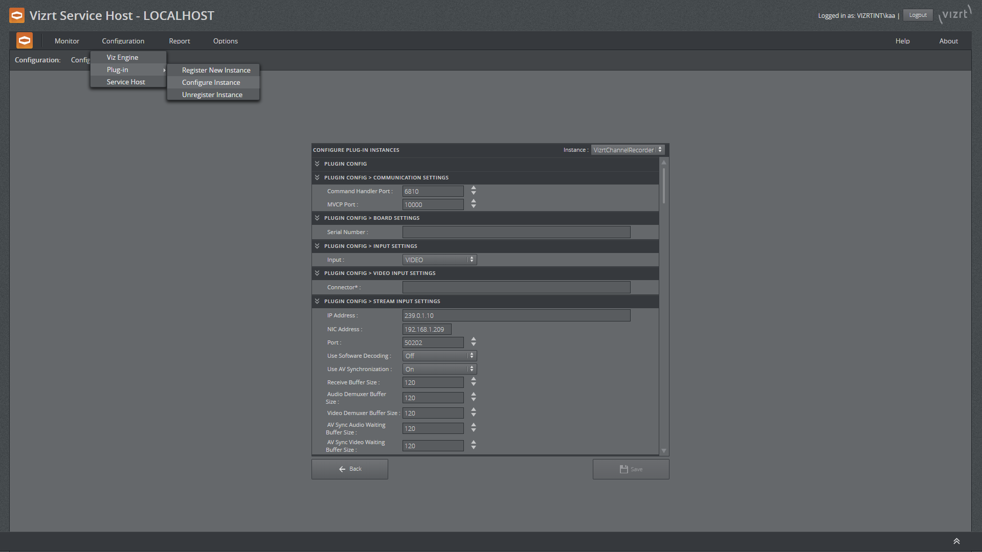

Configure a Plug-in Instance
The configuration of a plug-in instance can be reached from the Monitor plug-in page via the context menu of a plug-in instance or via the menu Configuration > Plug-in > Configure Instance.

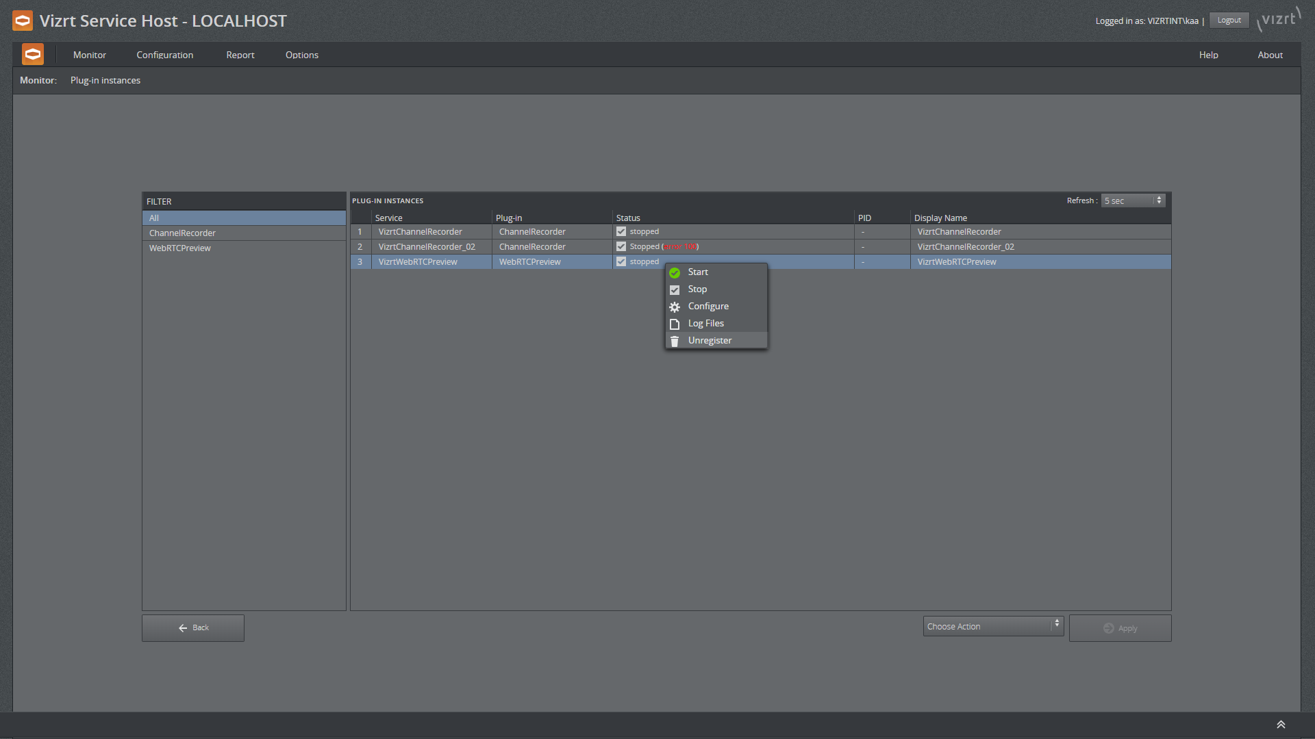

Plug-in Monitor

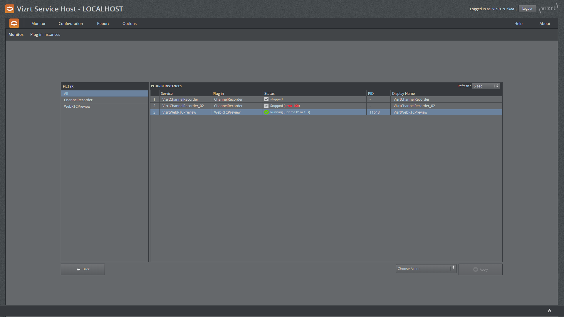

The plug-in monitor page can be reached via the menu Monitor > Plug-in or from the welcome page by clicking on the Plug-in instances icon.
On this page, there is a filter on the left-hand side to select the available plug-in instances. Each discrete entry on the right-hand side has a context menu that allows the plug-in instance to be unregistered.

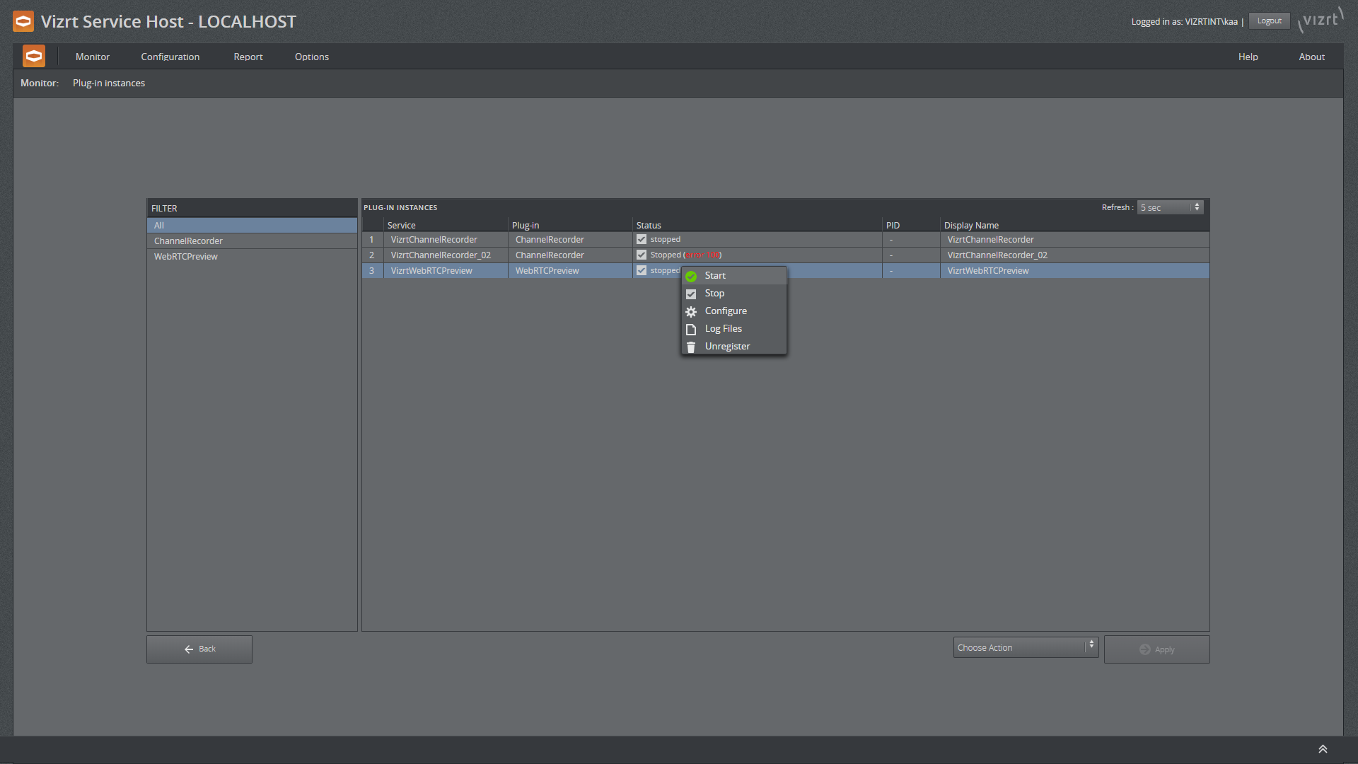

Start/Stop a Plug-in Instance
The context menu provides the capability to start/stop a plug-in instance.

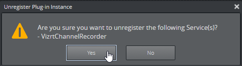

Unregister a Plug-in Instance
The context menu provides the capability to unregister a plug-in instance. Once selected and the following dialog has been answered with Yes, then the plug-in instance is stopped if it was running and unregistered from Windows services.
Any log and configuration files remain in %ProgramData% for later use by a subsequent new registration.

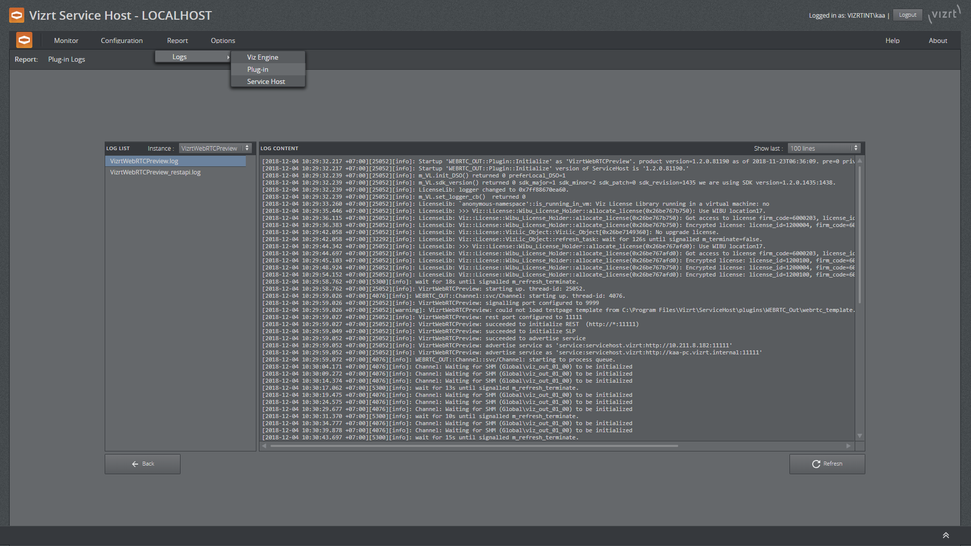

Report/Logs
The logs can be reached either via the context menu on the plug-in monitor page or from the menu Report > Logs > Plug-in.
On the left-hand side, there is the instance filter and the content of the selected log file is displayed on the right-hand side of the screen. The number of lines displayed can be selected. It operates like the tail command.

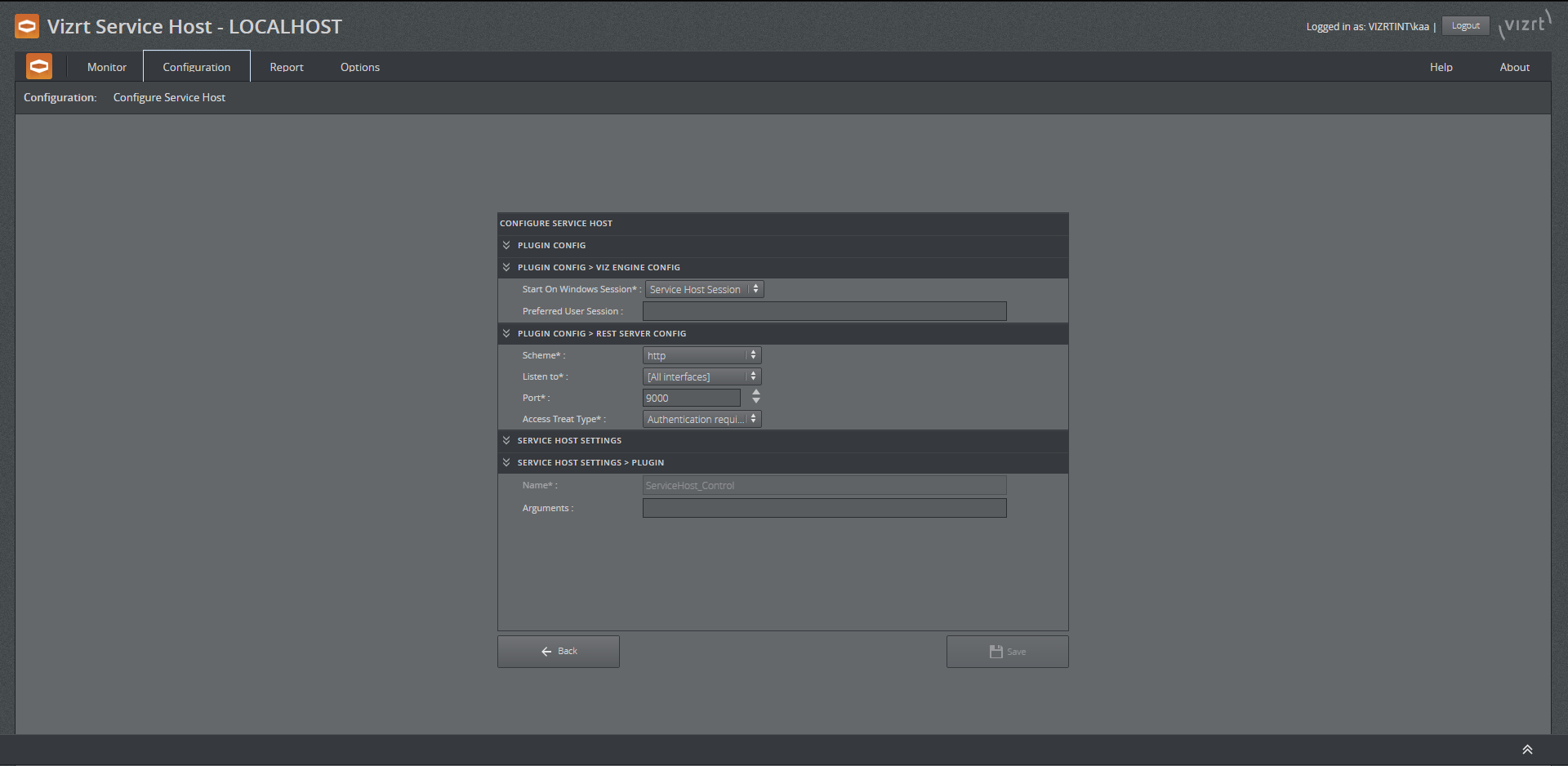

The Control Mode can be configured too. For security reasons, the configuration of the Control Mode needs to be configured by administrators.
Configuration

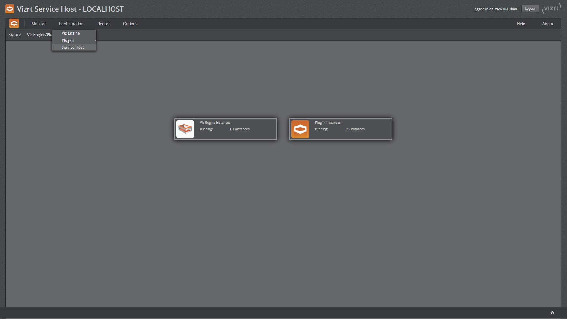

The configuration page for the Control Mode may be reached via the menu Configuration > Service Host.
On this page, there are two main sections that can be configured.
Plug-in Configuration
VIZ ENGINE CONFIG
It is possible to configure a Windows Session on which Viz Engine runs. Service Host(Control Mode) runs as a Windows Service running Session 0, thus a Viz Engine process started by Service Host(Control Mode) runs on Session 0 too. On some environment, Session 0 Isolation problem can be found and it causes Viz Engine to not able able to access a GPU and terminates. A feasible work around for this might be upgrading NVIDIA Display driver to Standard type or to configure Service Host(Control Mode) to start Viz Engine on a User Session instead.
To configure Service Host(Control Mode) to start Viz Engine on what Windows Session, set Start On Windows Session field to one of the following values:
Service Host Session (SERVICEHOST_SESSION): To start Viz Engine on the same Windows Session as Service Host(Control Mode) , this is the default setting.
User Session (USER_SESSION): To start Viz Engine on the same Windows Session as an interactively logged-on user.
Note: If there is no interactively logged-on user, Service Host (Control Mode) is not able to start Viz Engine.
If multiple users interactively log on at the same time, it is possible to configure a preferred username at Preferred User Session field.
REST SERVER CONFIG
The REST listening address can be configured. By default, Service Host is listening to all interfaces. This is specified by [All interfaces] in the field. For a port number, any valid and unused port number may be used. Later versions may support automatically finding of an available port number.
The Access Treat Type controls who is able to interact with Service Host.
Only local access (LOCAL_ONLY): To allow only users accessing the GUI via the local machine to change the system (such register/unregister new plug-in instance or start/stop Viz Engine instances). Users accessing the GUI from external machine, regardless of whether authenticated, are not allowed to make any changes.
Authentication required (AUTHENTICATION_REQUIRED): Same as above, only local access; except that users accessing externally are allowed as long as they are authenticated. In future versions, this may change to all users are required to authenticate before they can make changes to the system.
No authentication (NO_AUTHENTICATION): No restrictions apply. All users may change the system, both locally and externally. We do no recommend this setting since there is no way of gathering user information in the operating logs.

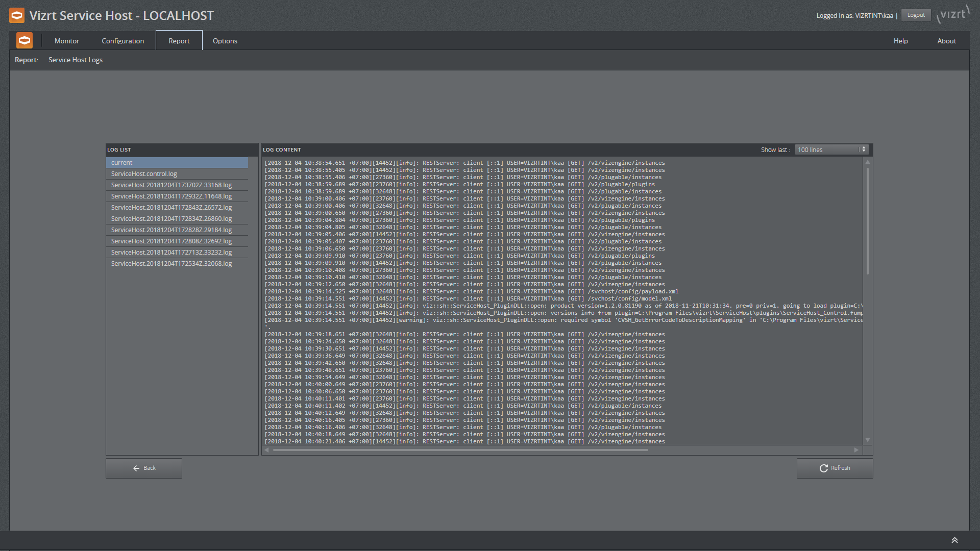

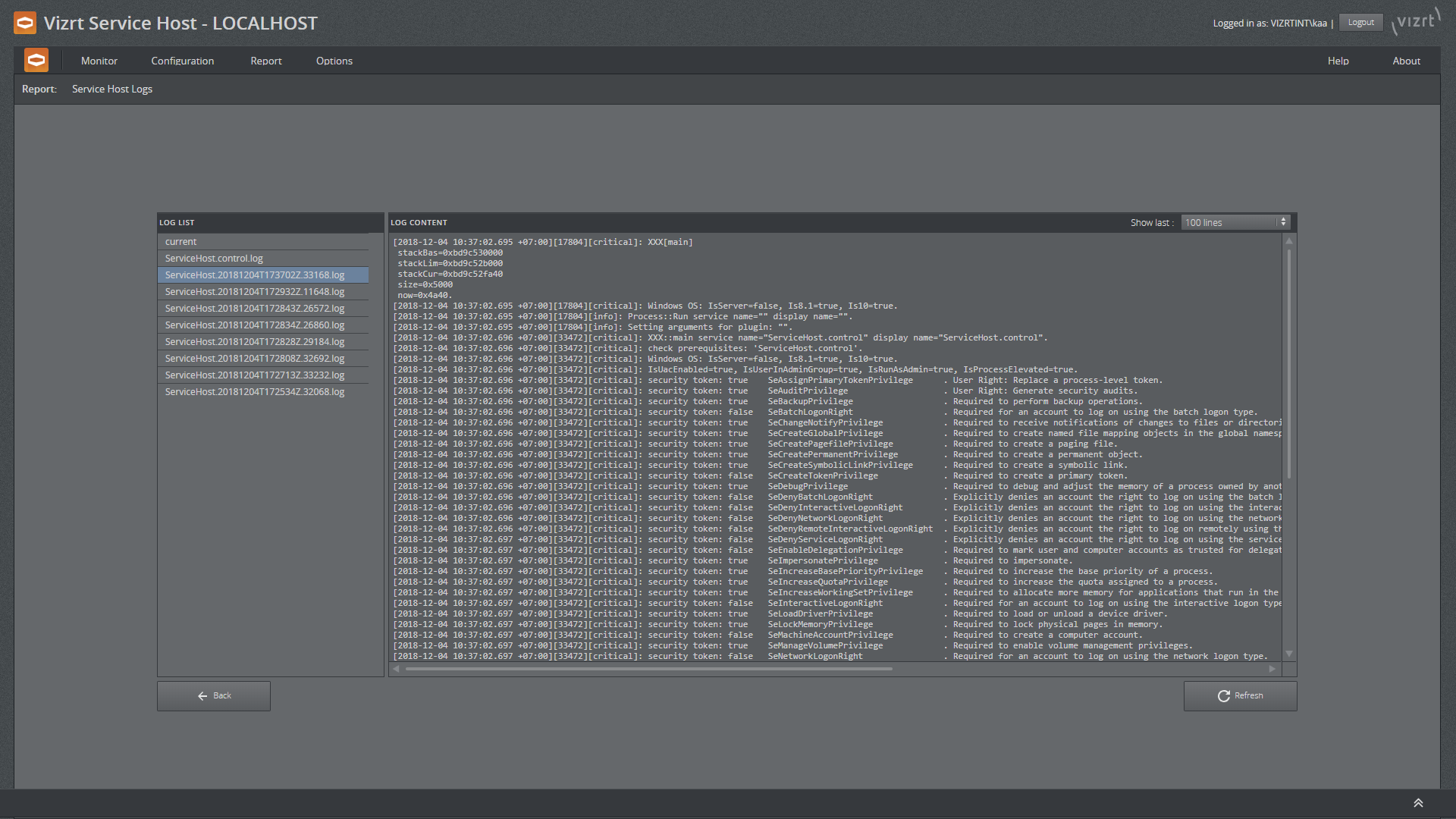

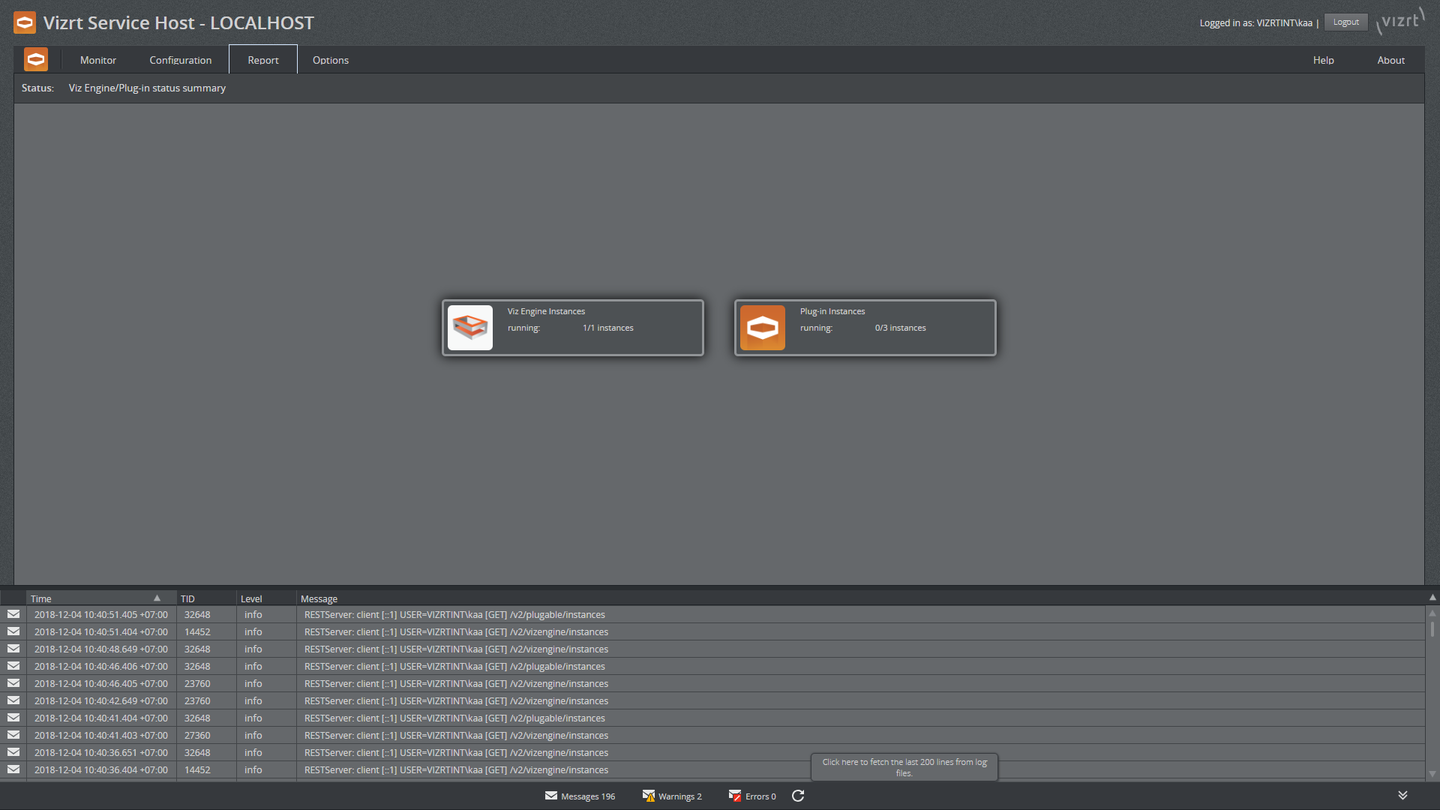

Report/Logs
The logs produced by the control mode may be accessed via the menu Report > Logs > Service Host.
On the left-hand side, select the log file to be displayed. There are two types of logs available.
The Control Mode Log
This log file is named ServiceHost.control.log, it does log rotation and may also be reached via the log panel on the bottom of the screen.
and
Service Host Startup Logs
Logs are produced during startup and kept as long as this Service Host is running, so possible startup issues can be captured before a plug-in is loaded and initialized. These log files are removed after a successful shutdown. They are named ServiceHost.dateandtime.pid.log, where dateandtime is the date and time the selected timezone, pid is the process ID.
