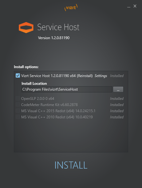

The Service Host installer comes in two flavors:
ServiceHostBundle-x64*.exe
ServiceHost-x64*.msi
The main difference is that the bundle installer takes care of upgrading an existing installation and installs the required operating system run-times (if not already present), whereas the .msi installer only installs Service Host.
Installation
The bundle installer itself is using the .msi installer. The .msi and other files can be extracted from the bundle. This is mostly used for silent and unattended installs. Please run the bundle with -h command line switch to get all the available options.
Command Line Options for Bundle Installer
Z:\my_path> ServiceHostBundle-x64-1.0.0.68324 -hZ:\my_path>Running with no parameters will install the product -s, --silent Runs the installer with no user interaction --msi Extracts all .msi files to a subdirectory --dump Extracts all files to a subdirectory --dumpTo=VALUE Extracts all files to the specified path -h, -?, --help Prints this helpmsi Installer

Service Host is installed at the indicated location. the default value is %ProgramFiles%/vizrt/ServiceHost.
Configuration and log files are located at %ProgramData%/vizrt/ServiceHost.
If the configuration of the Control Mode does not exist, then a default one will be created at %ProgramData%/vizrt/ServiceHost/ServiceHost.control.xml.
The Control Mode is registered as Windows Service and started.
A shortcut, ServiceHost.control, is created in %ProgramData%/vizrt/ServiceHost to point to the web GUI of the Control Mode. Use this shortcut to verify the installation.

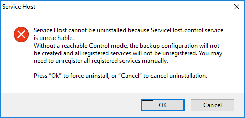

The Control Mode has to be running. otherwise the uninstall silently fails.

If the Control Mode is unreachable during uninstallation, it is still possible to uninstall. The dialog informs users that the Control Mode is unreachable and prompt users to decide to force uninstall, or cancel. If users force uninstall, users have to manually unregister all Service Host services registered as Windows services.
